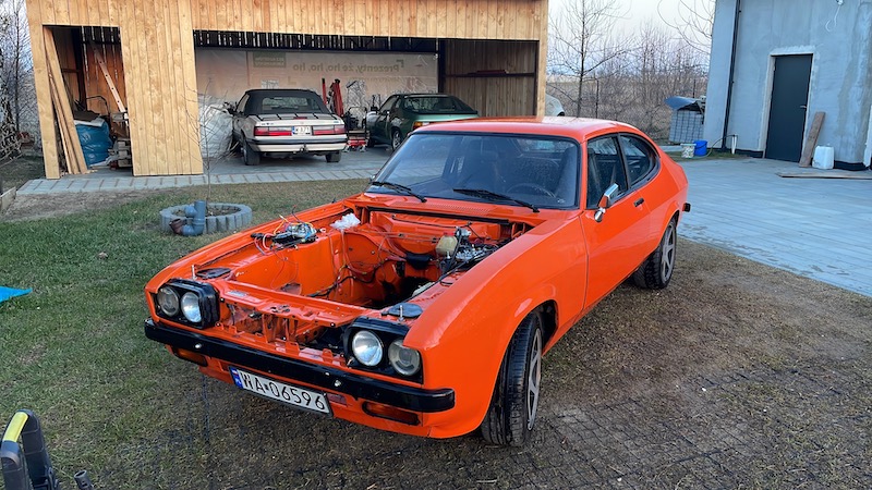

13. I removed the engine from the car (last weekend).
14. I will build a decent, turbocharged 4.0L - that's the plan xD

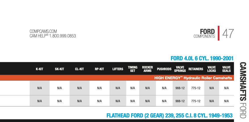

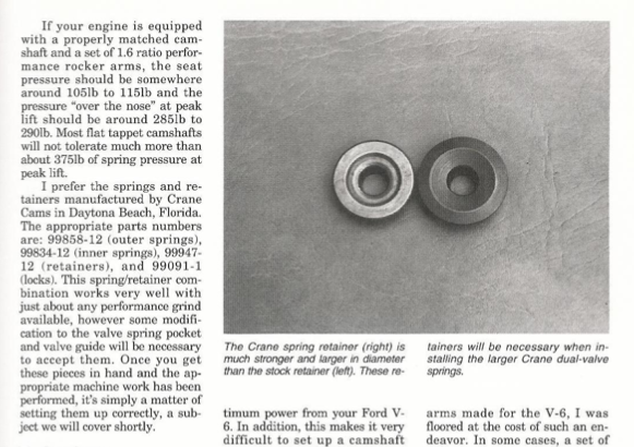

So as per the book about building performance 60 deg V6 I'm going to replace the valve springs.
Crane Cams I think was taken over by comp cams?
The book lists (Crane Cams):
99858 inner springs (there is mistake in the book claiming it's outer)
99834 outer spring (there is mistake in the book claiming it's inner)
I found 99858 on eBay - set of 16 with one broken for $14.99 + shipping :D

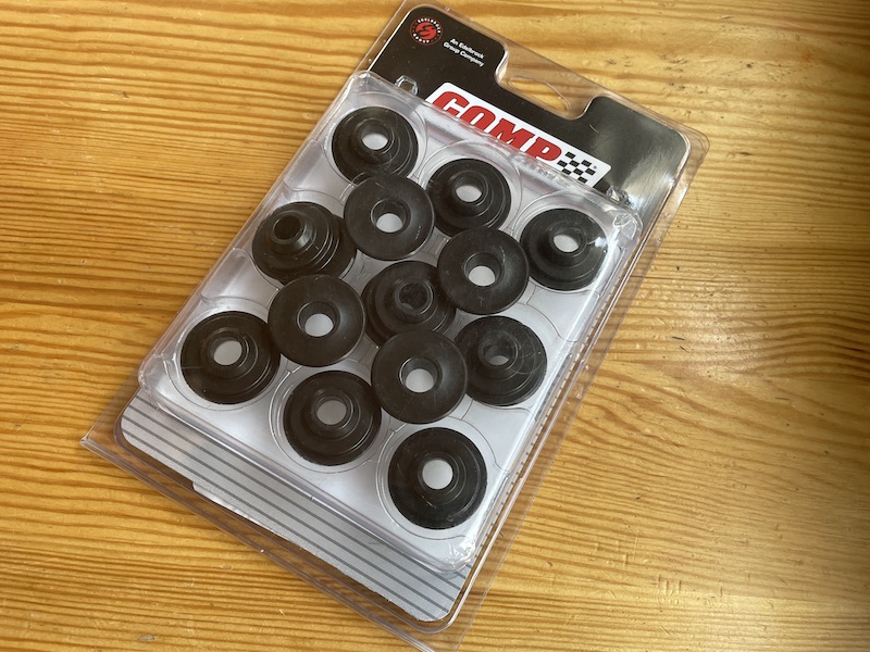

I found also Comp Cams retainers that seems to fit my application on Amazon 775-16 for $33 + shipping (arrived today)
I cannot find the 99834 outer springs nor their specs though....
Anyone has Crane Cams catalog (maybe printed one?) that lists specs of these springs, so I can figure out the 99834 replacement?
Or maybe someone has 99843 springs for sale???

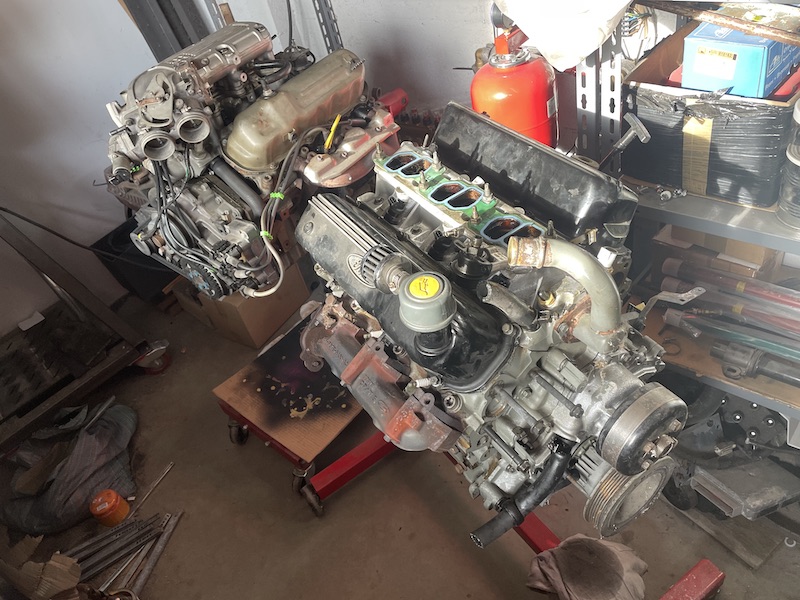

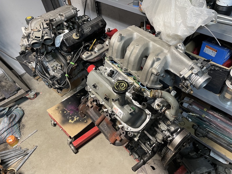

So I have both engines on the stands now.
The 4.0L airbox/intake looks massive compared to the European 2.9L.
The nice black aluminium rocker covers come from European Ford/Mercury Scorpio(Ford Granada in UK).

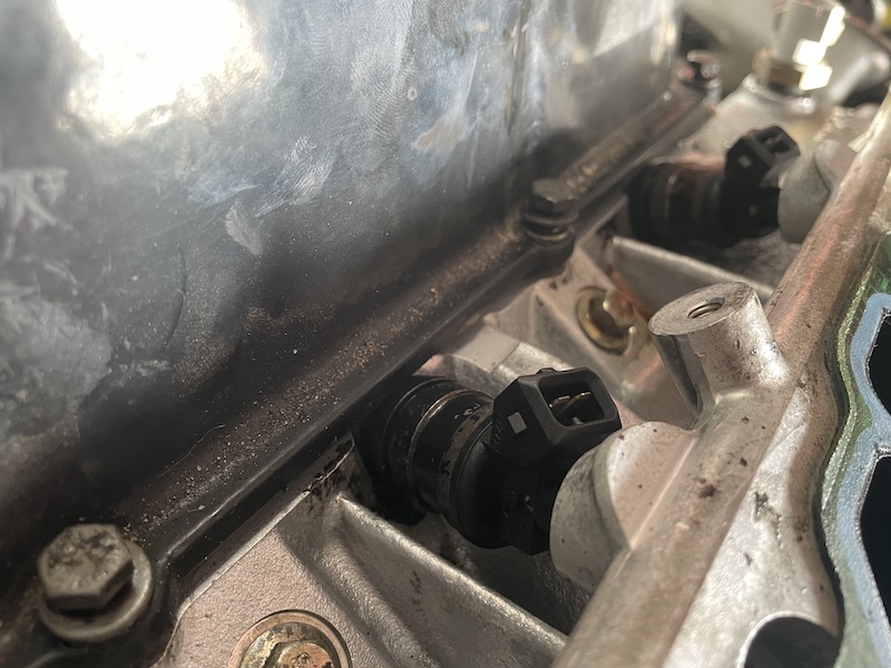

These bolt straight onto any of the V6 family (2.0L-4.0L), but for the 4.0L I see that the stock rocker covers have bends around the injectors and to fit there a small amount of edge of the aluminium rocker covers must be ground off.
For me I think this will not be needed, as I will replace the injectors with newer type ones that are thinner in that area.
IMPORTANT: The surfaces do not mate 100% with 4.0L heads (due to those bends), but there is coverage, so the surfaces should be ok to seal. On the other hand, these usually leak on the bottom part anyway :-)
I did some investigation regarding flywheel and clutch. It seems there is 10.125" diameter clutch that was fitted in the 1997-2000ish models (AMS 07-139 available at rockauto.com for $170) that bolts on to any of the manual 4.0L.
The earlier clutch has ~9.5" diameter and the spring tension is slightly lower, so the newer crank with 8 bolts for flywheel and newer clutch seems to be a perfect match to an upgraded power engine.
I did compare the tech data about the 8-bolt flywheels, and these are same as the earlier ones with 6 bolts with the respect to the numbers of bolts :) (296mm outside diameter of the toothed ring and 138 teeth).
So when my crank arrives I will shop for the flywheel and clutch as well.
I was hoping I could do it rather quickly, but it seems as usual I will do it the right way rather than quick.

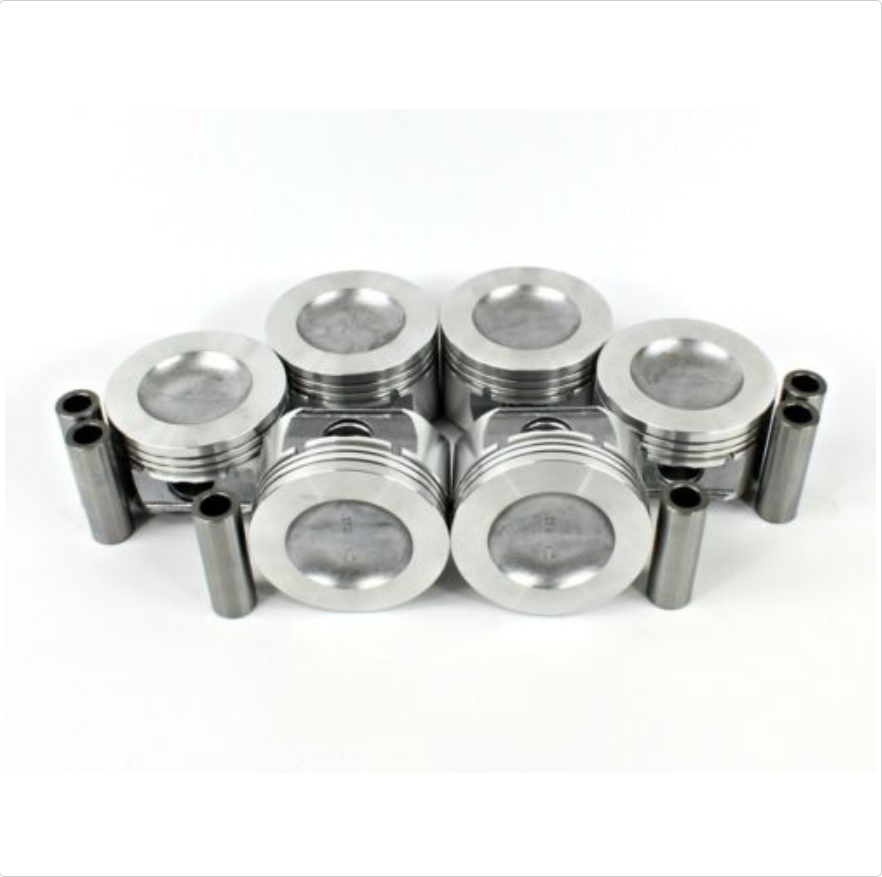

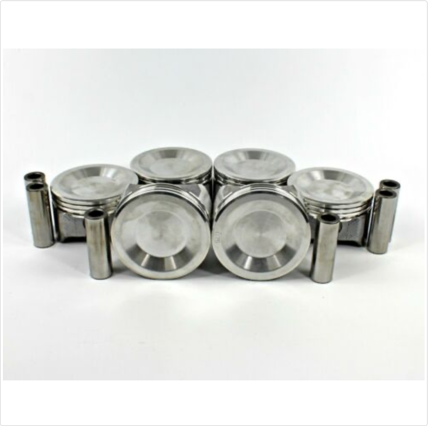

Which brings me to another topic to think about. Late heads had smaller combustion chamber, I have early heads. To compensate smaller combustion chamber Ford changed pistons to the ones with a bigger “bowl” (sorry guys I’m not native :D) to keep the CR same.
I’m just thinking about finding a set of late pistons to lower the CR, which should be good for the turbocharged application…

bowl is fine for what you said. i think the term used here is dish though so bowl works. but someone else probably has heard another term for it too

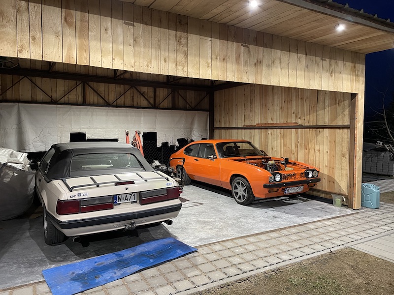

As everyone likes pictures...
These are early and late pistons - not that hard to spot the difference :-)
And the Capri going for a "sleep". I'll cover her in a cloth later. Just washed before covering.

@konrad911 ,
Since you are using 94 spec heads you can use either of the three 4.0l OHV pistons.
91-94 pistons, small dish.
95-97 pistons, bigger dish lower compression ratio.
98 spec pistons, same as 95-97 dish but 50g lighter each.
For a forced induction build I would useing forged pistons, unless I was committed to less than 7lbs of boost but if you are going to use a stock piston then here is why to consider the 98 spec Piston with 94 spec Heads.

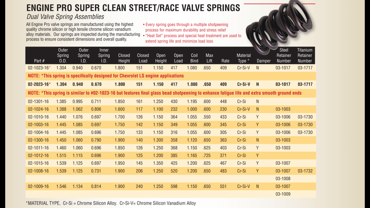

@konrad911 ,
The springs I'm using for the my 4.0l are "Engine Pro competition", Nitro Black Dual, Street/Race, part number:
02-1024-16
They were sourced by my machinist from the "Engine Performance Warehouse". Thinking back, it took him awhile to find these and I believe they are actually for an older Chevy V8; this complete V8 set was $75.

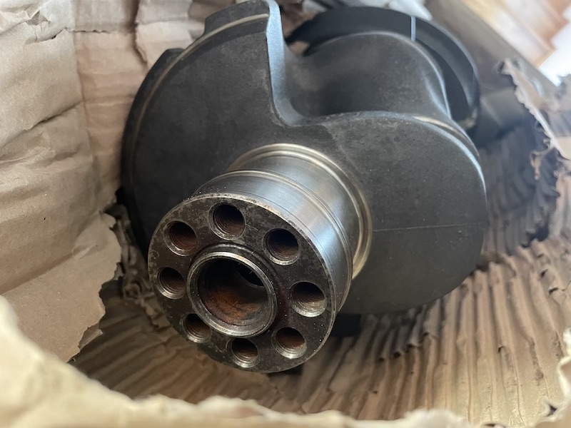

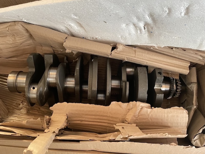

In the meantime crank arrived :D
So be it, 8 bolt flywheel to come :D
