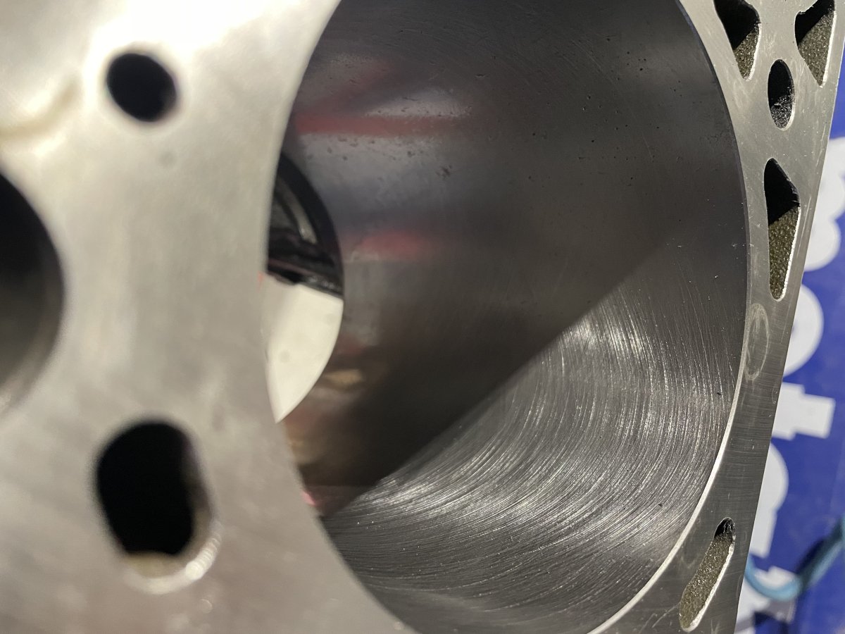

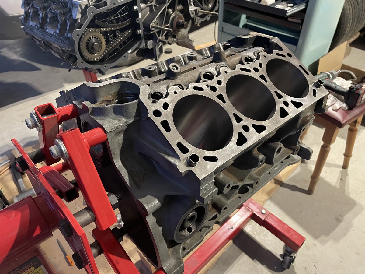

got my block from machine shop, started deburring it / grinding / sanding sharp and rough edges already.
I’m thinking to paint the block in a nice orange color rather than stock grey.
What do you think?
What do you think?
View attachment 79512View attachment 79513
Looks good.
As far as engine paint, orange always reminds me of Chevy. If you prefer the block be a brighter color, Ford Blue is always nice.
My rebuild last year I painted the block black, sandblasted & clearcoated the aluminum parts, and painted the valve covers Ford Blue. Unfortunately you can hardly see it under the big plastic truck intake on the 95+ Ranger setup.
What do you think?
Brother, orange is not for a Ford. Black or gray both look nice with aluminum or Ford blue valve covers. I tried silver but never again. Gray is great for finding the origin of a fluid.
