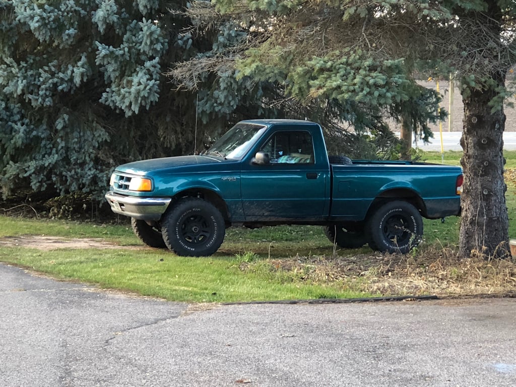

Finally got this thing back out into the woods.
Found out the hard way that I’m going to need to strap the front end with stock coils and a 24” shock. Long story short, deep ruts, too much speed and no sway bar. Came out the other side with a little lean. Outside of that it did great. Pretty sure one of the U-joints in the front end bit the dust coming through the same hole but that’s an easy fix.

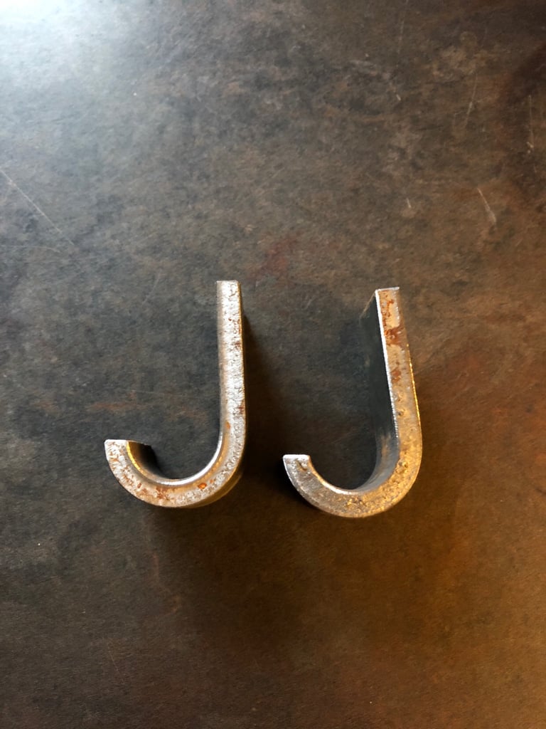

Made some coil spring retainers at work. 1/4” x 1” A36. Bent in a manual bender. 7/16 holes with 3/8 hardware for some adjustment. The passenger side needed to be twisted to get it as close to the “end” of the spring as possible. Drivers side remains straight. Pic shows both before one was twisted.

I only took a pic of the passenger side done. You can see the twist and the mounting location as far to the front of the coil bucket as possible. The drivers side is mounted in the center of the bucket pointing directly at the tire.

I did it this way to try to keep the springs equal length at full droop. I actually left a slight gap between the spring and the retainer on the passenger side to try to compensate for it being a little farther down the spring than the drivers side. The drivers side retainer is mounted tight to the coil.

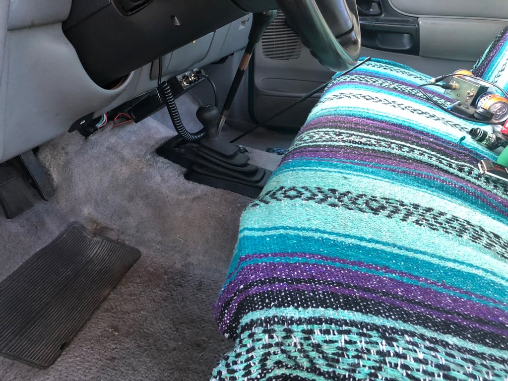

In unrelated news, my horn quit working which ended up being a corroded connection at the horn itself. Also found a couple unplugged vacuum lines under the dash. Resolved all of those issues just to have the drivers side window regulator bite the dust. New one on order from rock auto. I also ordered a shifter boot that I’m hoping will work with my Ranger/Dakota hybrid gear stick. It’s an omix-ada repop of a Jeep CJ transfer case shift boot.

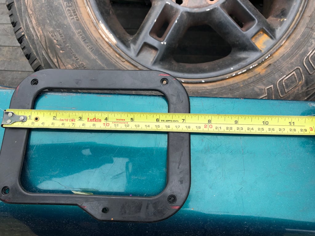

Do you want the measurement of the bottom bellow? It doesn’t quite fill the opening in the M5od cup holder shifter bezel. It does on the sides but it’s about a quarter inch short on the front and back.
Where it mounts. I have a bezel I want to use. I think it predates the M5OD era though.
These are the measurements off of the rubberized steel plate that is two sided taped to the bottom of the boot. It’s the same size as the actual bottom of the boot.
5-7/8 wide
‘94 4x4 Swap/Build
7-3/16 long
‘94 4x4 Swap/Build
The bottom bellow is 4x5.25

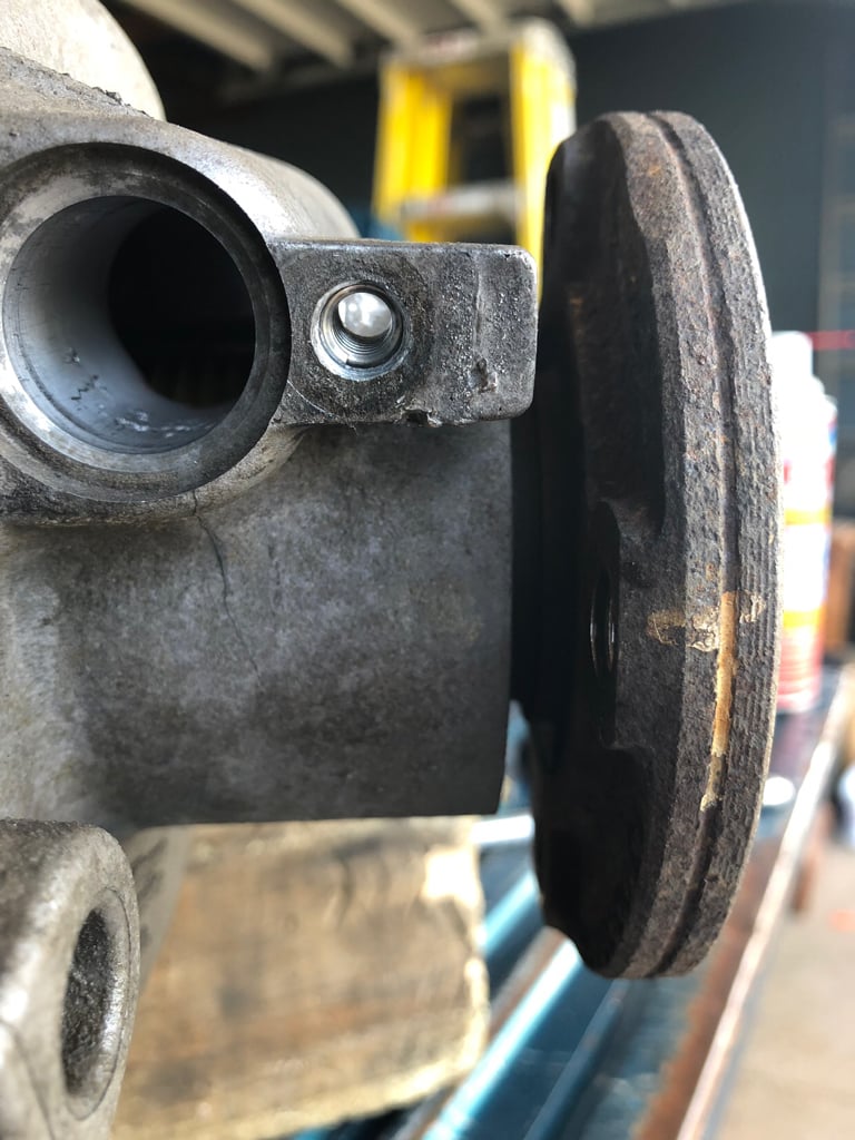

When I started stripping the case of the stuff I didn’t need, I ended up breaking the bolt for the speed sensor off in the case. Drilled it out to finish with a .25” hole and helicoiled it. Thread size was 1/4-20. Fortunately we had 1/4-20 helicoil inserts at work.

I originally wanted to pull the case apart to inspect the internals but after pressure washing and dropping the fluid that was in it, I decided against it. It was very clean. I did chase all of the trans adapter to t-case holes as well as both output yokes.

And I finally have working 4-Lo. Still need to switch my Jeep shifter boot over for the trans shifter.
‘94 4x4 Swap/Build
‘94 4x4 Swap/Build
All that’s left is to pull out the electric shift case wiring/buttons and wire up the dash lights. I backed up into the front side yard to run it through the ranges and make sure I had the shifter gate adjusted right. Everything is working perfectly. I’m a happy camper. I did however notice my rear pinion seal is leaking though so that’s on the to do list now.
since the beams are different lengths and travel in different arcs, the spring equalizing issue...is not an issue. i put guides in at one point before i went to bags to extend droop...
