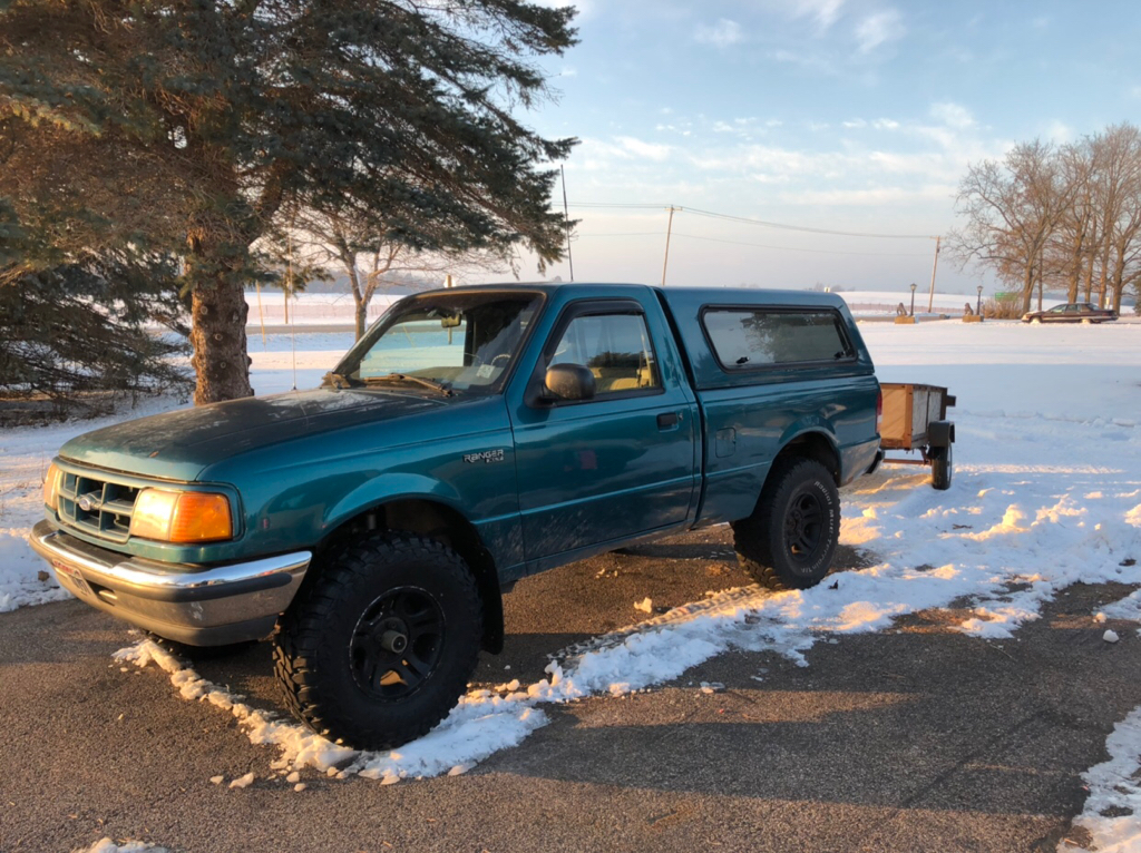

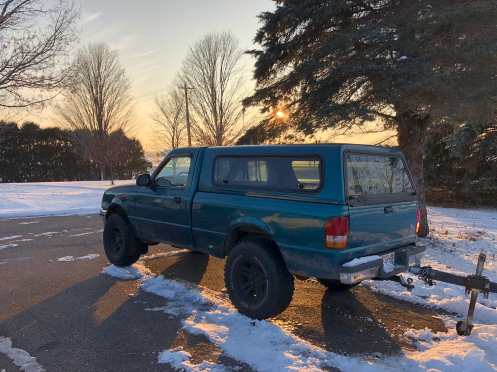

Picked up a “new” topper last weekend. Buddy called me on his way to pick up pizza for his family saying he had spotted one on the side of the road. A couple pics later and I had the trailer loaded up and headed out.
I had been wanting a fiberglass cap ever since I picked up the aluminum one. The light weight of the aluminum is nice but it was old and leaked like crazy.
Pics he sent;
I pretty much knew right away this one was for a Ranger just by the color. For whatever reason, it’s hard to find a topper this color in my area even though there are Cayman Green Rangers everywhere here.

Had to bend my CB antenna mount a little to make it fit but it fits like a glove.
‘94 4x4 Swap/Build
It has a windoor on one side and a slider on the other.
‘94 4x4 Swap/Build
I had to put new rear window struts and one ball mount in it. That’s it, everything else works besides the missing 3rd brake light.
