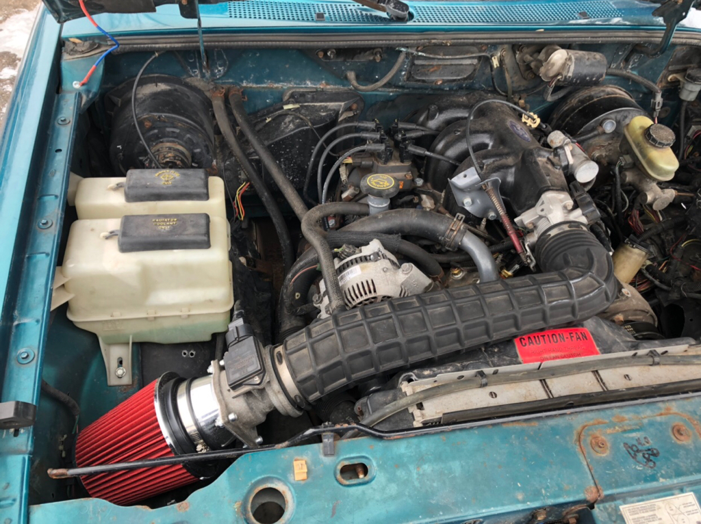

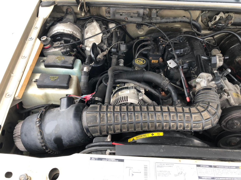

Not much of an update for the truck but a small one none the less. Made a run to the UP with my oldest daughter to pick up a new toy (more on that later) and on the way home the truck developed an unreasonably high, high idle. About 2,000 rpm. After scratching my head and Google’s, I figured the best place to start was the simplest. Finally making sure the truck was running all of the correct sensors. When I first built it, I had decided to run the air box and intake tube off of the ‘97 B4000 not realizing the MAF sensors were different diameters. The truck always started kind of funny and ran really rich. Being that my explorer runs the newer, larger MAF , I decided to put the B4000 intake parts on it and use its intake tube to get the correct 1993 MAF on my truck. VOILA!
I finally got it running 100% and no more check engine lights. Fuel mileage is up in the low 20’s thanks to the correct MAF.
‘94 4x4 Swap/Build
Don’t hate on the filter, it’s gone as soon as it warms up enough to make an adapter plate to bolt the MAF to a late 90’s OHV Explorer air box.
B4000 air “box” and intake tube on my Explorer. I need to order a six pin weatherpak connector for the MAF wiring harness yet.

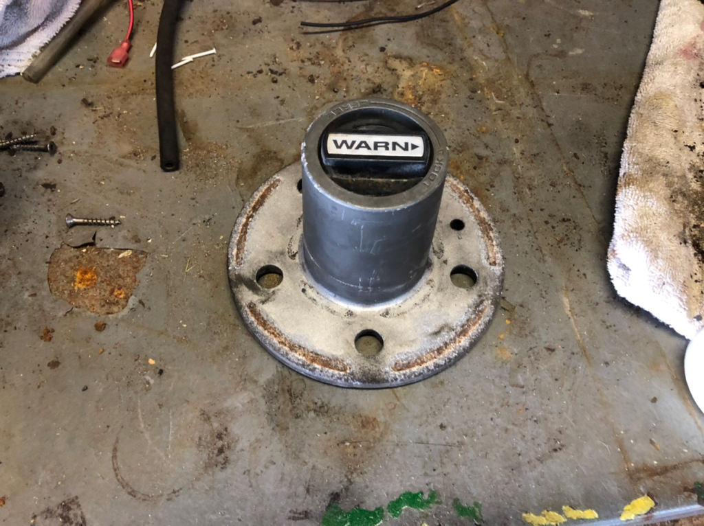

I also picked up a spare Warn lockout from the junkyard.
‘94 4x4 Swap/Build
And countersunk it for the retaining bolts

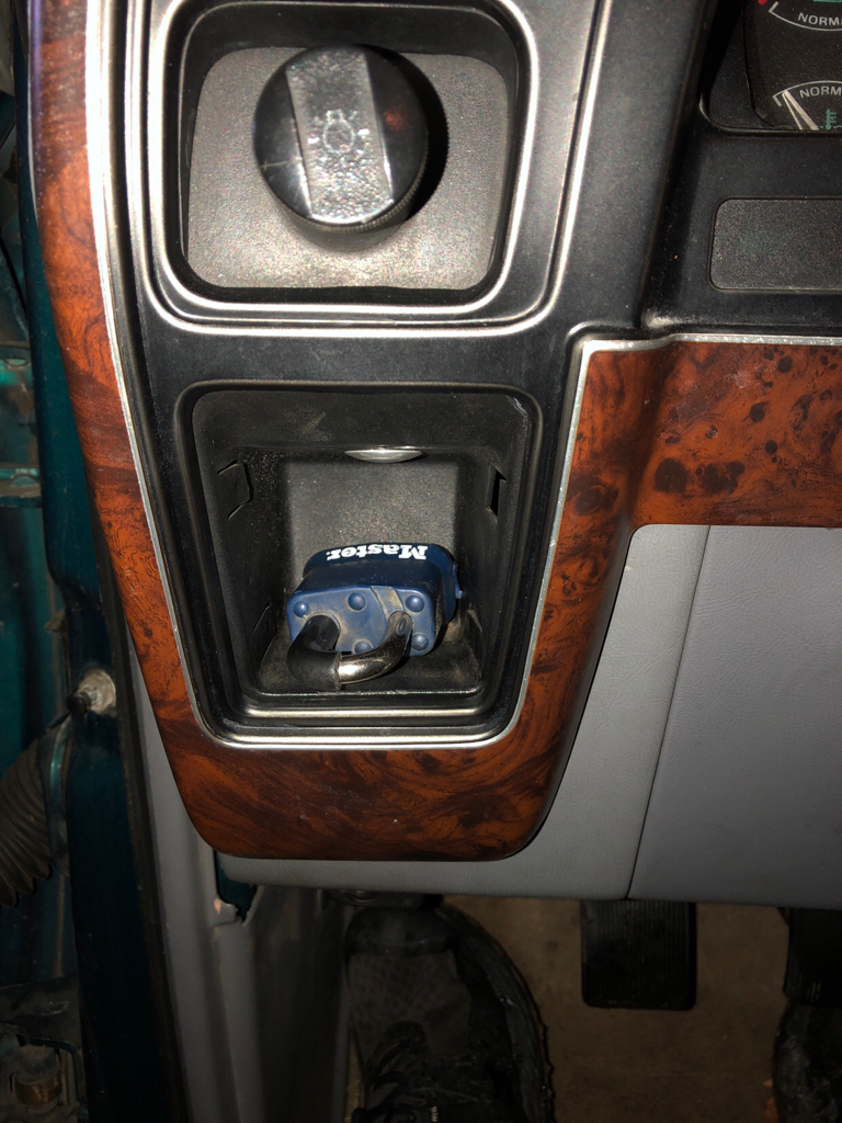

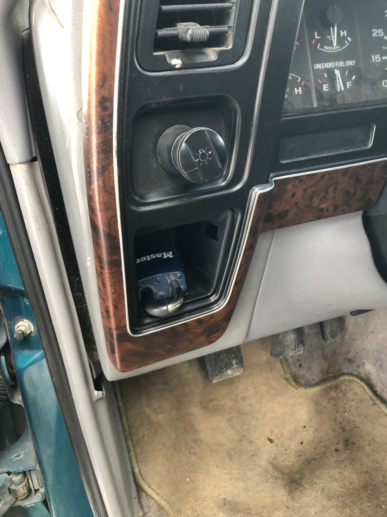

I also finally found the little cig cubby that goes under the headlight switch in the gen 2 trucks. My minty wood grain dash bezel is finally complete.
‘94 4x4 Swap/Build
Air horn button is tucked away nicely in the top of the cubby.

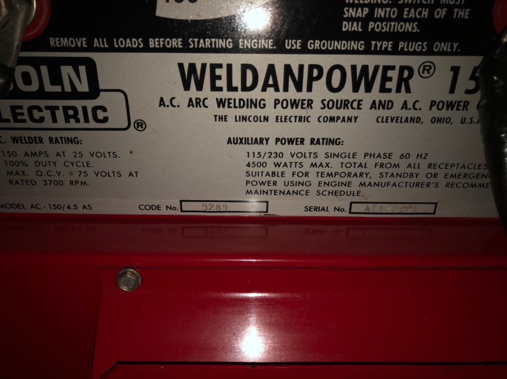

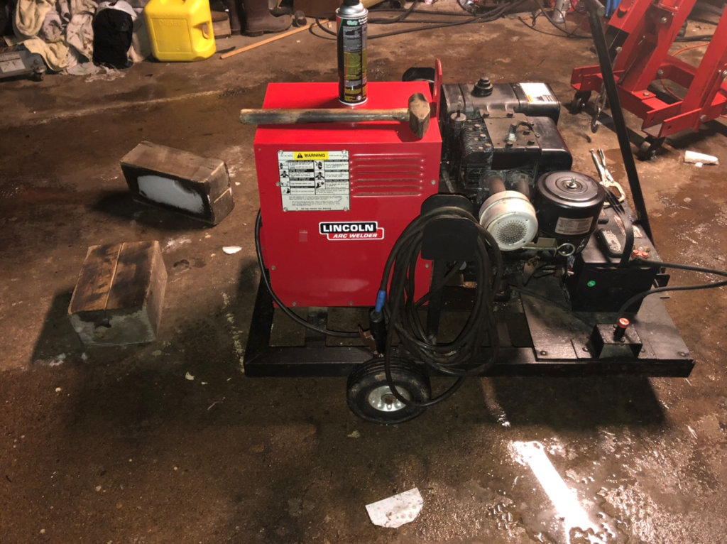

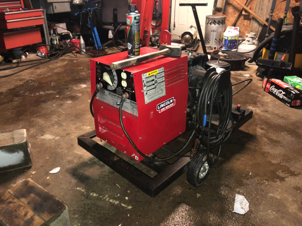

1988ish Lincoln Weldanpower 150. AC only engine driven arc welder that doubles over as a 4500 watt generator.
That's great! What did that set you back? Youv'e done arc welding before?
About $50 in gas. It was my grandfathers. He passed away in ‘96 and it’s only been used a couple times since then. Grandma is in her last years of living alone so I rescued it from a few of my greedy family members.
I do have some experience burning some rod. Mostly 7018, some 7024 and a pretty good amount of 316L. I picked up 5lbs of 6011 and 5lbs of 7014 for basic repairs at home. It’s kind of a lost process outside of pipeline work. We occasionally do some stick welding at work but it’s usually reserved for tight corners or narrow gaps around pipe joints.

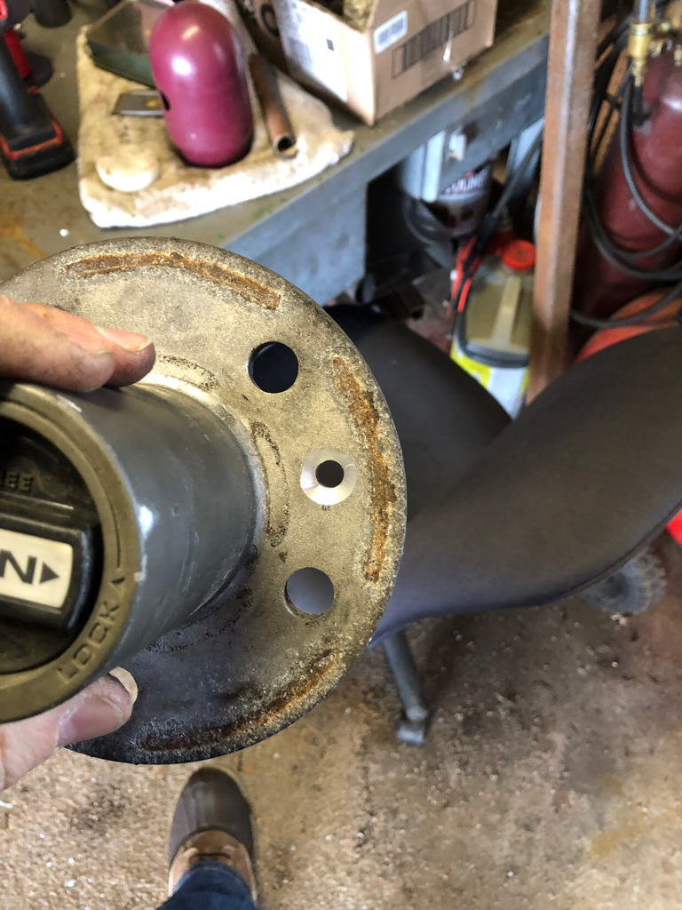

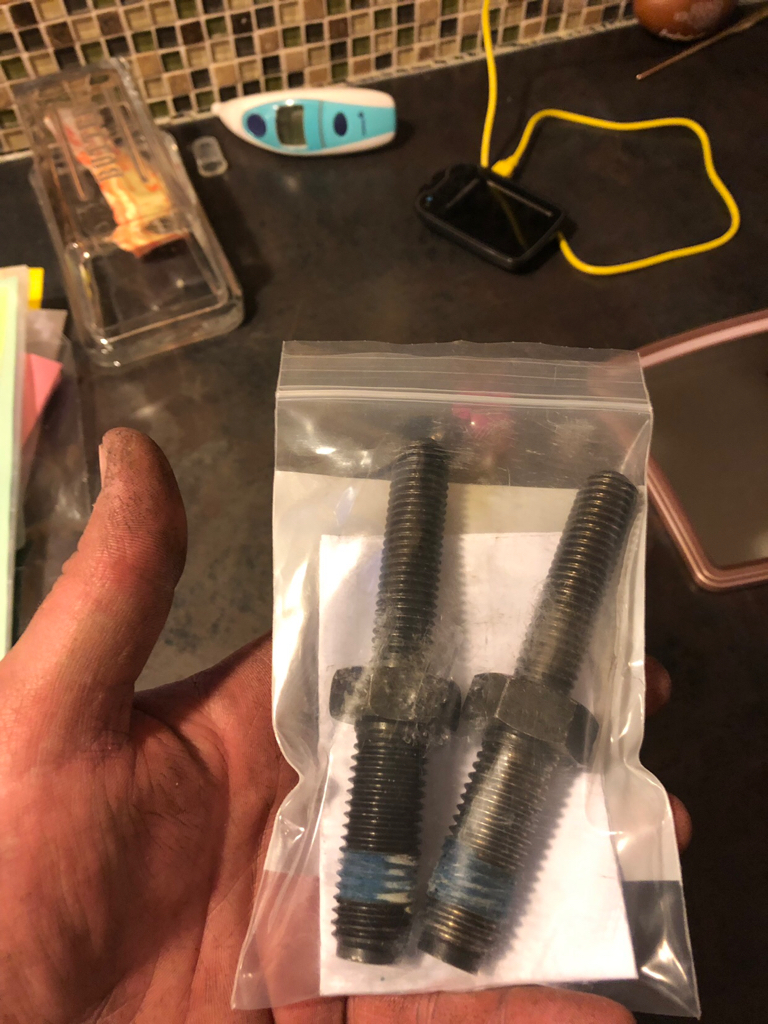

I did find the front end rattle that I was convinced was coming from the Warn hubs. Turns out the bolt on the back side of the front diff that holds it to the ttb arm broke. Fixed that. Did some exhaust work and wired up the topper lights.

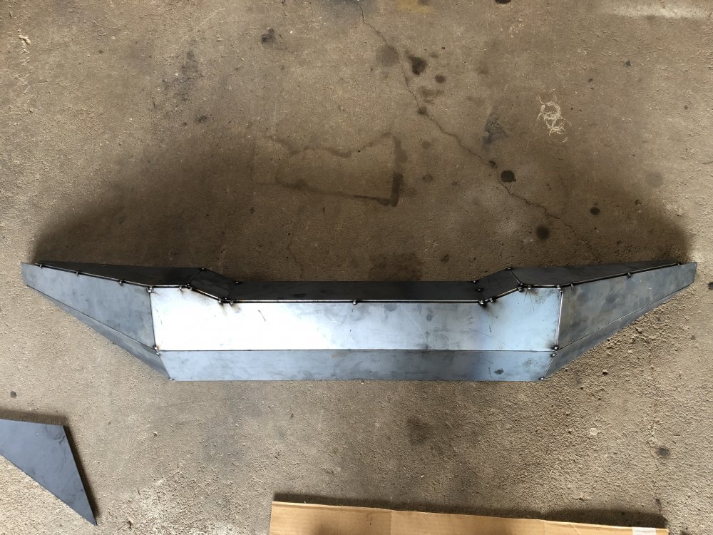

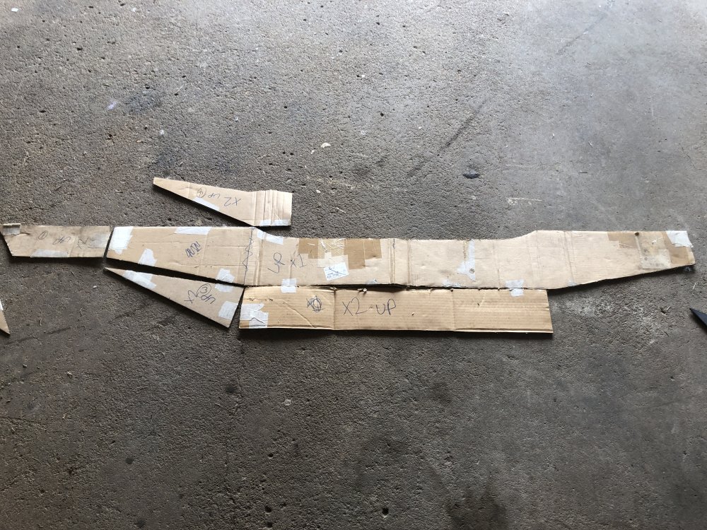

Since then, I built a front bumper out of 3/16” plate and plan on building a rear bumper in the fall when I go back to days.

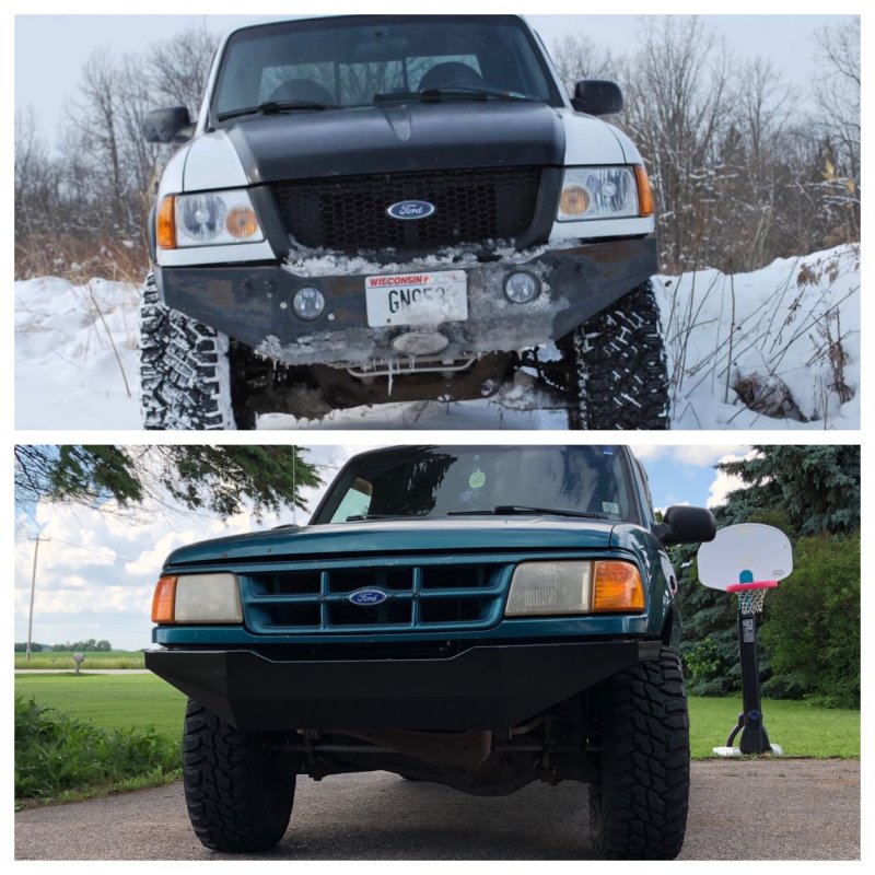

I did manage to get the front end up a little higher with a “washer lift” which actually consisted of stainless steel spacers I cut at work. Sitting right at 36” from the highest point of the wheel opening to the ground.
You did a great job on that front bumper, it flows with the front of the truck. The whole transformation of the truck is remarkable. Will you do a rear bumper for this?
Thank you. I do plan to do a rear bumper at some point. Not sure yet if I want to build one out of plate or 2x6 tube like I did on my old truck. Either way it will have a receiver tube and some recovery points incorporated into it.
Will watch for it. Perhaps a plate rear bumper to match the front. The whole truck will have good flowing look to it. If you did a tube bumper, here is a suggestion. My dad had an ole trusty 81 courier, and he used that truck for construction. He found a metal pipe, maybe 4 - 5 inches in diameter, and he cut it to length sticking out about 2 inches on both sides of the bed. He welded a cap on one end, and filled the whole tube with concrete. He welded a cap on the other end. Made brackets and welded to the truck. Many things hit that tube bumper, and not one dent ever. He had that truck all thru the eighties for construction.
