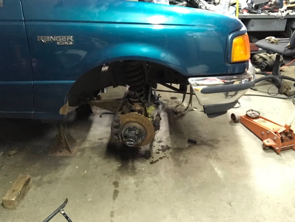

Fast forward 13 years and this was basically how I got it back. I had lowered it a couple times at one point and the front end was shot/.
‘94 4x4 Swap/Build

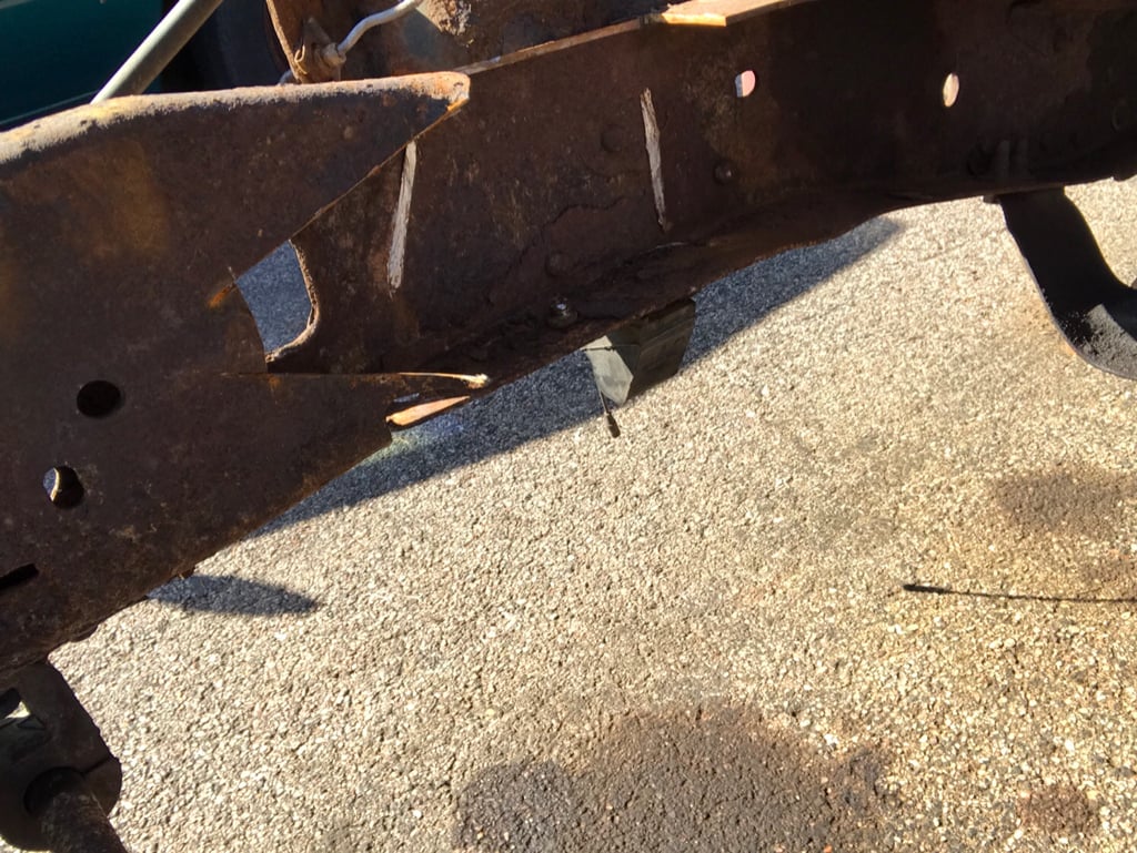

Going under the knife for the crossmember/axle.
‘94 4x4 Swap/Build

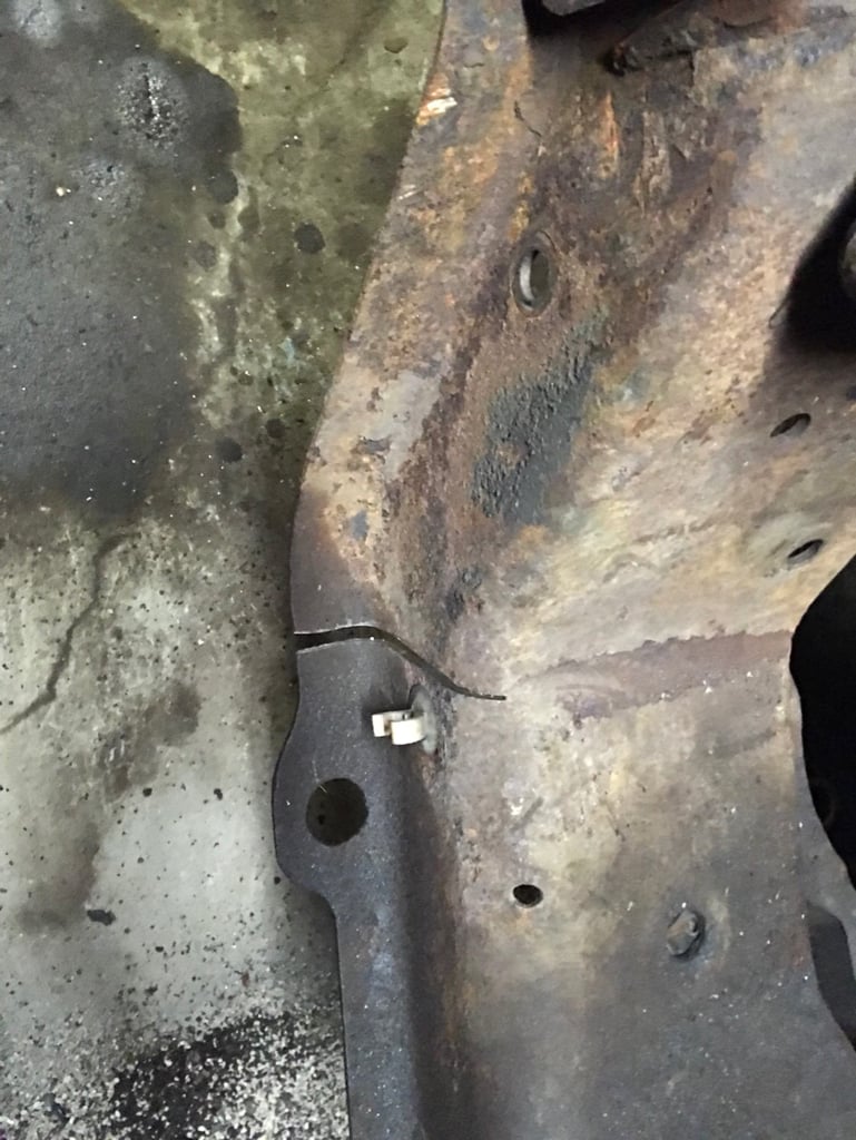

This is what’s left of the frame rails after you hack out the engine crossmember. You can see the weld that need to be cut to remove it. This pretty much destroys the frame. There’s no good way around it.
‘94 4x4 Swap/Build

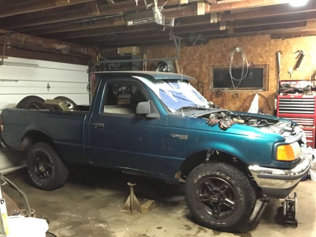

Cab is back up where it’s supposed to be. Body mount bushings are still in pretty good shape. It took the full half inch to get it right. I’ll have to shim the bed up .06 to .125 to get it perfect but I really don’t care. Only three of the six cab bolts were actually tight anymore. Rust got the best of those. Replaced everything with 1/2” grade 8.
