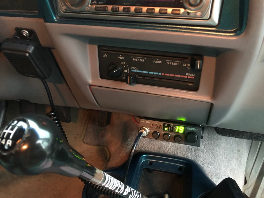

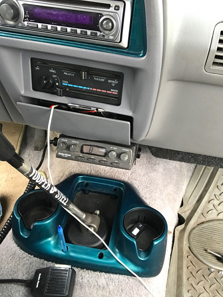

Small update. Cb installed for a small off road/camping trip in the UP mid September. I started with a radio shack cb but threw in a Uniden pro 520xl I had sitting in the bench. Antenna mount was made by me and the coax runs around the outer edge of the roof inside the cab. This was the only way I could keep fuel pump noise to a minimum without cutting wires.
Old Radio Shack trc-483. Modulation was ok at best and good mics are hard to find. I may wire in a 4 pin receptacle to run a nicer mic. I like this radio quite a bit but it could use some upgrades to be a good radio.
The little Uniden. Great radio but very sensitive to interference. Takes a little squelch and dialing back the rf gain to quiet it down.

My antenna is an older fiberglass k40 with the tuning sleeve on it. I have the spring out now to get my swr down. Only managed to get it to 1.5 on channel 1 & 40. 19 is at 1.1. I also have a 3 foot fire stik with the tunable tip but the swr on that one was in the 1.6 to 1.7 range. I’m not trying to talk miles out, just want to communicate with my buddies when we’re out playing.
