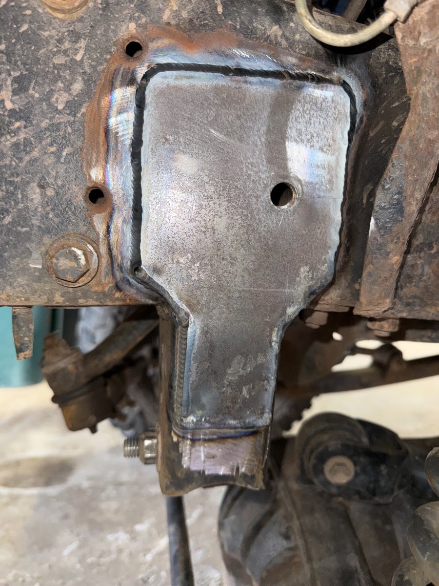

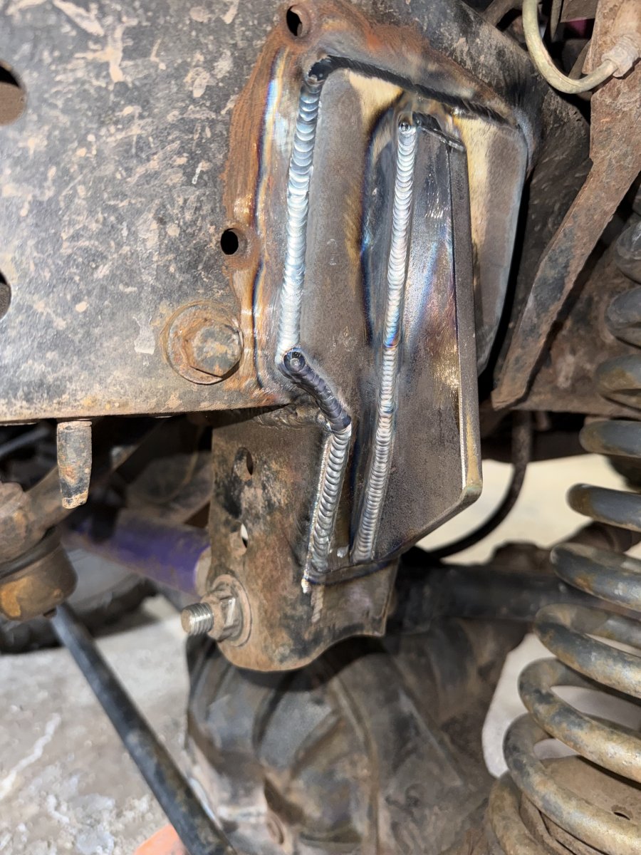

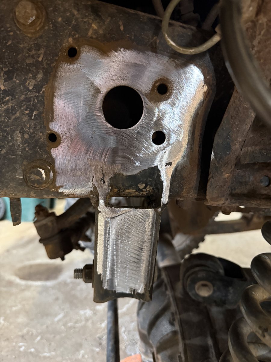

Chasing some front end slop. Never did gusset my track bar mount. Probably should do that before the frame cracks.

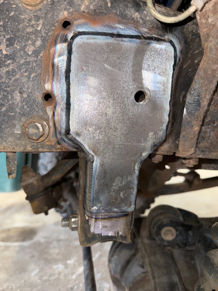

Should be nice and stiff now.
  • ‘94 4x4 Swap/Build
Should have done this right away. I also adjusted my track bar after the gusset went on and the truck sails down the freeway with almost zero steering play. One finger on the wheel 70mph.
I didn't think there would be that much flex in the frame right there. Guess I was wrong :shok:
I wrap my track bar mounts up the side the of the frame for this exact reason. My first ever track bar mount bolted on using one steering box bolt and a bottom through bolt I drilled and tapped into the frame....it was always working loose.

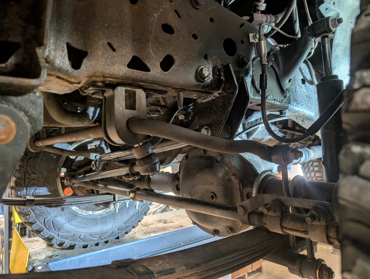

On my coil spring SAS truck I took the gussets damn near to the top of the frame, but it sees more abuse since have a hydraulic ram on the pitman arm.

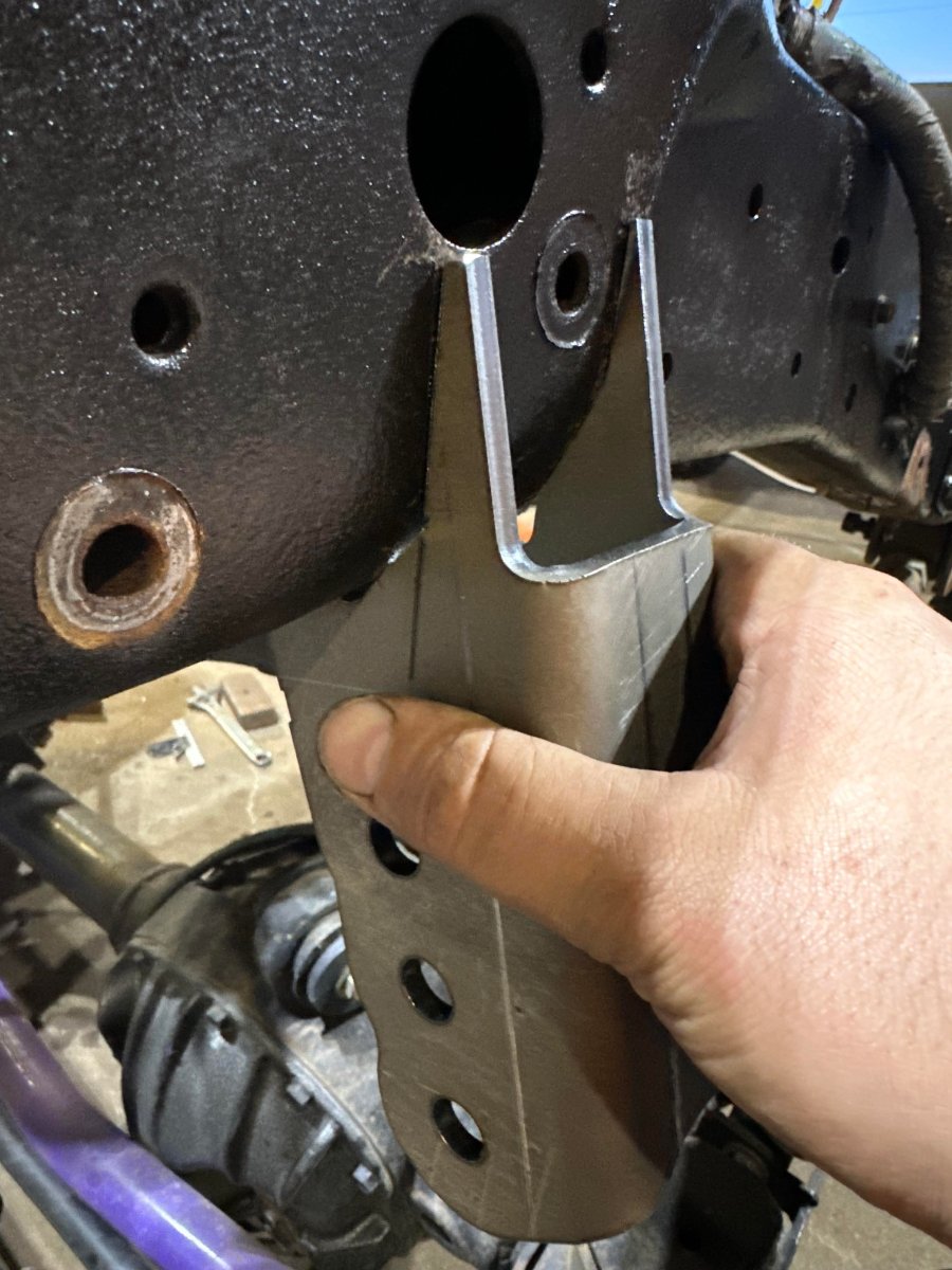

I don’t remember where I bought the bracket from but it was originally notched to angle out toward the wheel and had some gussets that would have ran up the side of the frame. My track bar didn’t have enough adjustment to mount up so I had to cut it off and swing it in just past vertical.
I had trimmed it to fit at the angle I thought I needed so there is some meat missing. I did a real hokey poke job scabbing it back on. It survived two trips that way though.
Looks like a part from Barnes 4x4
That’s very likely. Barnes is awesome for quick stuff. I’ve had pretty bad luck with Ruff Stuff lately. Still waiting for an order placed 02/07 to ship. Barnes didn’t quite have what I was looking for.
