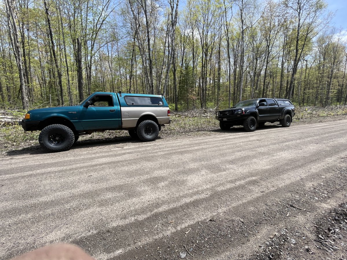

So we did our annual guys weekend trip to the UP. Did the same trail from Crandon, Wis. to the tip of Michigan’s Keewenaw peninsula. We modified it slightly this year and only did the fun stuff really. You miss a lot of neat views and stuff this way but it cuts out the worst sections of trail. Made one grave mistake that took out the front diff in my truck along the way. The Ranger and the Yota my buddy built

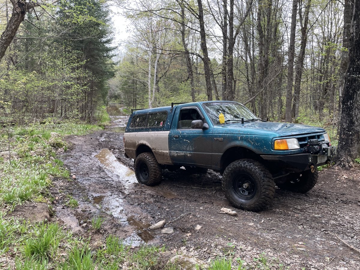

The worst “mud hole” of the whole trip. There was a tree across it about 2/3rds of the way in, bottom was fine sand and it stunk!
Through the other side. There was a tree down about 2/3rds of the way in, bottom was fine sand. Naturally I forgot my chainsaw so we had to use an axe where necessary. There were 3 trees down across the trail and we used the winch to clear all three.

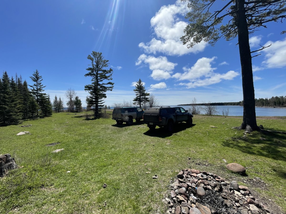

Final destination. That’s Lake Superior in the background.

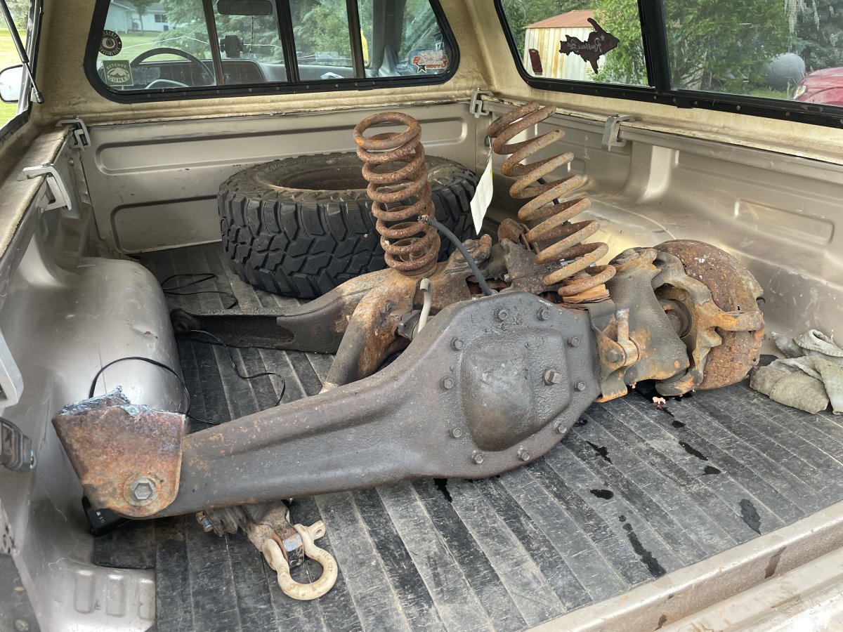

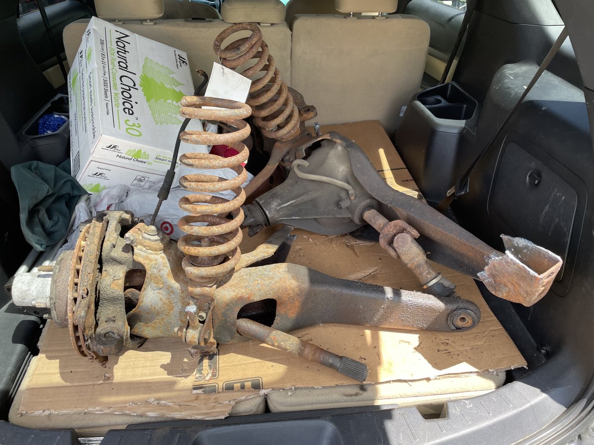

I ordered a used front 3rd member over the internet from a junkyard about an hour away. When I arrived in my wife’s Explorer, this is what they had for me!

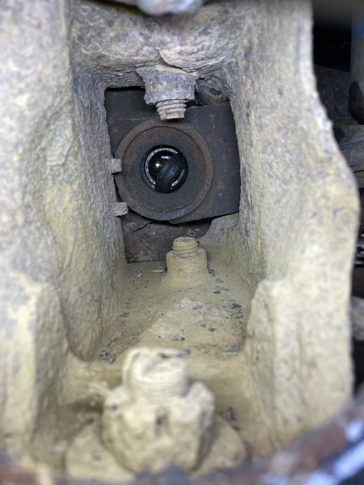

Gladly tossed it in and left. It’s in the back of the Ranger now until I’m ready to work on it. Kind of playing with the idea of doing the lower ball joint cut and turn and also going to uni balls.

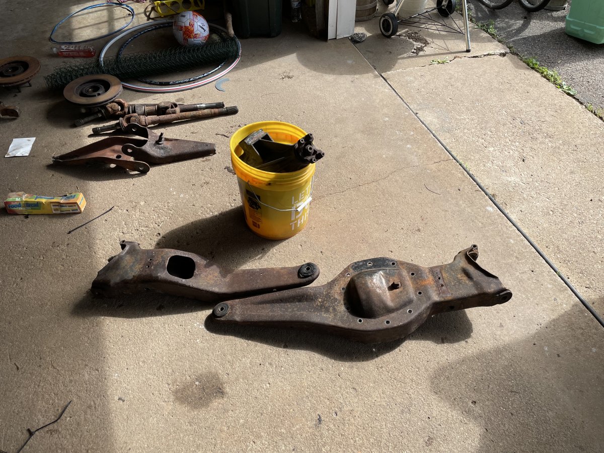

So after reading through stuff, I doubt I’ll do a cut and turn. I may offset the uni balls towards the top of the beams a little but that will be it. I ordered seals for the new used front diff and the guy at the junkyard was nice enough to cut the radius arms off at the stud instead of right in the middle. So I’ll be rebuilding my extended radius arms also. Looking into K-link steering as I have a feeling the front will flex much better with the uni balls.

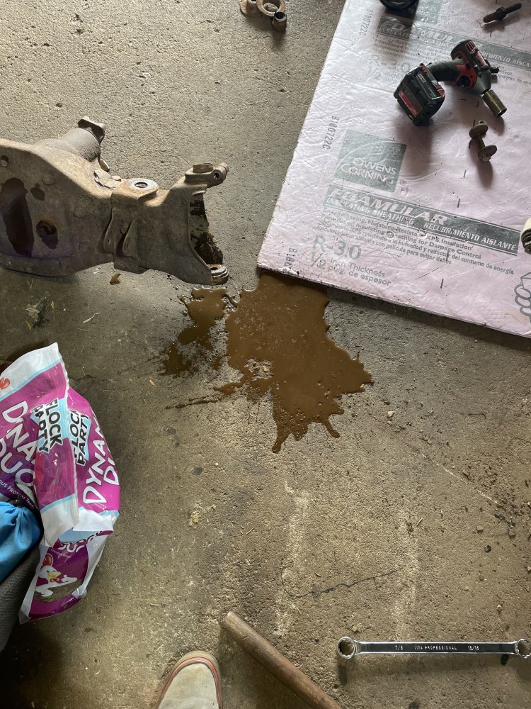

Got the used D35 stripped down. New seals installed in the chunk and everything pressure washed. I need to decide real quick if I’m going to cut the lower ball joint mount out of the beams and pull them out some. I’m almost maxed out on camber adjustment and have no plans on modifying my setup any further. The truck flat out works for me as it sits.

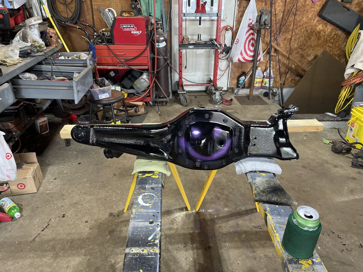

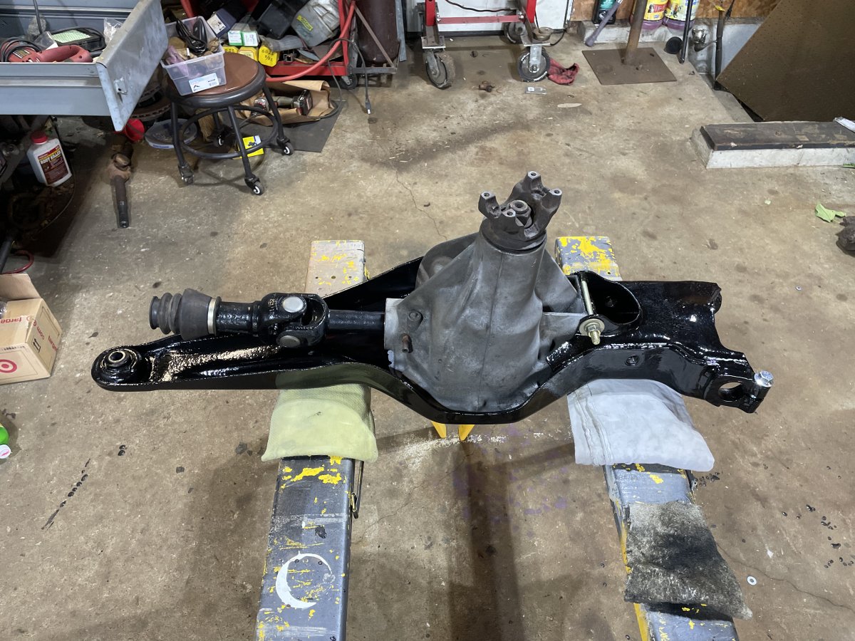

Not much new. The half rebuilt front axle is in.

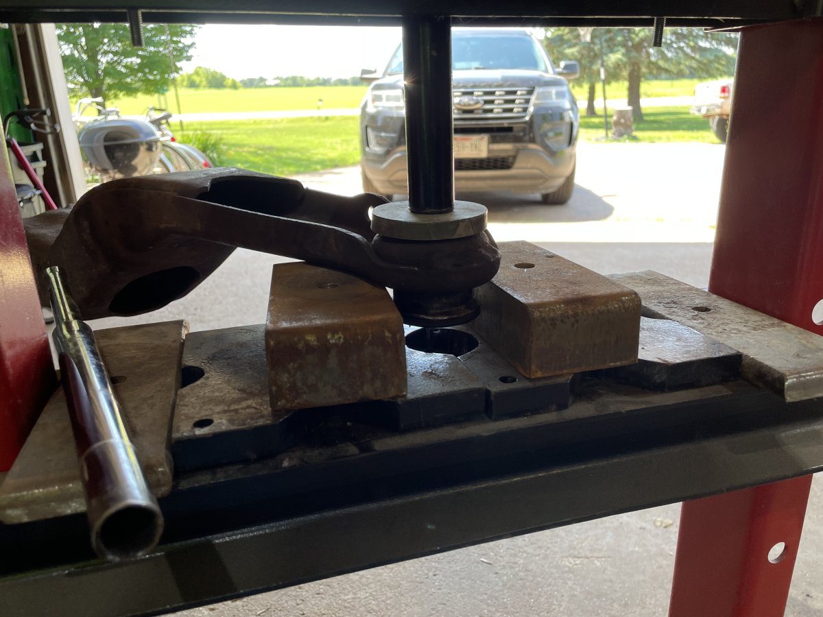

Did brand new pivot bushings and seals. I went around the pivot bushings with a punch and shrunk the flared end and they pushed right out.
Got everything painted up with Por15 and top coated with rustoleum professional and bolted the “new” third member back in.
Purple smiley per the kids request. Yes my garage is a disaster.

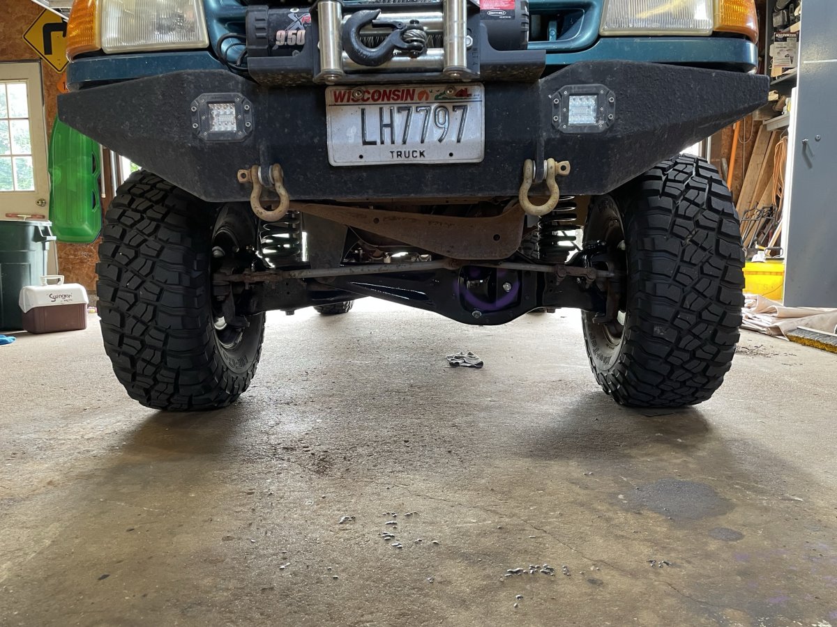

And in the truck.

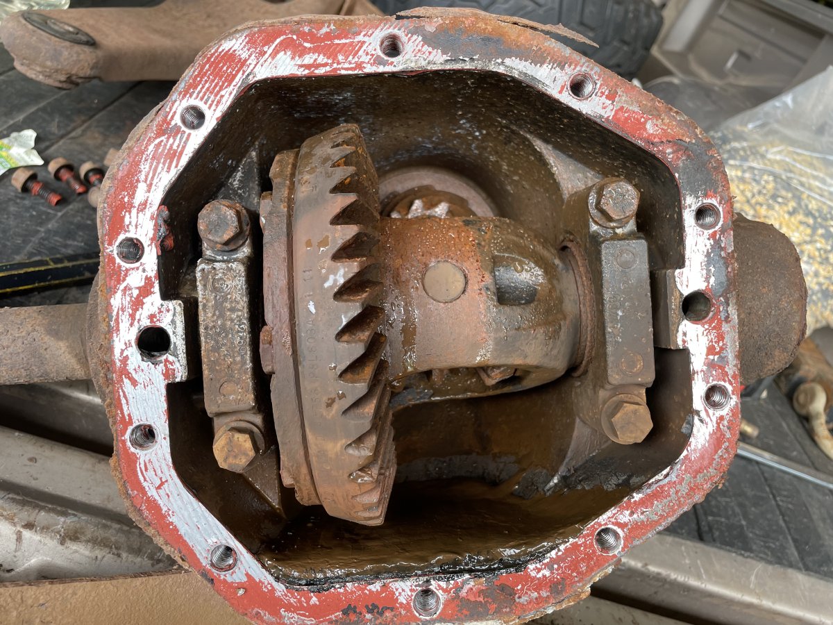

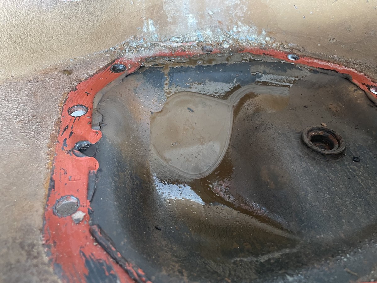

Here’s a small photo dump of what I found wrong inside the original axle.
Pretty sure I will be checking that seal at least annually from here on out.

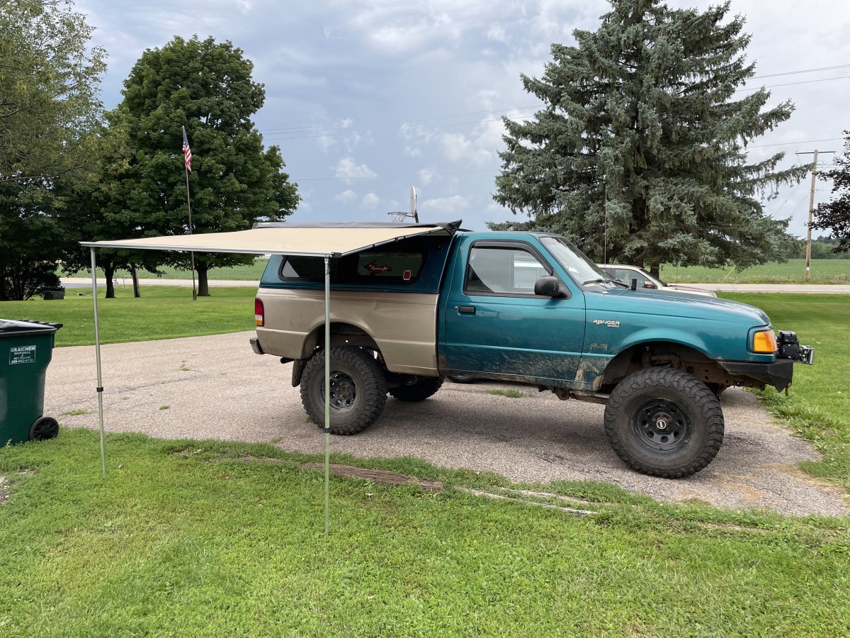

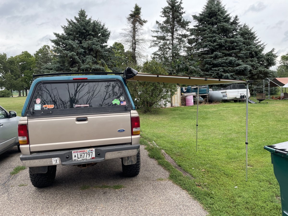

Ordered a Smittybilt awning for camping. I also ordered the walls to go with it but haven’t gotten them yet. I’m really against the whole “overlander” look because everyone with a Jeep in my area goes hog on it but I’m also tired of trying to bungee a tarp between two trucks and still getting wet.
Pretty neat little unit. It all folds up into an aluminum extrusion inside the bag. Setting it up alone can be a little tricky but I’ve only done it once so far and have some ideas of a better way. Looking forward to trying it on an overnight trip towards the end of the month.
