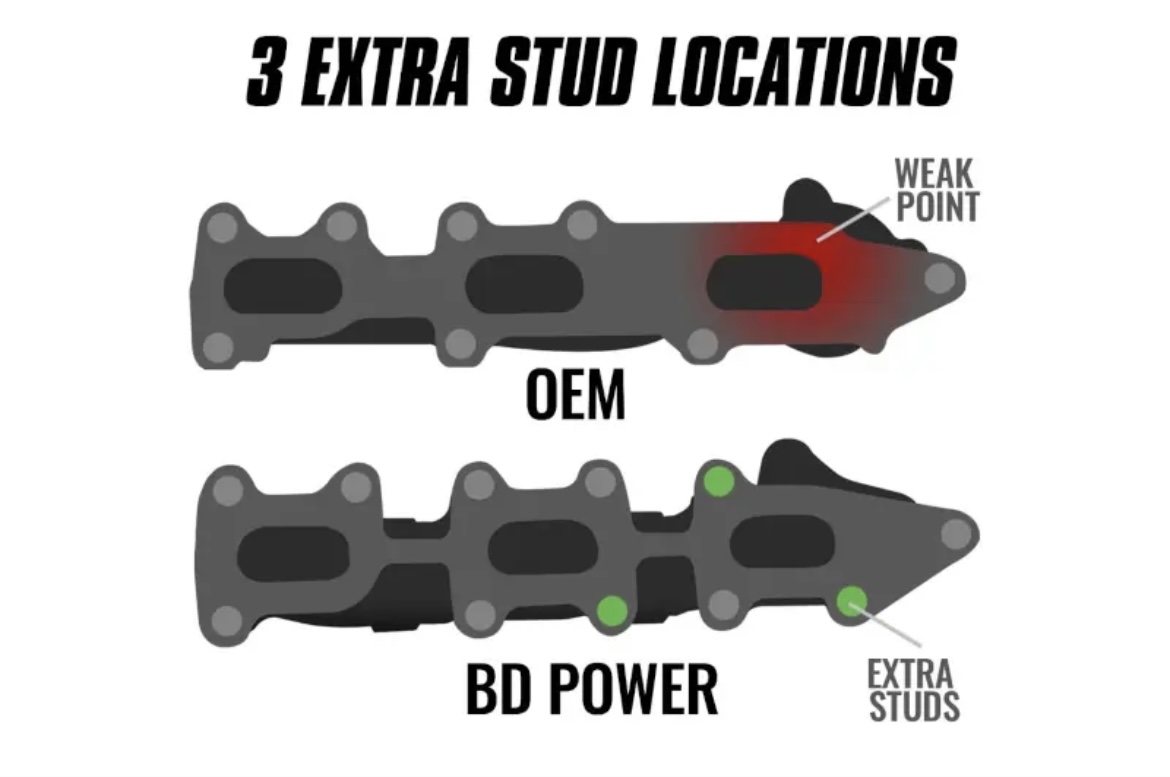

Sorry for the bad juju lol. No wonder your having issues though.. OEM fastener locations are definitely subar on the backs of those manifolds holy cow.

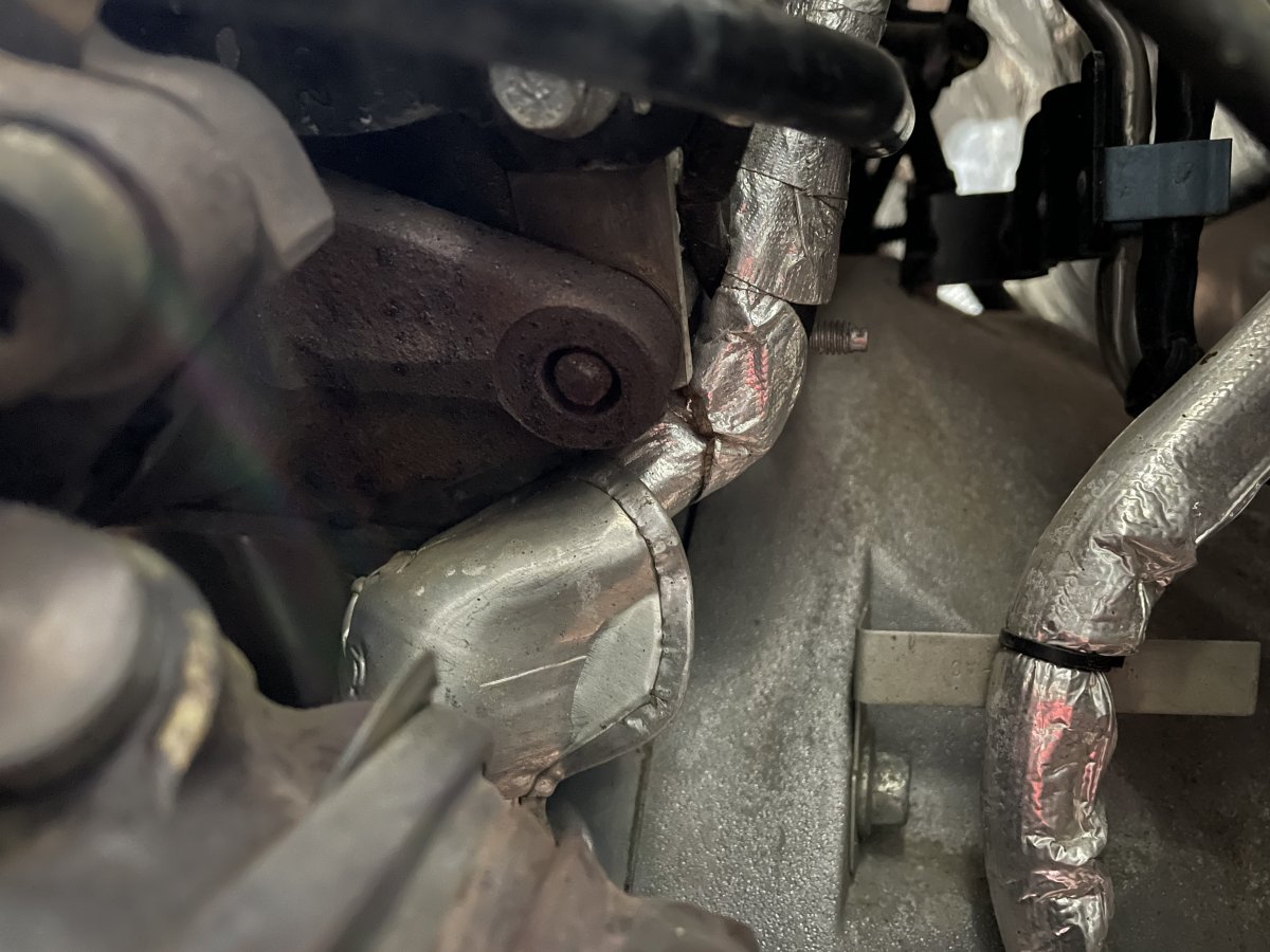

Already broke the F150 (I blame Blmpkn). Either warped the drivers side exhaust manifold or the rear bolt/stud broke. Can hear the gasket flutter like a reed valve under boost. This was the first time it didn’t idle for 5 minutes before I hopped in and took off.
So I ordered the BD diesel manifold set and all the gaskets/fittings/hardware needed to replace both manifolds. This should be a permanent solution but I may also look into turbo supports to take some of the weight off the manifolds.

I was just ribbing you, all is good! Why Ford didn’t make use of the extra holes in the first place is baffling. I’m sure they are there for mounting manifolds in a different application.

Well I got it fixed for now. Dealership I bought it from never even bothered to call me back. I don’t want ford parts on it anyways.

Just enough room to get in there and weld a nut on.
70051
I found a bolt in one of my metric buckets that had a nice heavy Belleville style washer on it. Ran that it and torqued it to 19ft lbs. per spec.
70052
This thing should probably have its own thread. I’ll start one when I get to changing the manifolds out. For now though, my reed valve manifold is fixed.
