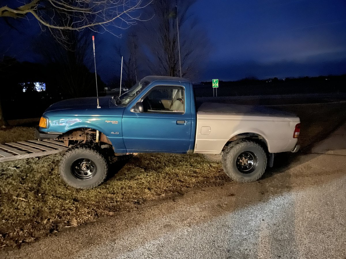

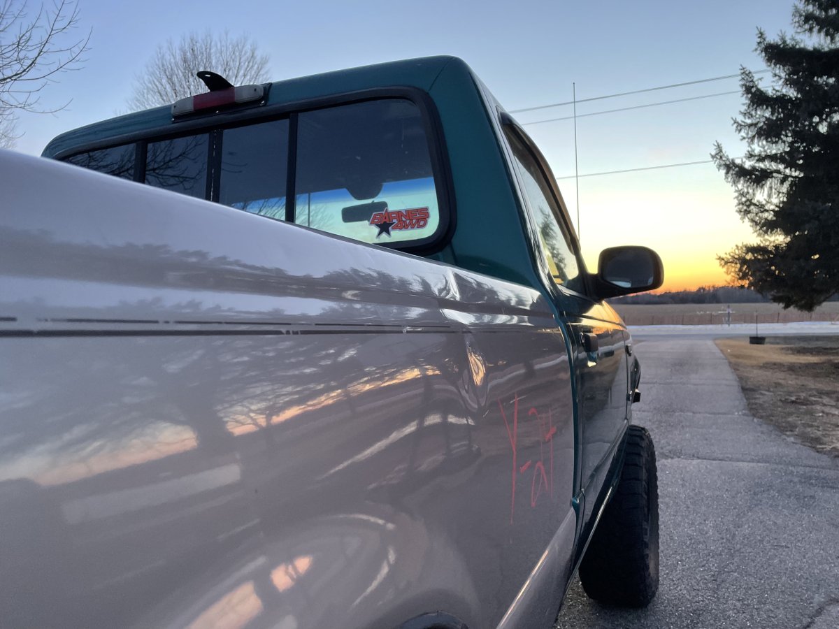

Truck looks pretty goofy two colors but I don’t care. The bed is solid for the first time in a long time.

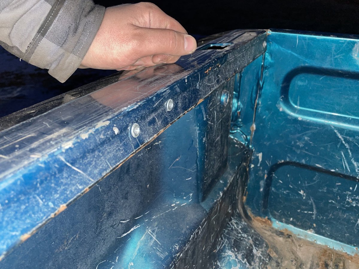

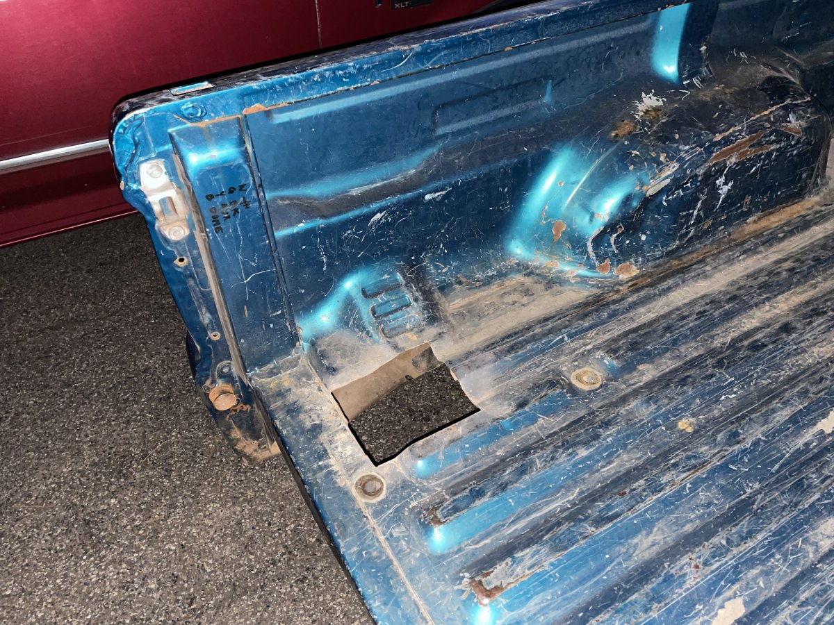

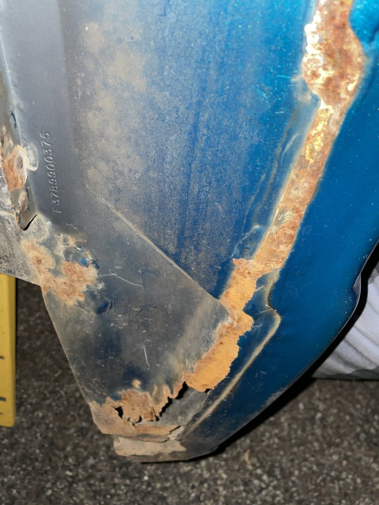

And a glimpse of what was wrong with the original bed. The whole drivers side of the truck was wiped out at one point.
There was a hole like that on both sides that the shackles protruded from when the truck was slammed. Wheel tub has rust perforations at every spot weld on both tubs and you can see where the spot welds and seam sealer let go towards the rear of the bed rail.
73355

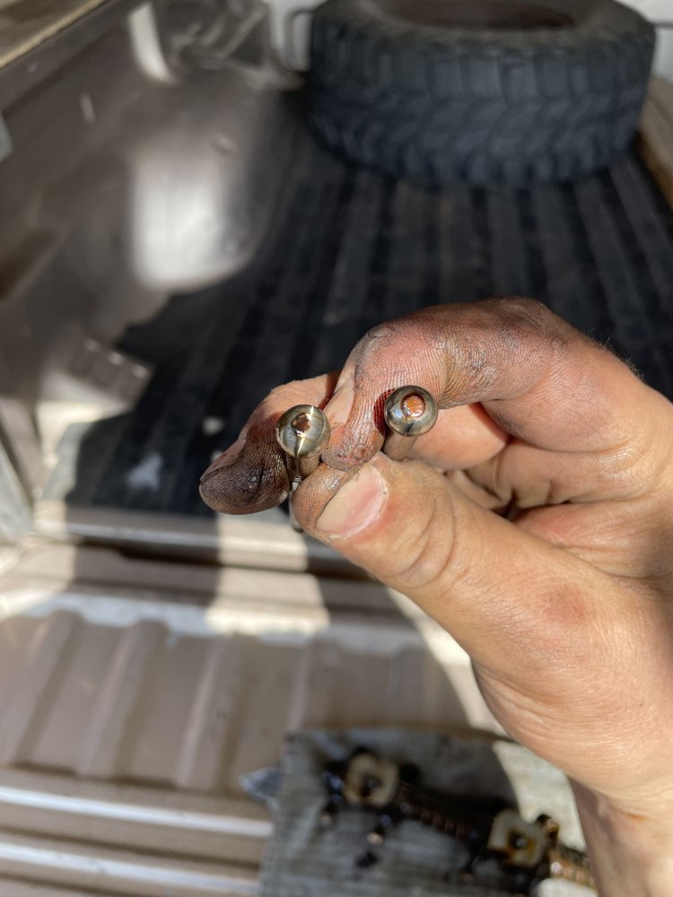

I had started putting lath screws in the bed rail seam to keep it from making noise

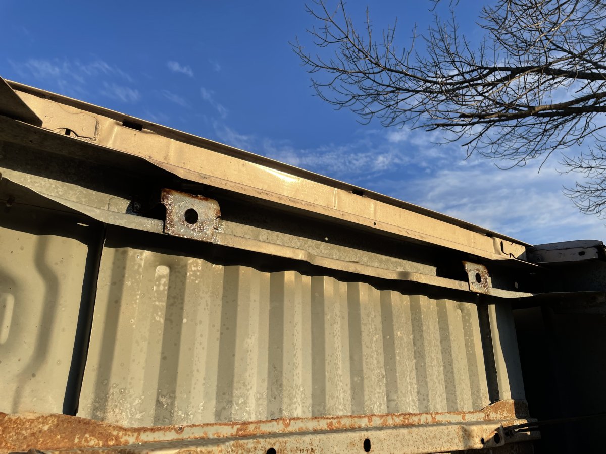

73356
The seam below separated completely, or rusted out. The bed side is completely detached from the front half of the box.
73357
73358
All of that plus the rotten wheel arches and other rust problems and this box is junk.

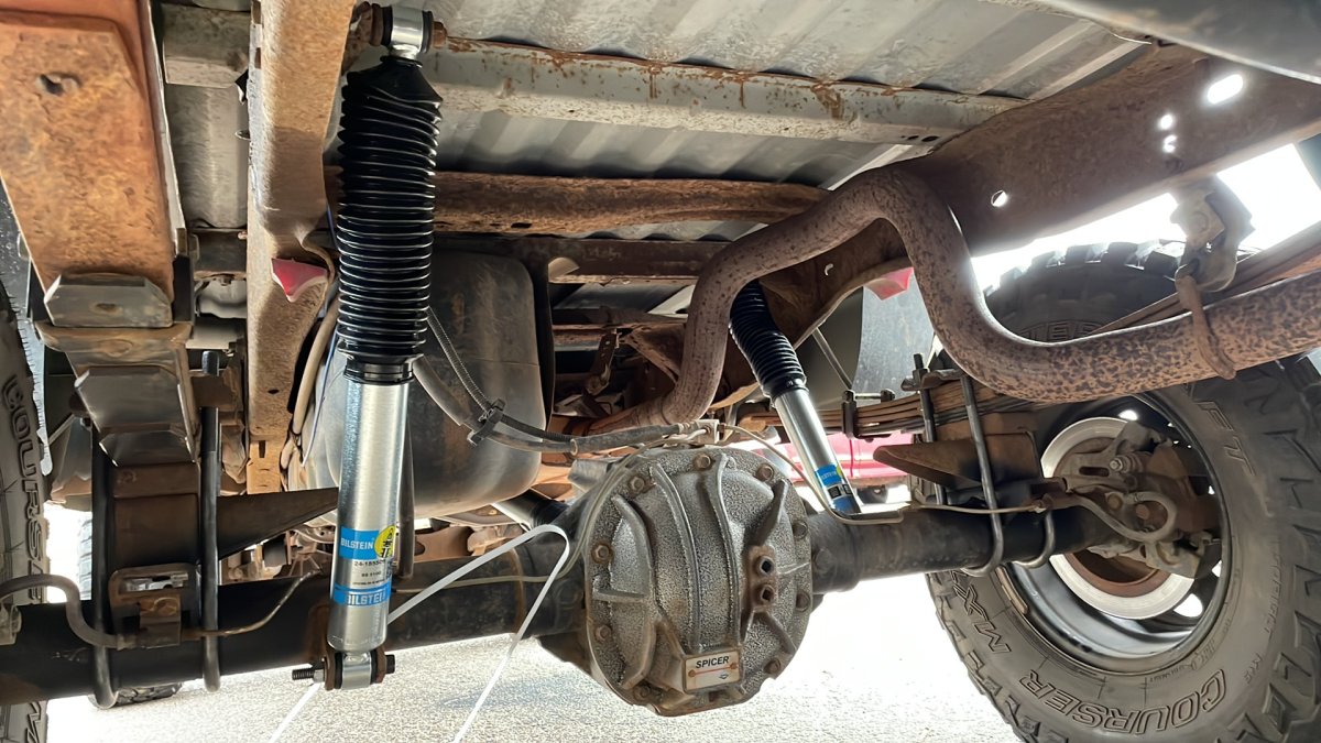

And ordered 4 of these :icon_thumby:
74307

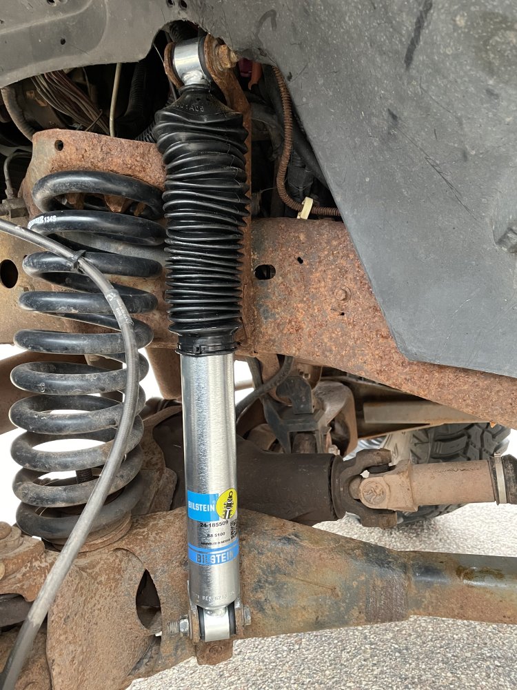

I set the truck up to run the same shock on all 4 corners. A stock length 4x4 Ranger rear shock.
74308
74309
Had to clearance the lower tabs on the front a little bit so they wouldn’t contact the shock body.
74310
Holy cow did the shocks make a huge difference in how the truck handles. It actually feels connected to the road and feels solid vs. bouncing around and swaying uncontrollably. I took it down a washboard gravel road and it soaked up the bumps instead of bouncing over them and tossing the truck sideways. By far my favorite “mod” yet.

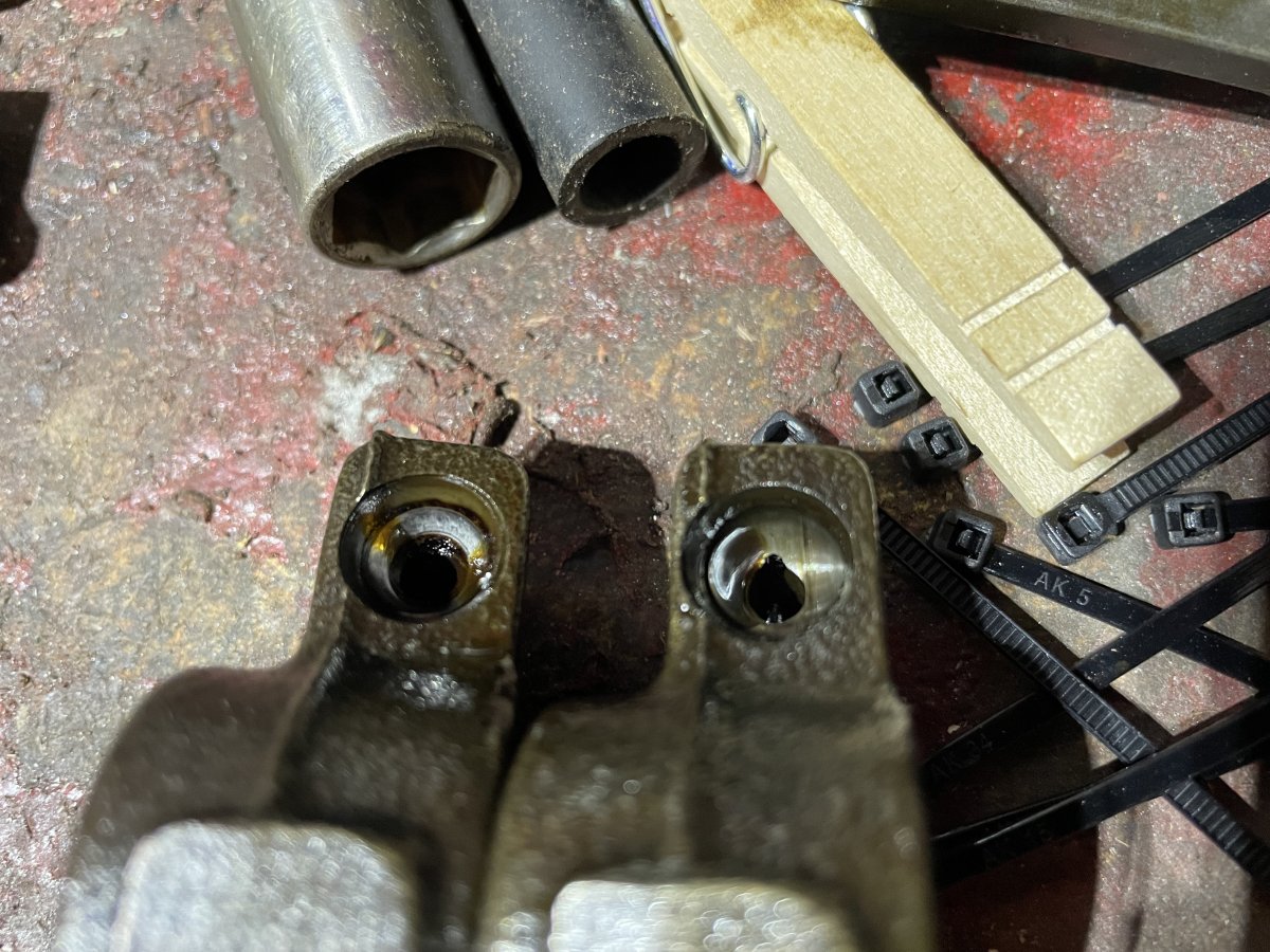

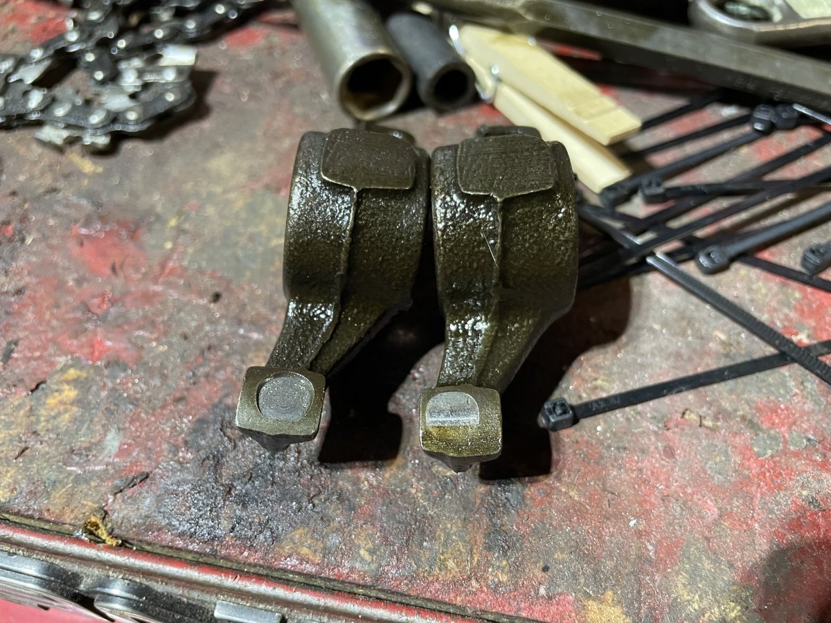

Also took care of all of my valve train clatter. At 27X,XXX miles on the 4.0 in this truck, it only had two bad rockers and one bad push rod.
Rocker on the right has a worn ball cup. You can see it started to wear into the oil passage.
‘94 4x4 Swap/Build
rocker on the left had wear at the tip from the valve stem. I’ve never saw this before. Stuck valve at some point? They all move freely now.

Both rockers came from cylinder 4 which is interesting.

Isn't number 4 cylinder the last set of rockers on the oil feed line?
VW air cooled engines with aftermarket high ratio rockers have similar rocker arm to valve tip configuration. We use to put hardened "lash caps" on the valve stem with a much larger surface area to prevent that kind of rocker wear. Of course the rocker shaft had to be shimed up and custom length pushrods cut to keep proper geometry.
Happiness is a fresh set of tires...
That I do not know. It looked to me like the whole assembly is oiled from the center pedestal. I know PlumCrazy added some oiler lines to the heads on his truck and explained why at the same time. I might have to dig into that.
