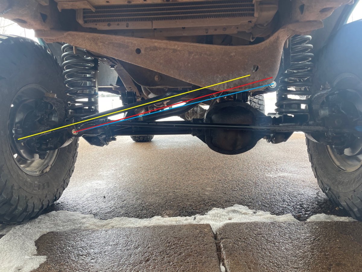

Well I was close with my track bar mount. I need to move the frame end of the bar up about an inch. Other than that, the truck actually drives really nice. Very minimal bump steer given the angles are off a bit. It’s mostly noticeable when I change gears under hard acceleration.

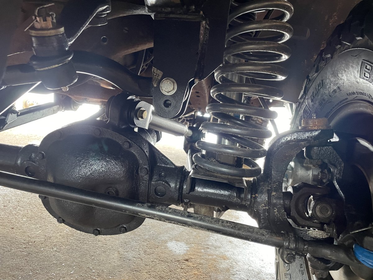

Apparently I got a little too drunk last night and hit Amazon hard. Ordered a different track bar without the bend at the top to clear the diff… in purple :icon_confused:. I also ordered the spicer diff cover to match the cover I put on the rear, a lube locker gasket and a rebuild kit for the transfer case. I also have gears in my cart for front and rear on RockAuto but apparently didn’t pull the trigger on those:iamwithstupid:.
I did move my track bar yesterday though. Truck really drives nice now. Also trimmed some more of the crossmember out. The track bar has smacked it a couple times.

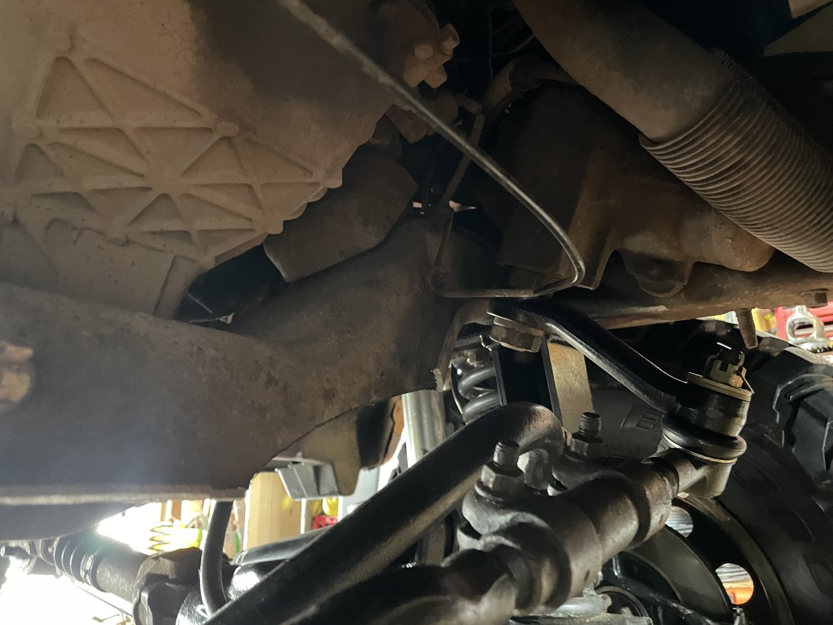

You can also see why I ordered a non bent track bar in the pic below. The current bar is only a couple inches away from the sector shaft on the steering box.
