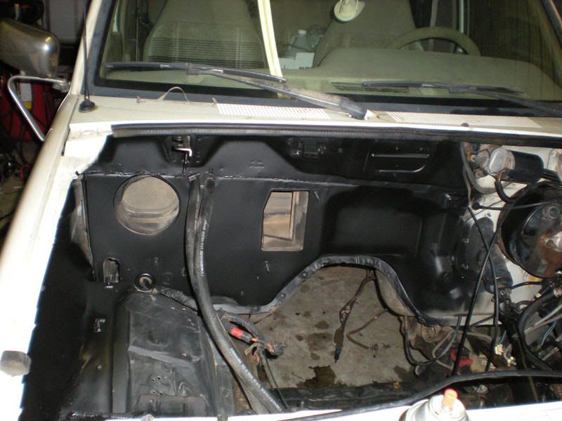

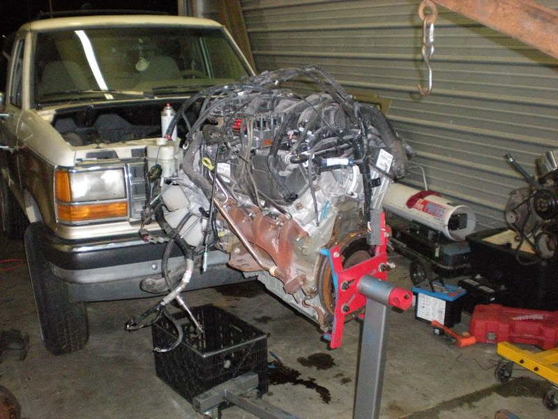

Got a little more done on it.
Got the heater box off and about half the engine bay wiped down and painted, the other half will require removing a few things and whatnot so I just held off for tonight, ill finish it tomorrow.
Got the engine off of the hoist and onto the engine stand so I can start sorting wires for the EEC-IV swap.
Sometime this week im gonna fab up my X-case shifter bracket that way I can start getting ready for this thing to go in.
Sorry for the slow progress, im a busy guy, but Ill git-r-done.

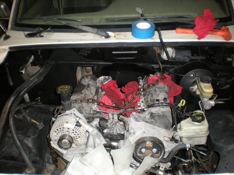

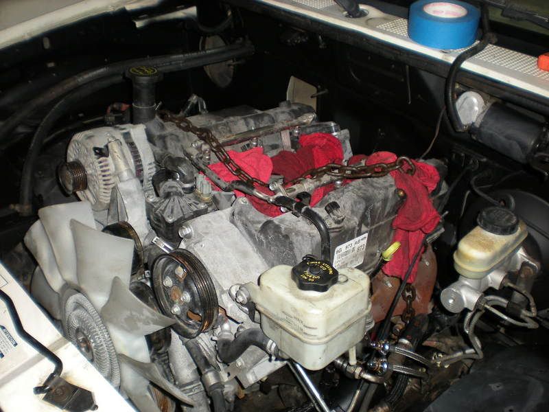

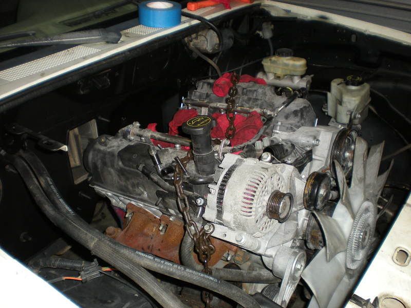

Few teaser pics...
I set the engine down in the bay to check for clearance issues and it fits awesome. I thought I was probably going to have to move the engine forward an inch or two, but it fits great with no obstructions but the heater box. Im going to have to cut the box (much like a 5.0 swap) and it will prbably limit the heater (blocks about half the hole in the firewall) but I dont think there will be any problems beyond that. I will have to say though, that engine is a pain to get past the radiator support if you leave the fan on.
Also Im not going to be running AC, but if I was, I think there could very well be issues with the steering box and the AC compressor, but with that being the case, I dont think you could use an AC heater box anyway.
Also, FYI, I just bolted the stock 2.9 motor mounts to the 4.0 and they worked fine.
Also...
Has anybody successfully ran an OHV 4.0 on an aftermarket 5.0 calibrated MAF sensor?? I know the sensor part number for the 4.0 is the same as the mustang (meaning it has the same voltage curve) so I would assume one could use a calibrated MAF without major issue. Does anybody know if anyone has tried it?
Sounds like a case where Efans would be handy. :icon_thumby:

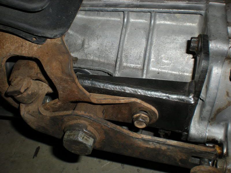

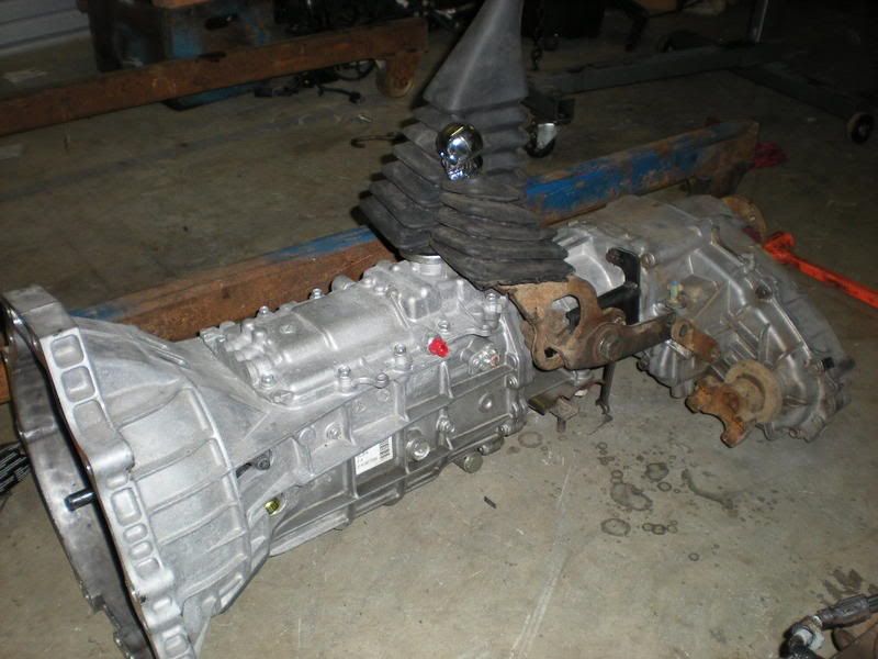

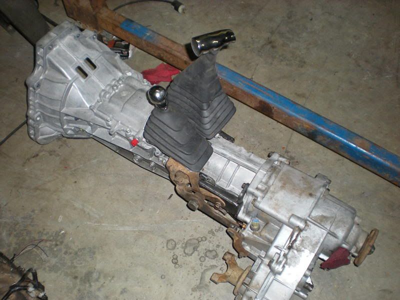

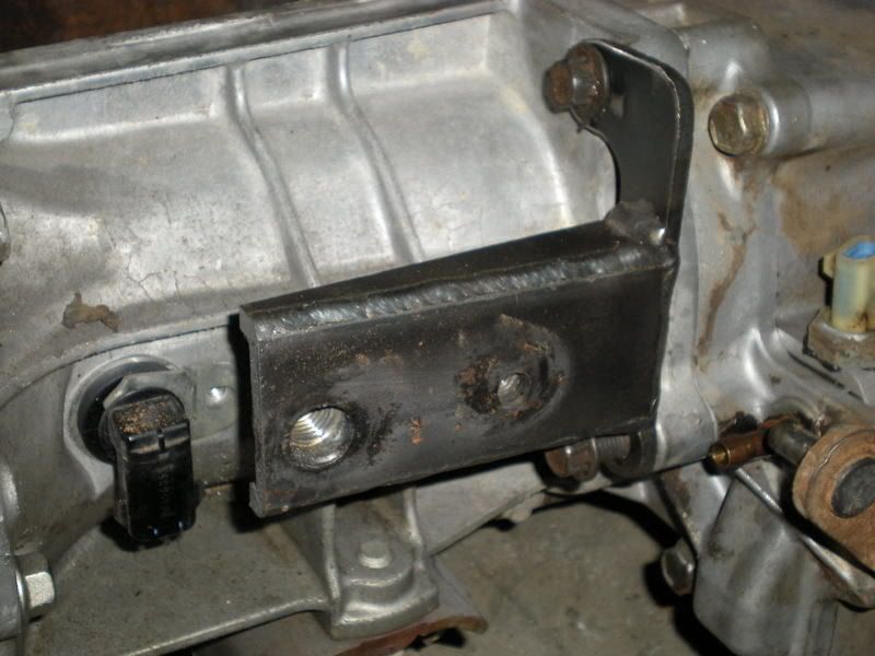

I built my bracket for the X-case shifter today, also added a little "bling" to the shifters.
Threw the X-case on the tranny as a mock up to make sure everything would work correctly, and all looked good. Tomorrow Im going to throw the X-case in the solvent tank and clean it up a bit more. Also hopefully I can get my hands on some ABS and fill the large hole in my heater box.
Maybe Ill be able to get this engine in permanently this week, I guess Ill cross my fingers.
