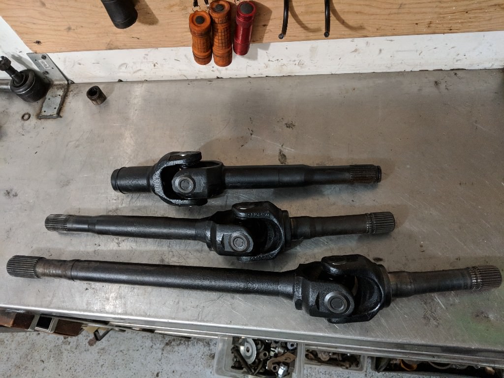

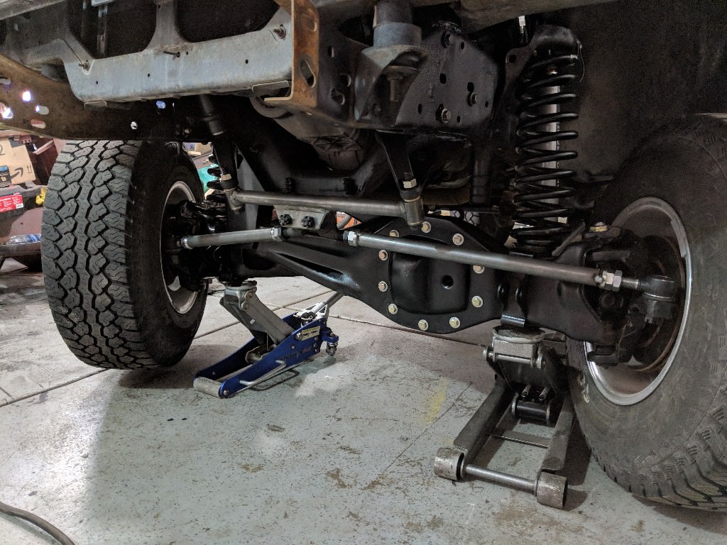

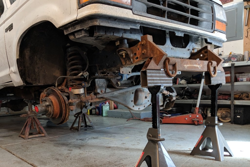

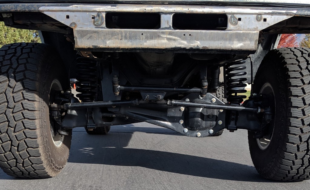

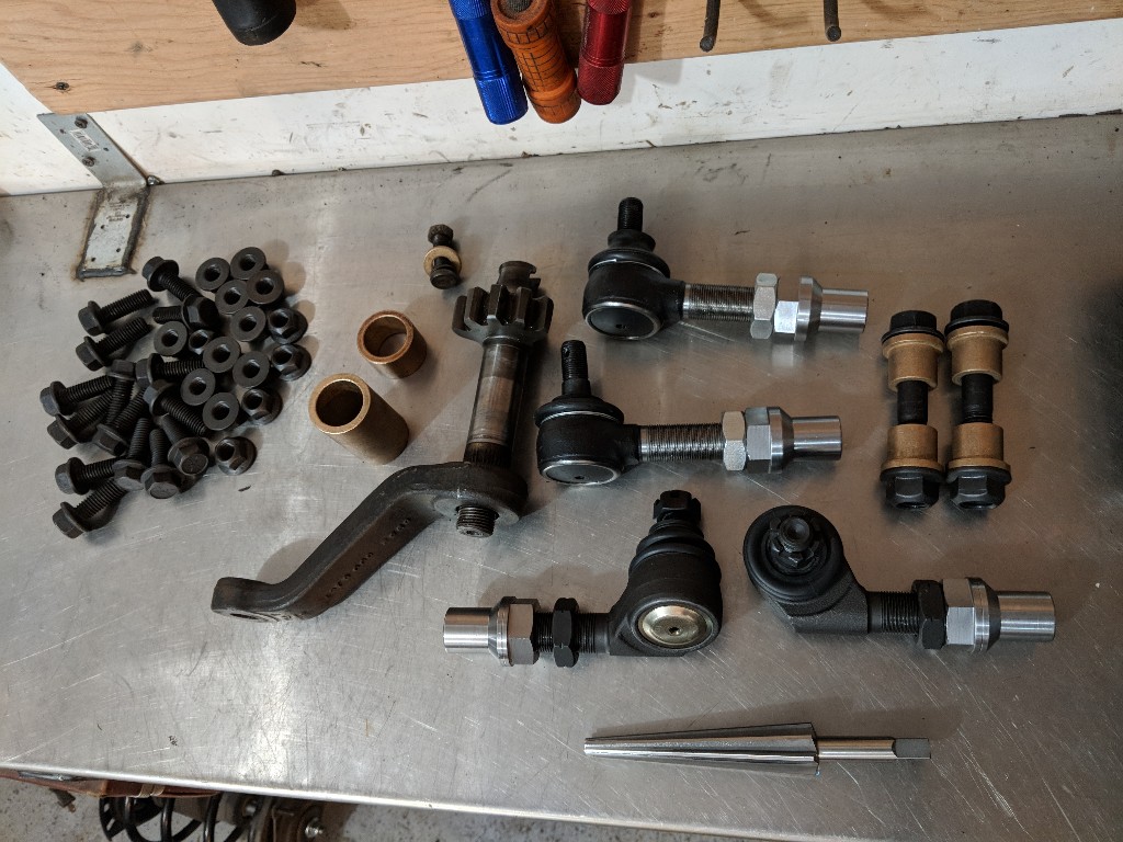

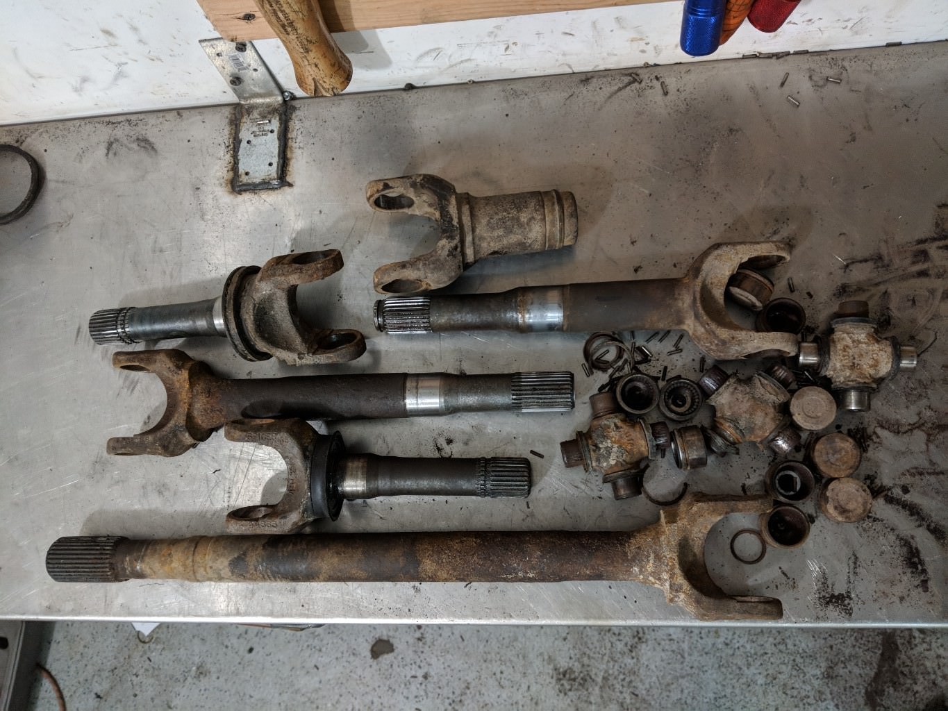

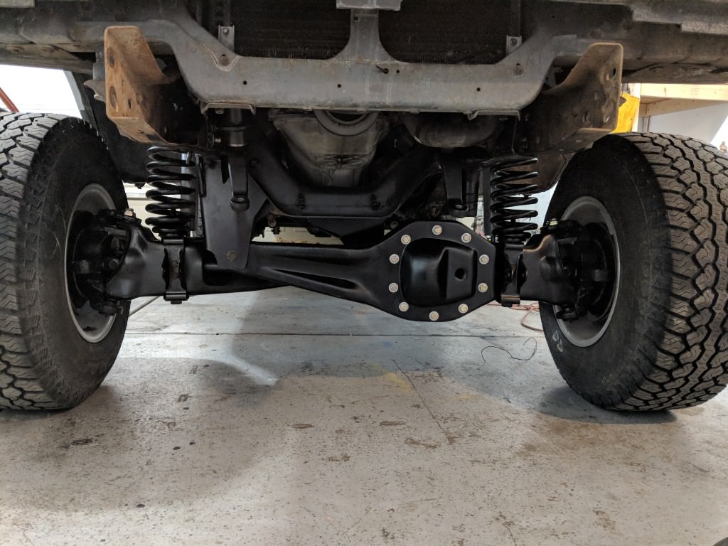

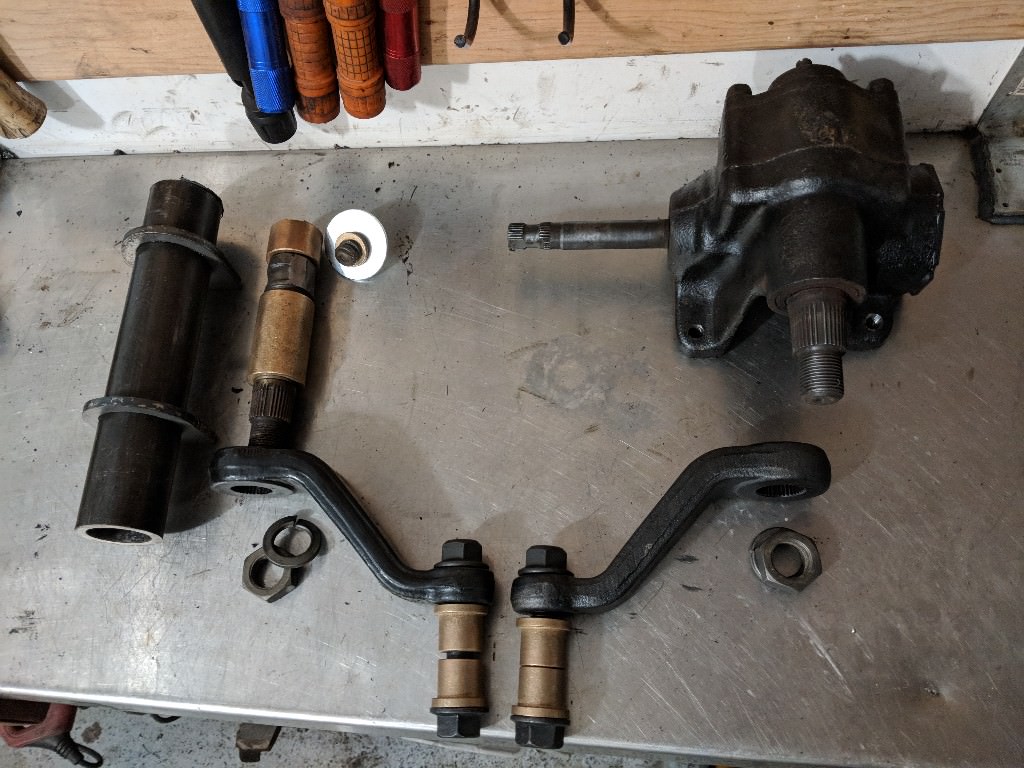

The Dana 28 front axle was replaced with a Dana 35 that now has 4.56 gears and an Aussie locker. BlackBII also came up with a Spindle Lock Nut Modification that you should check out HERE. BlackBII built a custom K-link steering setup, and upgraded to 1-ton tie rod ends. This setup is a beefier than the system Superlift use to offer.

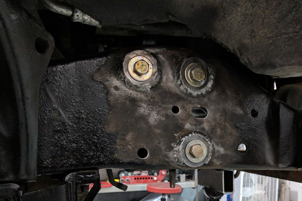

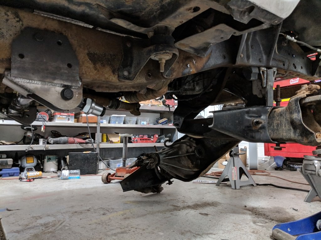

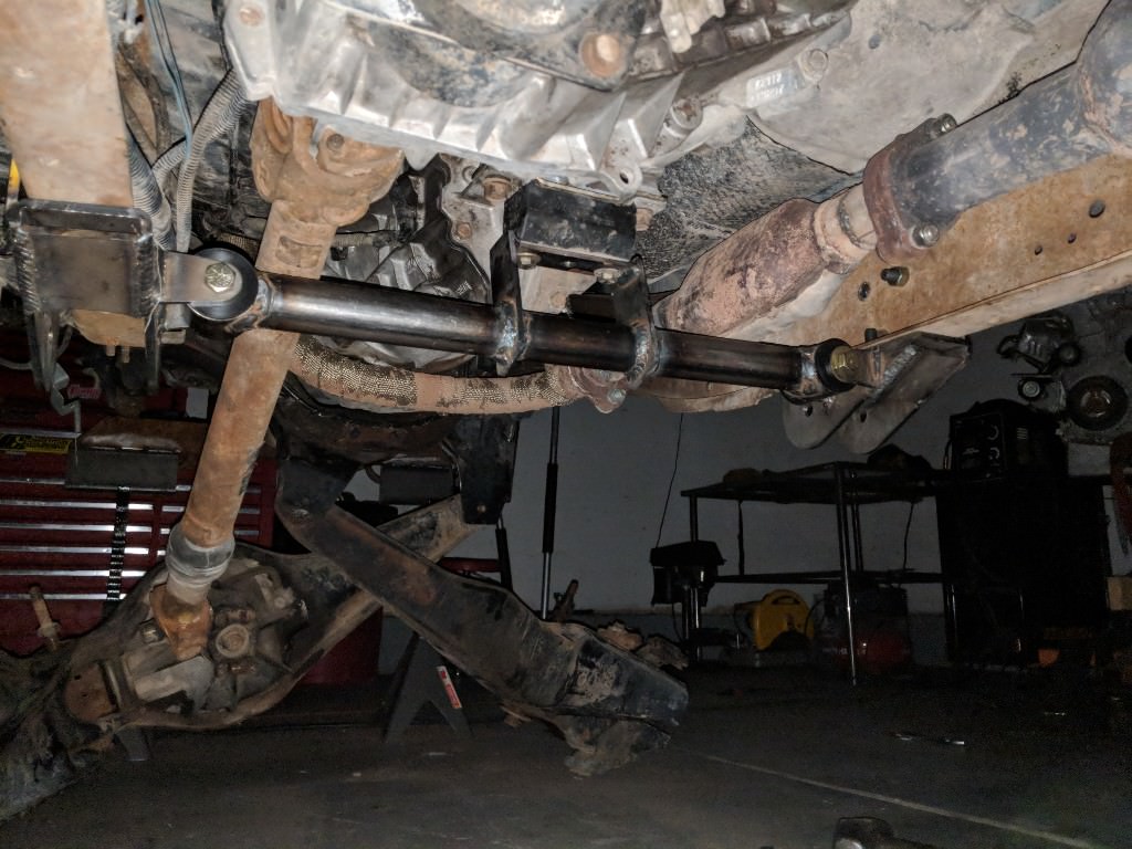

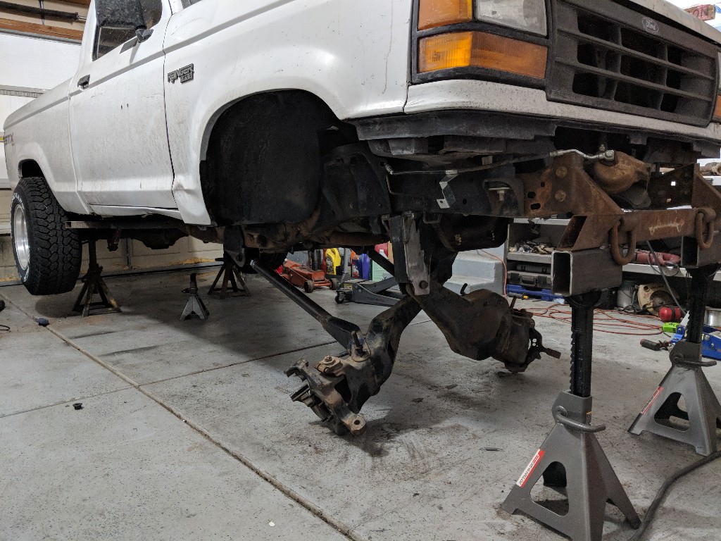

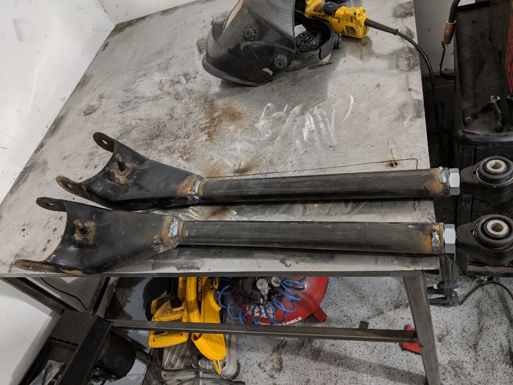

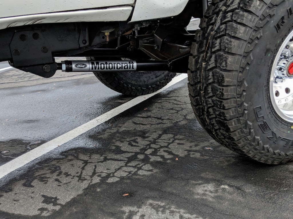

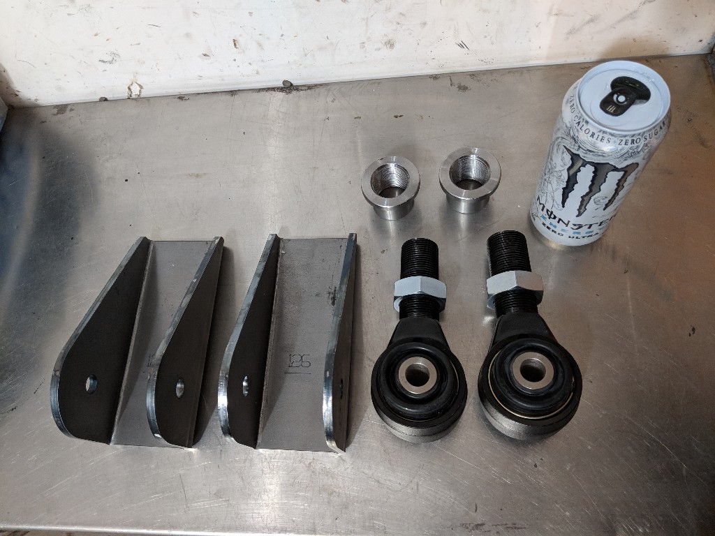

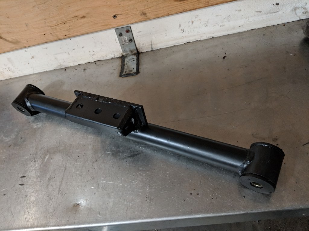

The radius arms were lengthened and feature SPC X-Axis joints. They secure to the frame with custom radius arm mounting brackets attached to a custom transmission crossmember. The ride is smoothed out by a set of Skyjacker M95 shocks (with Motorcraft stickers on them).

The steering has been upgraded to GM electric power steering. No annoying power steering pump whine here. To learn more about his steering set up, check out GM Electric Power Steering Upgrade.
