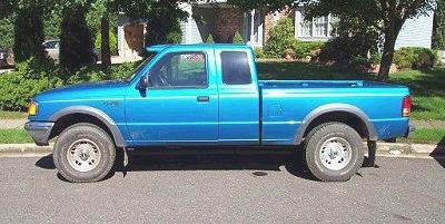

Stock Rangers sit 1-1/2 inches lower in the front than the rear.  Actually, it's not the the front sits down...the rear sits up a little so that once the bed is loaded up it won't sag as bad.  Many enthusiasts don't haul that much and would prefer to have the truck site more level.
