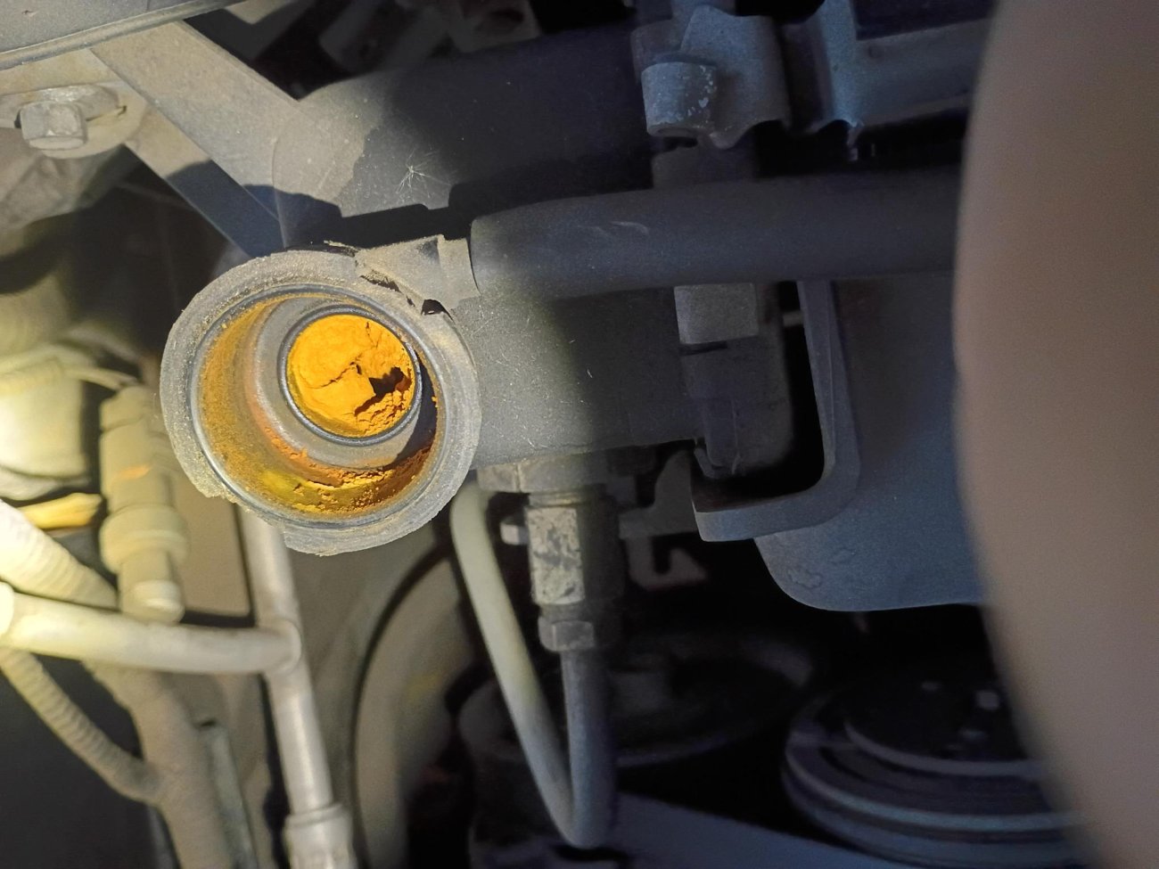

Radiator cap showing what I believe to be rust and the remains of coolant.

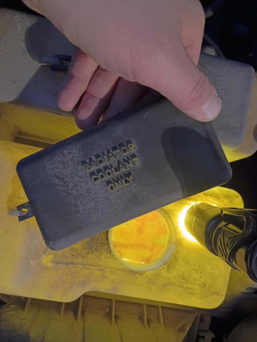

Sad tank where the coolant should be. My father claims "the heater core has blown and the truck runs like shit" but did not know this reservoir even existed.

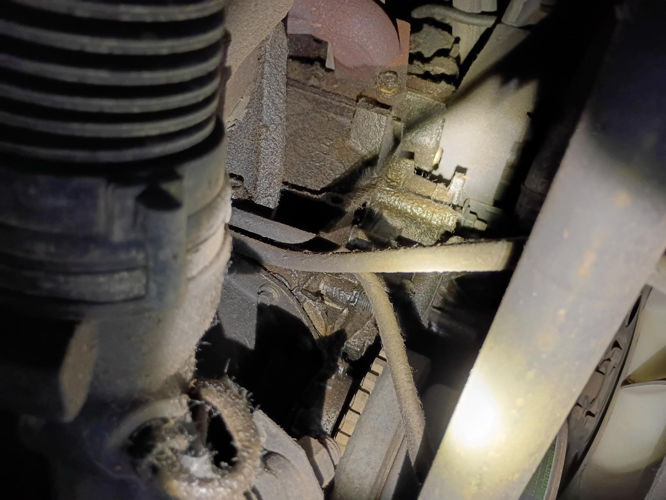

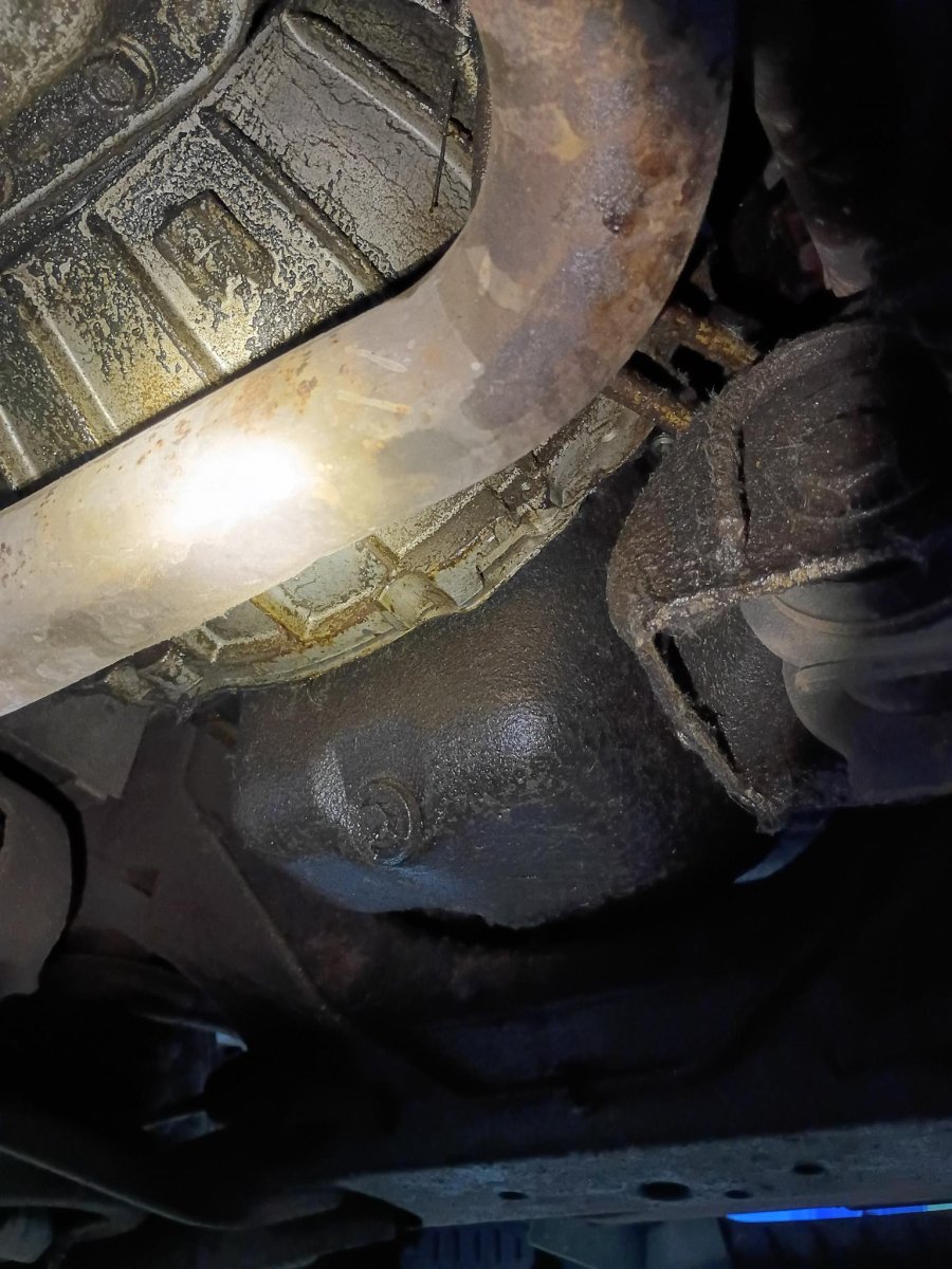

Various views of filth under the engine and transmission. I'm told this is likely "under spray," oil applied to deter salt from corroding the vehicle.
My current plan is to get a new thermostat and fill the radiator with distilled water in hopes of identifying the leak. I'm willing to replace the radiator and coolant lines, but the water pump & seal will be another matter. If and when I upgrade from air cooling to Ford's intentions I'll replace the power steering reservoir, AC clutch (love how it's separate from the compressor!), idler pulley and belt. Fuel system will get some attention, will run the tank near to dry and replace the fuel filter. Maybe run add some voodoo liquids if recommended. I'm willing to excuse a slightly dumb decision as a learning experience.
But... am I missing something? Is this machine worse than I think and some money pit waiting for a fool?

Change the radiator, flush the block, cap the heater core off (for now), fill it up with coolant, change the oil, and see where youre at.

That cooling system is going to be a mess. You will need to flush and flush the engine out. Replacing a water pump shouldn't be too bad if that is all it needs.
I would fill with water and try to run the thing to see where all it is leaking and to see how well it runs.
If it runs ok continue on, if it is has a massive headgasket leak regroup on proceeding etc.

I’d remove the lower radiator hose and pour water through the reservoir to flush it and see if it’s clogged. Might need another engine at that mileage but rust free is a unicorn.
