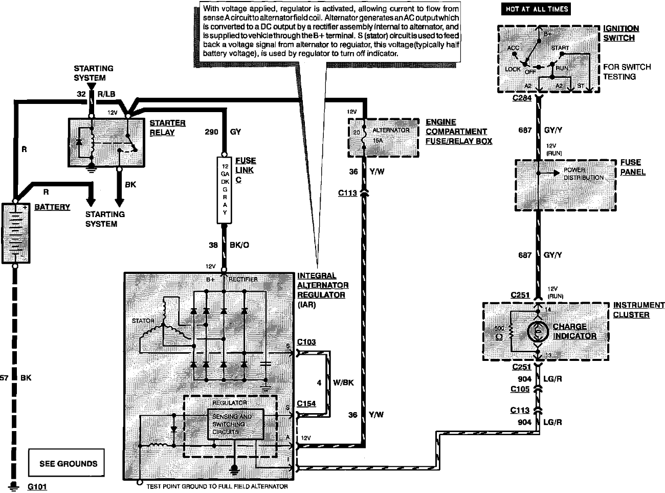

Check the yellow/white wire at the small alternator plug, engine off, key off. You should have battery voltage there. Use the alternator case as your ground for your meter.
This wire is what the regulator uses to monitor the voltage of the truck, and with that information it throttles the alternator output. Sounds like this wire is not working correctly, and the alternator is going wild. 42 volts is too high. With it plugged up, you should get 14.5 when charging. Be careful, you could burn some expensive stuff up with a high voltage, though the battery will try to hold it down as good as it can. But it will start smoking and boiling also if it would actually run.

P.S. I just looked at the diagram a little closer, that yellow/white is fused. Make sure that fuse is good.

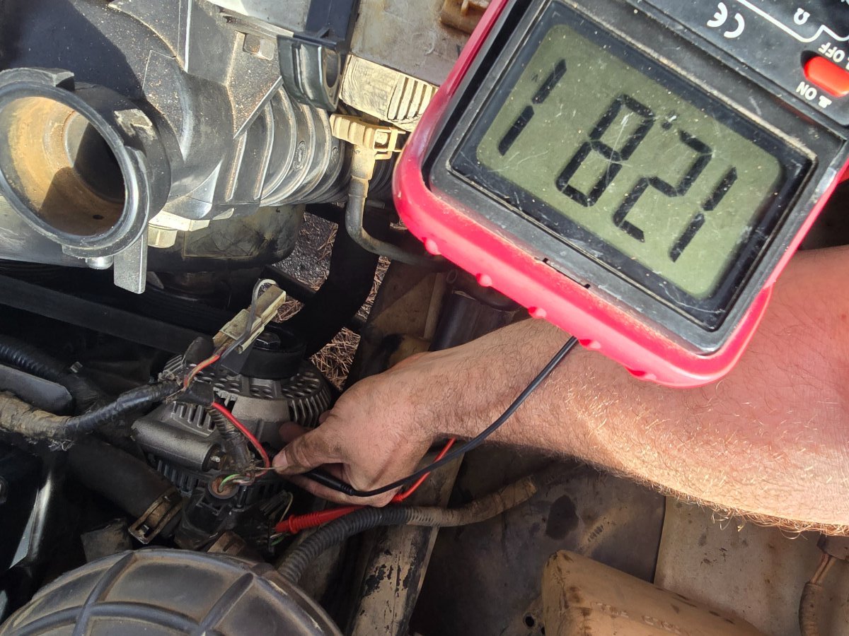

  • Need help on 94 ranger either short or bad alternator or something else
decided to check and see if voltage was going through the main alternator wire had it had almost 42 volts
Check the condition of the B+ wire (the fat one) going to the battery. The only way you would see that high of voltage is if there is no continuity between the alternator output and the battery. Even a full fielded alternator would be unlikely to show that unless the battery was junk...
