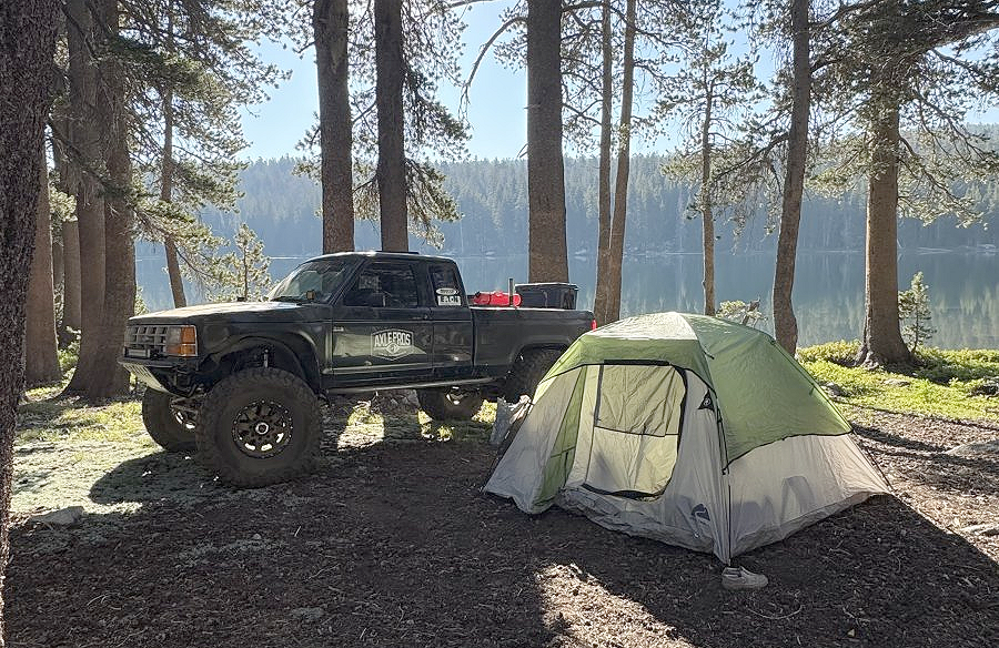

Ford Ranger camping
I don’t believe that you have to have a rooftop tent to be an overlander, just a place to sleep. I still prefer a ground tent.

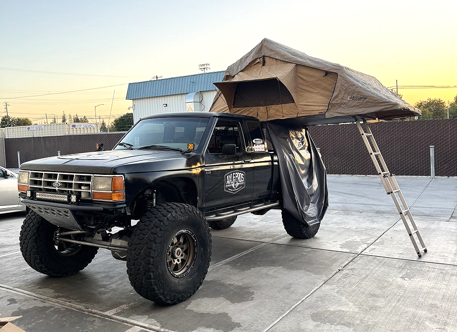

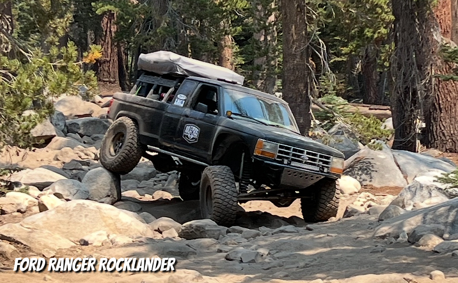

Recommended Rocklander Build: 1983–2011 Ford Ranger
  • Engine: Stock 4.0L OHV/SOHC or a 5.0L V8 swap for more torque.
  • Transmission 4R55E auto or M5OD manual. V8 swaps often use AOD, 4R70W, or M5OD-R2.
  • Transfer Case: Manual 1354 or 1350 with a doubler kit for crawl ratio improvements. Many V8 swaps use the BW4406.
  • Axles (D44): Dana 44 / Ford 9-inch or Ford 8.8, geared to 4.88 for 35″ or 5.13 for 37” tires (see note below)
  • Axles (D60): Dana 60 axles geared to 4.88 (V8 setups) or 5.13 for 37-40” tires (see note below)
  • Lockers: Front and rear selectable lockers. (air locker or electric locker)
  • Suspension: Extended radius arms or 3-link front with coils or coilovers for articulation and load carrying.
  • Tires: 35″–37” mud terrains with beadlocks.
  • Armor: Rock sliders, skid plates (engine, trans, fuel tank), heavy-duty bumpers.
  • Recovery: 9,500–12,000 lb winch, recovery straps, traction boards.
  • Overland Gear: Rooftop tent, ground tent, camper shell, water storage, dual battery system, fridge/freezer, extra fuel capacity.
  • Interior: Secure storage for tools, spare parts, and camping gear.
This setup keeps the Ranger small and nimble enough for technical trails, but capable of carrying enough supplies for long weekends off the grid.
Note: I know people like to replace the Dana 35 TTB with a Dana 44, but if you’re going to use 37-inch or larger tire you should consider a Dana 60 instead. Yes, you can upgrade the Dana 44 and make it stronger for the 37’s, but why do that when you can just get a stronger Dana 60. The Dana 35 TTB can handle 35-inch tires and probably 36-inch tires if upgraded to Dana 44 spindle & hub assemblies.
Ford Ranger Rocklander

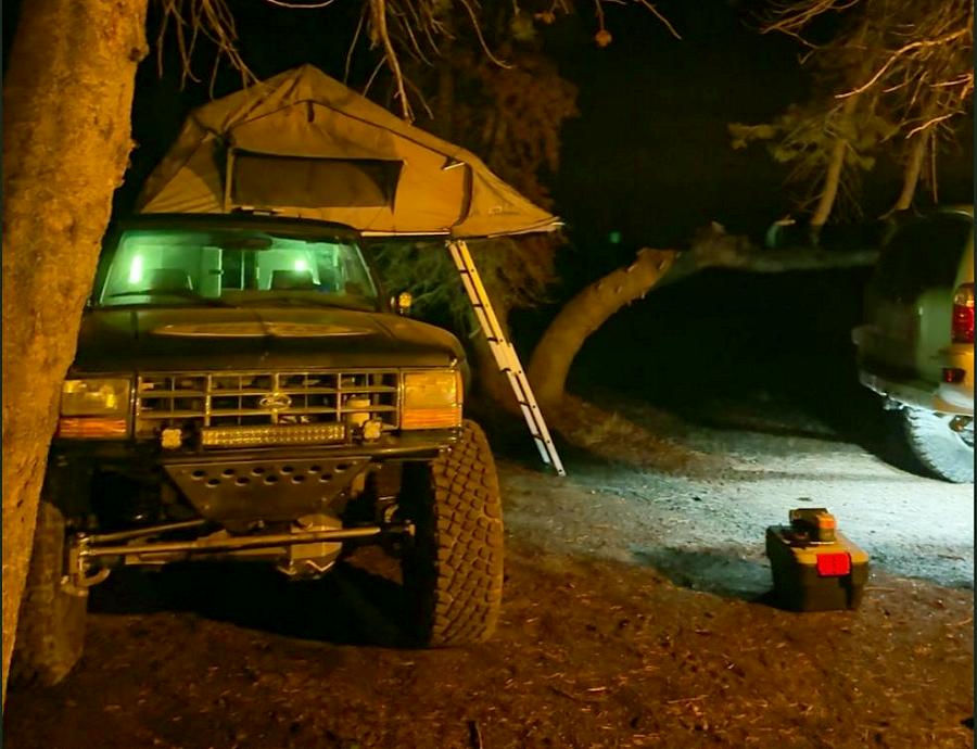

Rocklander camping

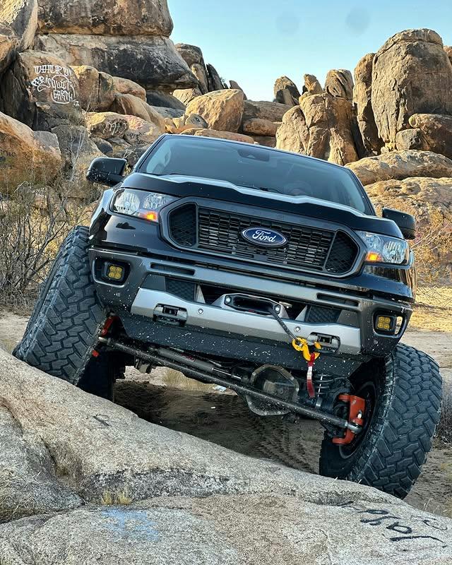

2019+ Ford Ranger FX4 / Tremor: Dana 60 Swap
  • People have swapped Dana 60’s into the 2019+ Ford Ranger enabling it to run 37-inch tires.
2019 Ford Ranger on Dana 60's

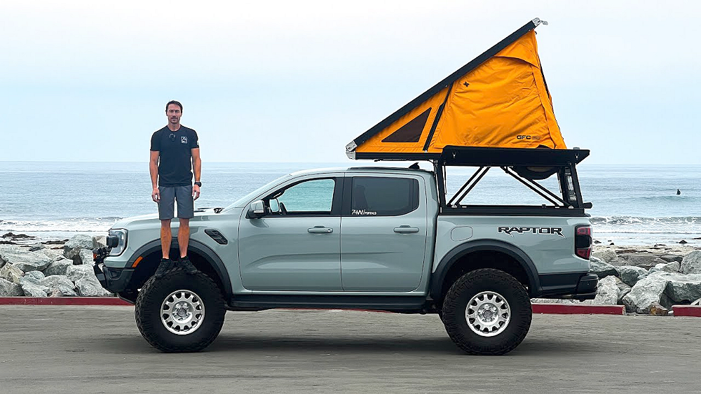

Ford Ranger Raptor: Portal Axles
  • A Ford Ranger Raptor can be upgraded with a set of 74Weld 4-gear portal axle kit (originally built for the Bronco).
  • With portals installed, a Ranger Raptor can fit 37-inch tires, combining clearance and gearing advantages.
  • These portals only fit the Ranger Raptor M210 front axle, and not the M190 front axle on the non-Raptor Rangers.
Weld74 Ford Ranger Raptor on portals
