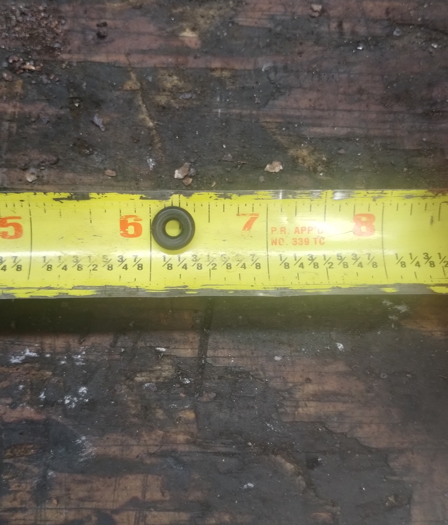

Just sanity-checking: there's no o-rings this small in our trans or transfer cases, right? I'm like 95% confident I haven't seen one of these before, and I don't see it in the manual or rebuild kit pictures, but it ended up near my head when I was bolting the cat back in just now.
It could be from any of 1000 other things going on in this truck or my garage, but I want to make sure it didn't fall out of what I'm actually working on.
'95 Supercab Rehab - Dumb Questions Thread
Only O ring I can think of that size is at the master cylinder end of the clutch line if you pull the roll pin...

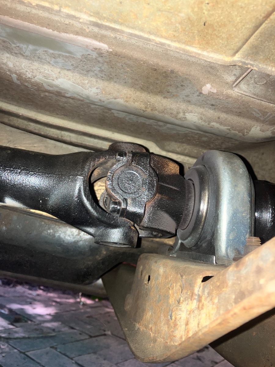

I crawled underneath the truck this morning. Lincoln was licking my face, but I was still able to get a couple pictures.
Rear side:
Front side:
Remember, this is the way the professional driveshaft shop installed it. That dust shield ring is on the backside, between the bearing and the yoke.
Hope it helps

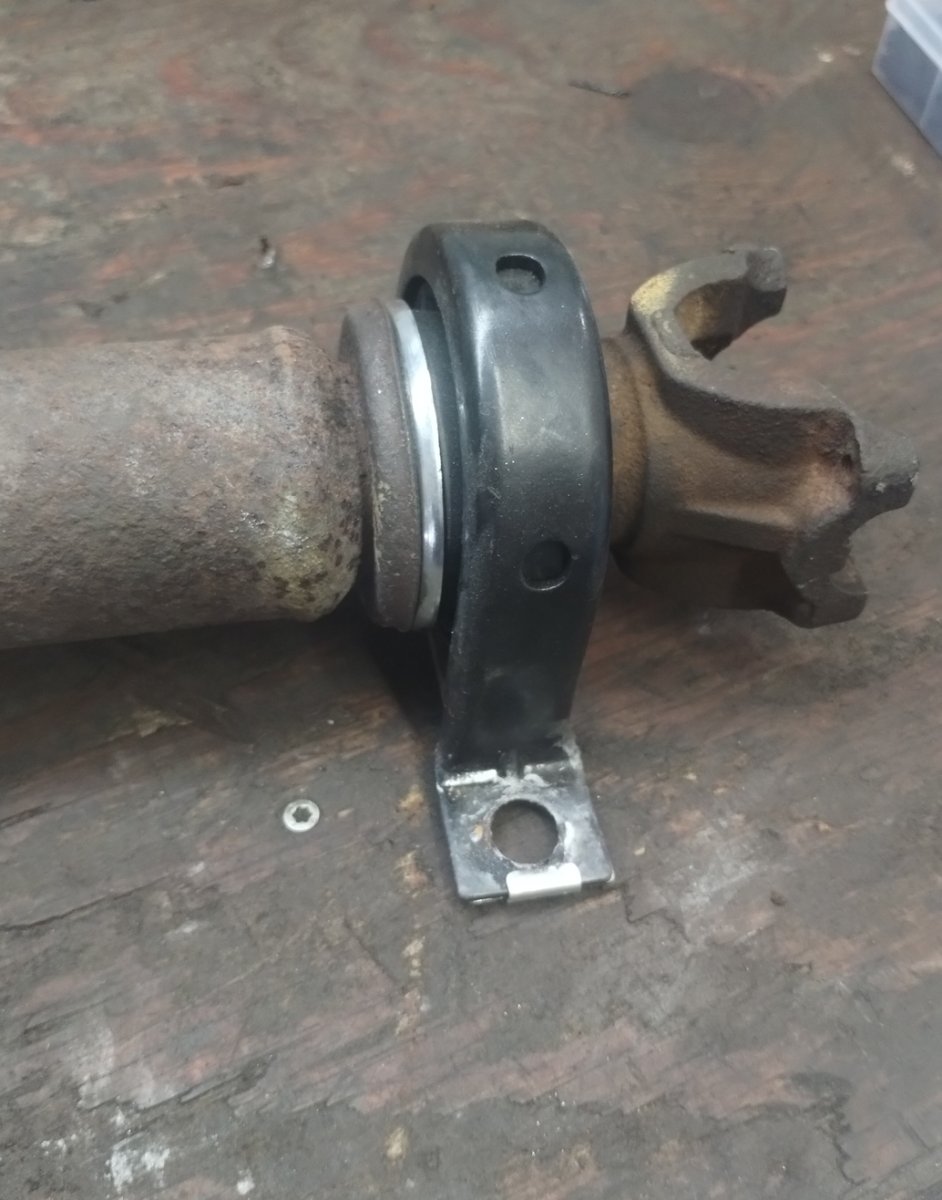

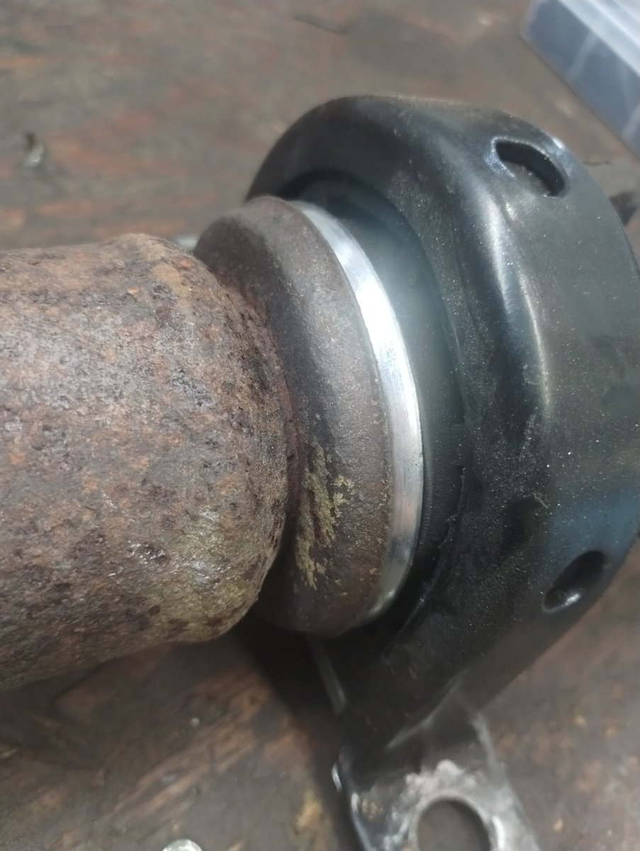

I just got my driveshaft stub back out and on the bench. Waited until I had time to mount 31"s and a 1" BL on the bed to give myself a bit more room to work.
'95 Supercab Rehab - Dumb Questions Thread'95 Supercab Rehab - Dumb Questions Thread
This is what I'm working with. The rusty bit the redneck in that youtube video called the "slinger" is at least press-fit on the driveshaft and always spins with it 1:1. The dust shield I assumed would also be sandwiched in between the slinger and the rubber, but my bearing is bottomed out and the shield still has barely enough room to wiggle back-and-forth on its own, which I assume is my squeak.
There is a ton of room on the other side between the bearing and the yoke. I would need to deliberately not bottom out the bearing to even have a chance of holding the rear dust shield in place. I'm thinking I just run without either shield.
Hopefully the shaft fits through the beam in my tiny press with the flange adapter u-joint at the other end removed, because I don't see how I could get the bearing off non-destructively otherwise.
On yoke alignment, the yokes at each end of the shaft are meant to be in-line with one another, right? So there should only be two possible alignments: in-line one way, and then exactly 180° around the other way? Or is that not correct?
I think you only need one of those slingers or dust shields or whatever you want to call them. I would recommend reusing the old one. I just did this on my wife's 95 and the aftermarket piece was just barely a press fit. It started spinning on the shaft within a couple miles (frustrating because I bought the good Dana part... junk.) I had to disassemble it and put the old one back on. Two are not needed. IIRC it was oriented with the dust shield towards the front of the truck so that dust blows off it as you drive forward.
As far as removing the bearing: I just use a two jaw puller to remove it. Very easy. I think I just pressed the bearing on as far as it would go and that's where it was at before. Think I just used a socket and a hammer to drive it back on... it was not a super tight press fit where the shop press would have been needed.
As far as yoke alignment - it should go back the way it was before, that's how the shaft was balanced. I'd imagine the yokes should be aligned with each other but I guess it could have been balanced either way.
Yeah, I used a bearing separator. Press just pops the rubber off the bearing itself.
I see how it's supposed to work now: the rusty shield and the new shields are supposed to be the same part, but the new one has a greater inner taper up to a major ID ~0.08" too large to press onto the shaft. The bearing cage has a lip that could fit together with the shield and restrain it, but they're ~0.4" shy of actually snugging up, even with the bearing bottomed out. Ditto for the forward lip on the rubber.
I'm not sure if aftermarket parts aren't meeting tolerance, or there are subtle variations in Ranger shafts by drivetrain, etc. and they're just selling the most common size, or what, but it sucks that even the Dana parts have this problem.

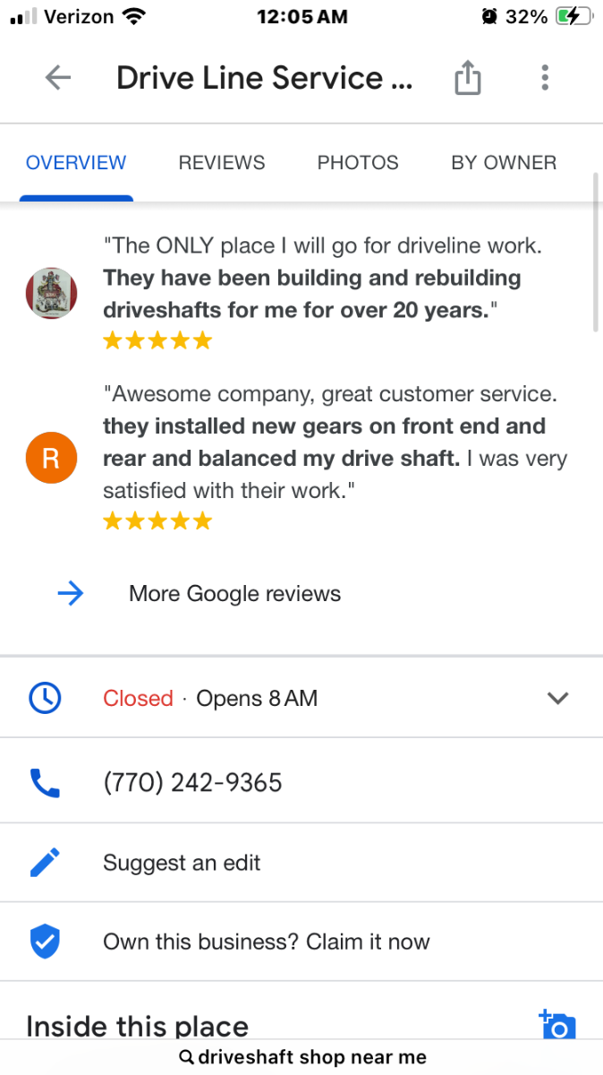

These are the guys who corrected that for me: doraville Drive line and spring
They are really nice professional guys. I’m sure if you call them up on the phone and tell them you’ve got this problem and they were recommended. They can walk you through the steps.
