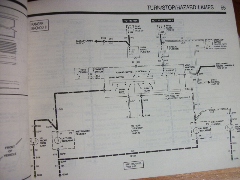

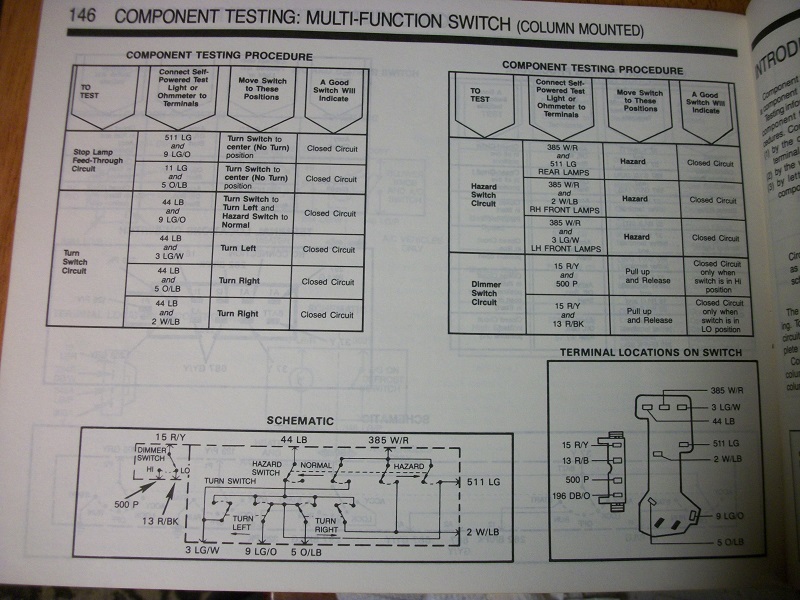

Here are are the wiring schematic and troubleshooting pages from the factory manual:

In the schematic you can see how the stop lamp circuit routes through the multifunction, because the turn signal and hazard functions shares the same output circuits to the lamps. If only the stop lamp function is not working, I'd be looking real close at the input terminal from the brake pedal switch, the splice S218 and the plug at the brake switch.
The wiring manual is called an EVTM, and can be bought off eBay, cheaply if you're lucky or patient.
