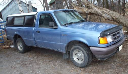

The first thing I ask myself when looking at a truck is: “where is the coolness factor here?” What is it about this truck that gets my attention? What has the owner done to deserve recognition? Most of the time, as with last month’s solid axle swap, you can see it. But not always. If you’ll remember the editorial last month, I said that it is the functionality of the modification that impresses me, not the appearance. This month’s feature truck (owned by forum user buddy448–we’ll call him Andy) is a perfect example of that philosophy. In fact, it is so perfect an example, that you can’t even tell it’s modified by looking at it. Well, until you open the hood. And that is where the WTF? factor comes in.
Maybe you are expecting me to tell you this truck has a 300hp small block or a twin-turbo V6 packed inside its mundane body. Nope. Nothing of the sort. And it is the absolute functionality of it that impresses me. Because under the hood of Andy’s ’97 2wd Ranger is a naturally aspirated, indirect injected Nissan SD-22 4-cylinder diesel engine pulled from a 1982 Datsun pick-up. About a 90hp trim off of the stock 3.0 V6 that came in his truck. And why? It’s all about gas mileage, Bubba. Try 37mpg!
Reading through Andy’s description of the swap, it seems pretty simple. But there are a couple of indications that his fabrication skills are well above average. For instance, he machined, welded and balanced his own driveshaft. That is something $100 or so would take care of at a driveshaft shop, but that is a lot of gallons of diesel oil if economy is your goal. So, he did it himself. The rest of the swap is just careful fitting and clever thinking. Nothing spectacular.
Since the Datsun transmission placed the shifter further back, Andy trimmed 20 off of his 60/40 seat and made a plate for the new shifter. The hole for the original shifter was plated up, and a mechanical fuel cut-off lever was installed there to shut down the engine. All of the Ford gauges now sense the Nissan engine’s vitals, and the Ford clutch master now operates the Nissan clutch slave. He was forced to give up his power steering in exchange for a manual steering box as there was no way of putting the pump on the diesel. No big loss on a truck with functionality as Job One.
Because this is Andy’s second Ranger with the Nissan diesel in it, (the first being an ’88 that he converted 8 years ago and drove into the dust) I have to believe the swap is well worth it. Certainly the 50% plus increase in fuel economy would pay for the swap in no time flat. Not to mention that the motor and tranny you pull out are probably going to sell for more than the price of the ones you put in. The main problems are that you have to be lucky, as Andy was, and find a low mileage engine. You also need to live in an area where they don’t require an emissions check. And, lastly, you have to get used to highway humility, as 60hp is pretty meager in a 3,200# truck. But it is enough. And as a final proof to myself that this is a vehicle worthy of praise: I have spent more time looking at these few pictures of Andy’s truck than I have spent looking at the hundreds of Spring Round-Up pictures people have put up. Maybe I’m crazy. ~TRS
