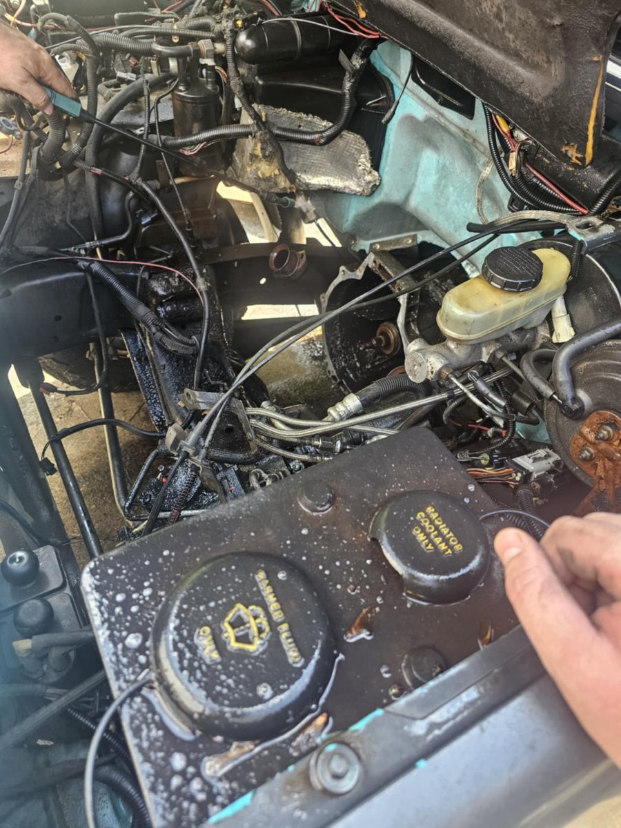

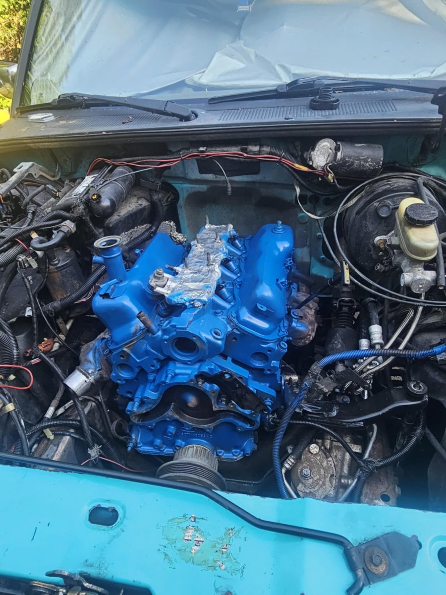

Here is a before of the engine bay
92 Ranger 6 Cyl 4.0 4x4 Manual Build

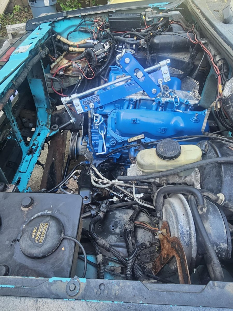

Here is an after
It's not perfect, and she does have a little rust but over all the body/frame is in pretty good shape. No undercarriage rust

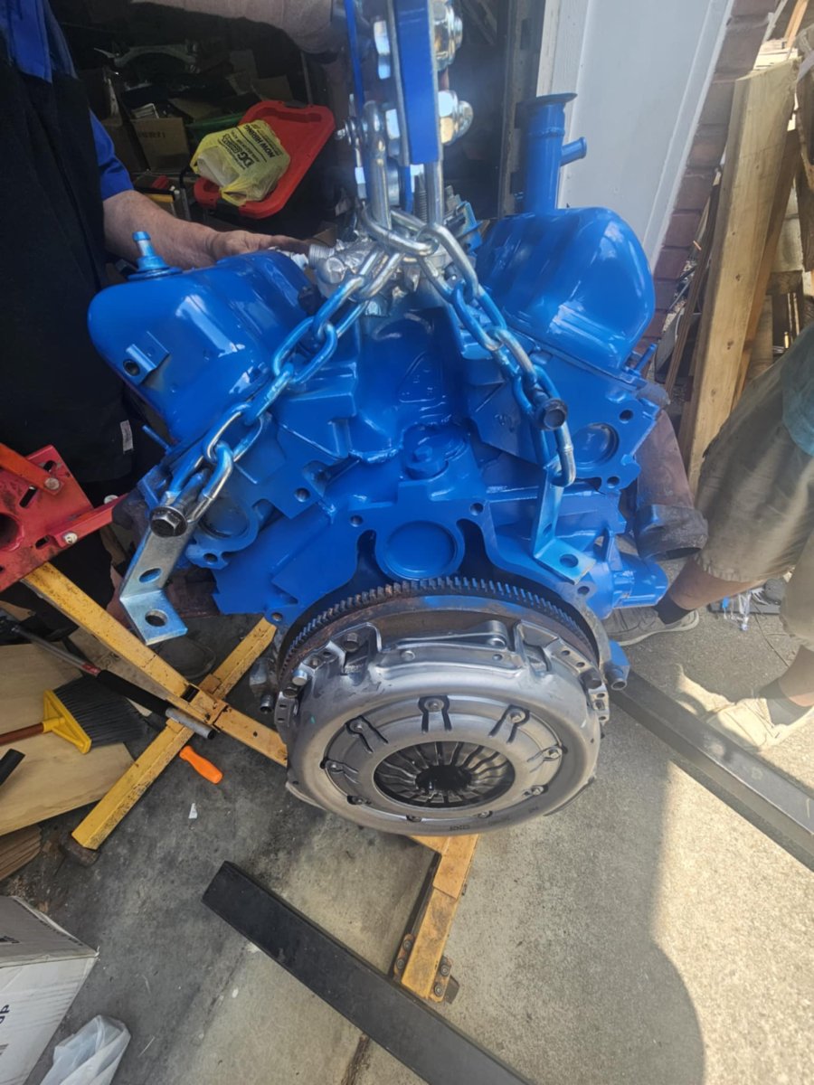

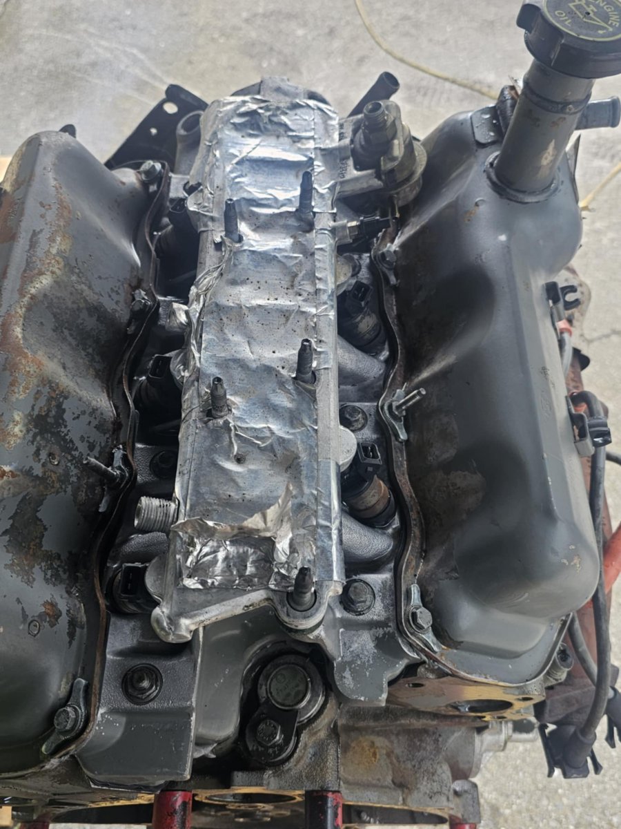

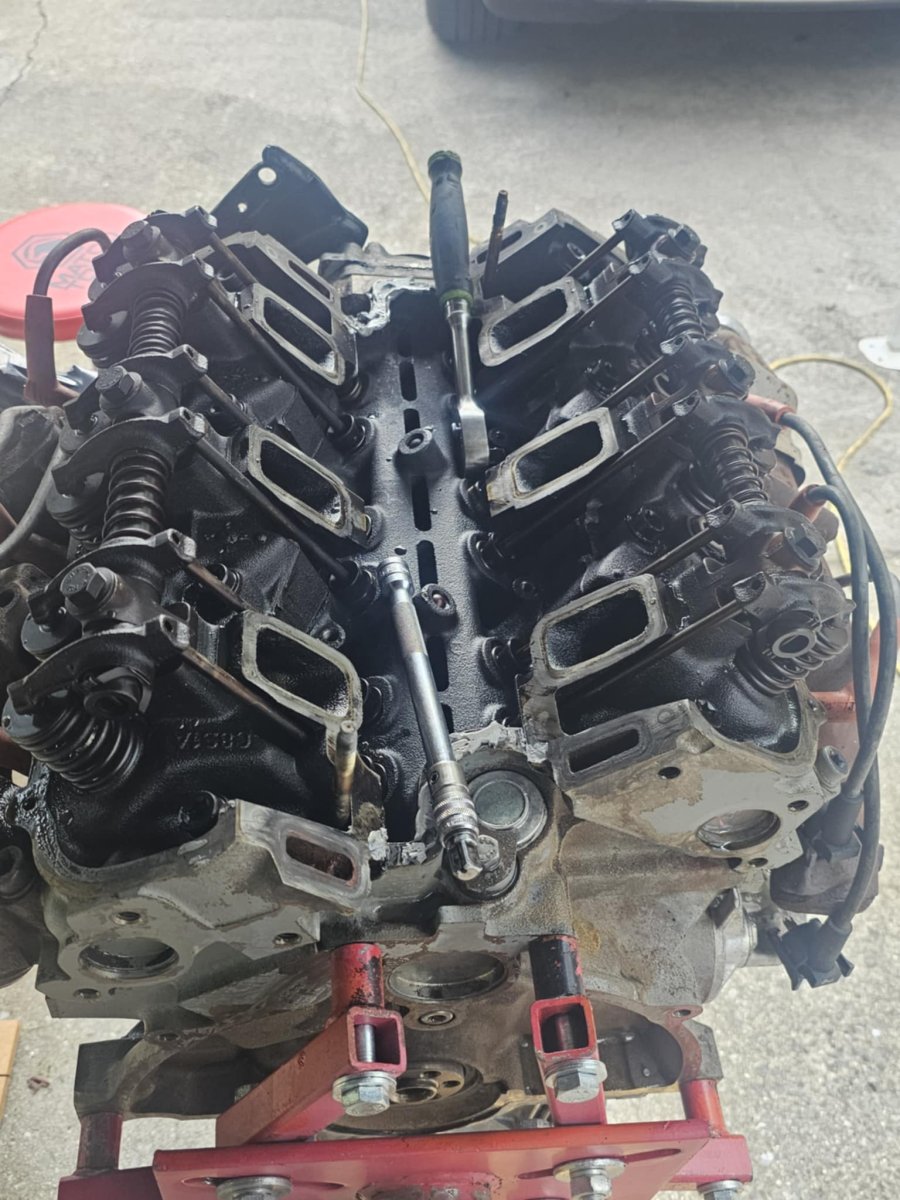

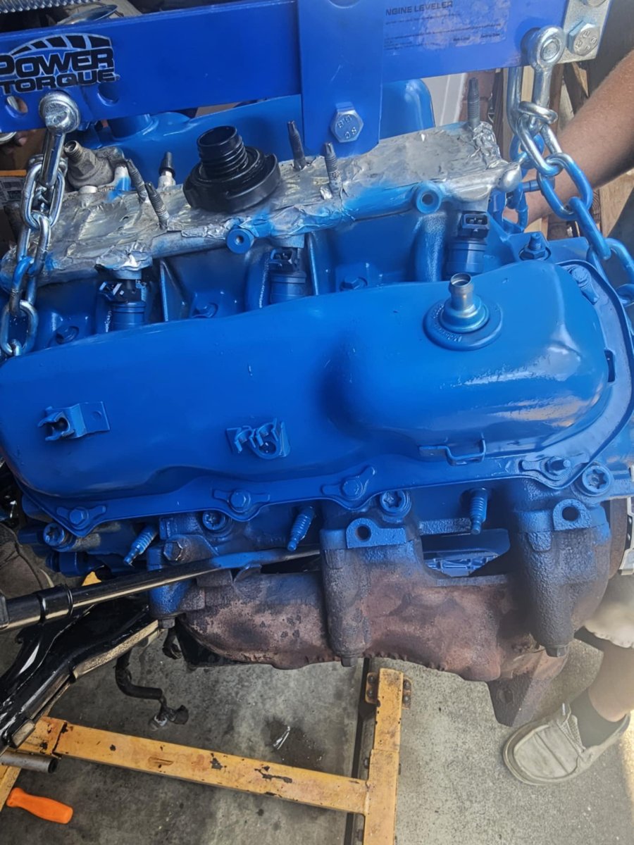

Stripped the engine down and resealed everything, new gaskets, new clutch kit, and gave it a fresh coat of paint

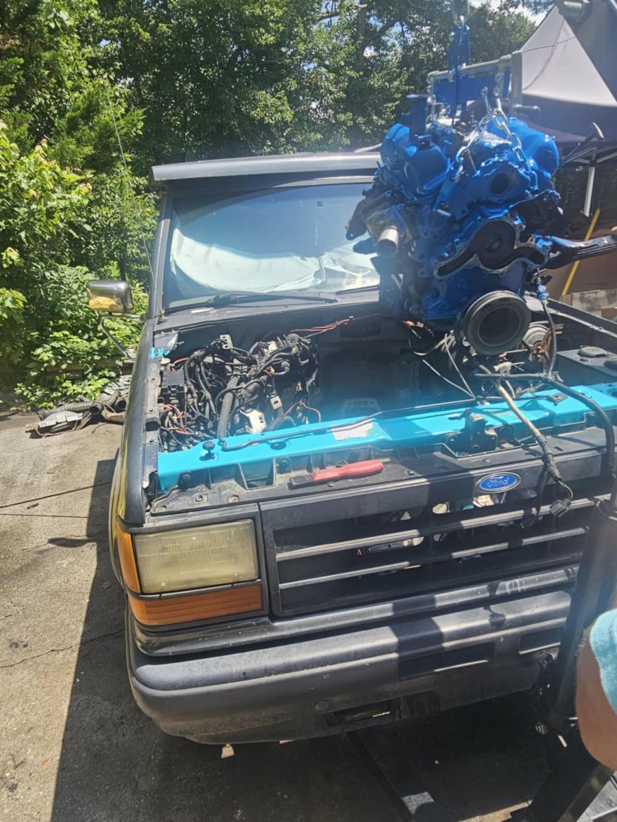

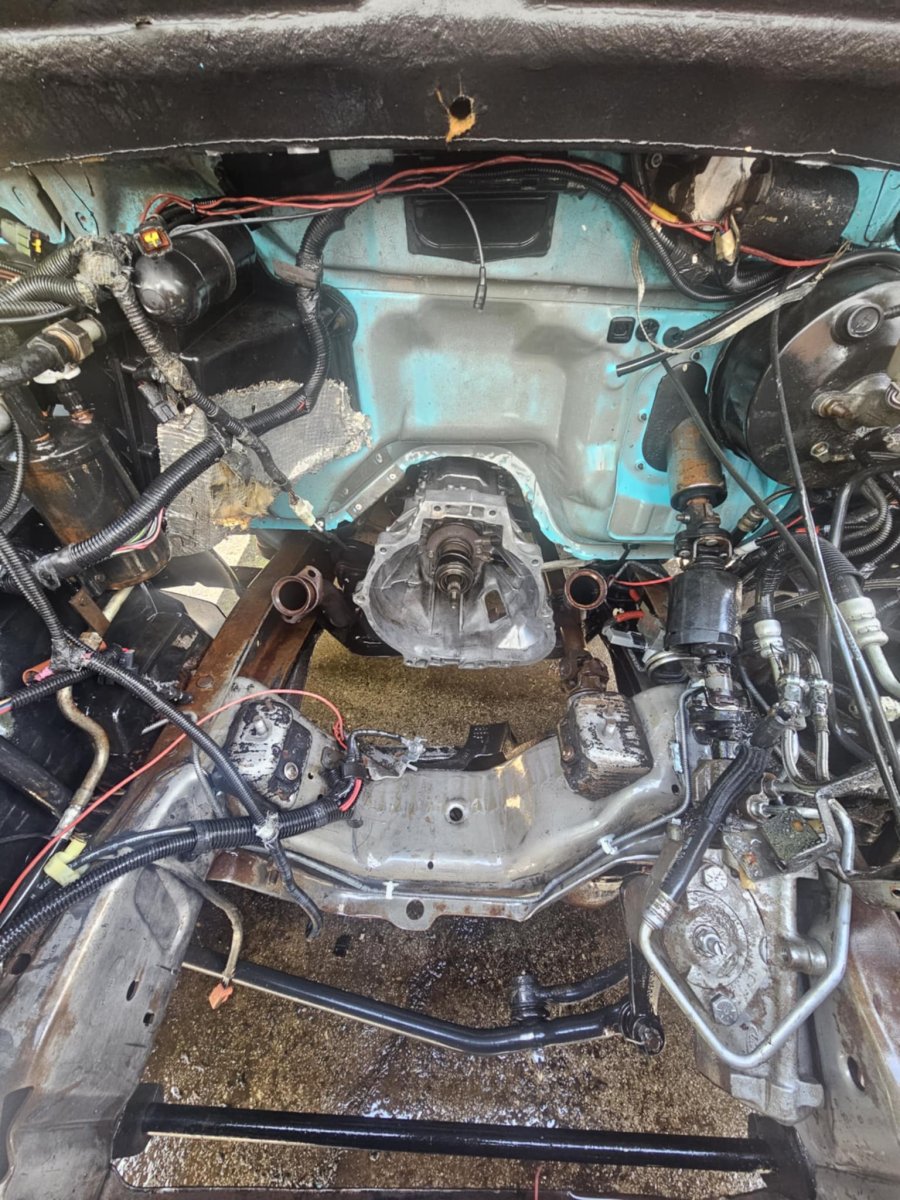

The fight this thing gave us going back in and lining up... All whilst 99 degree direct sun was cooking us righteously.
We got it in and connected to the bell housing before calling it a day.

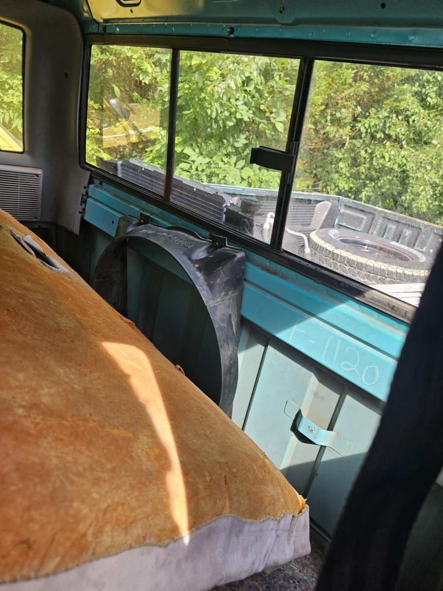

The headliner I have is a pink/biege color? Idk, came with the truck. Anyone have any thoughts on how to dye it a different color?

I got my head liner material from a interior shop, most will sell the material you need. I have the glue and material, just not excited about pulling all the trim to get head liner out. This heat is slowing me down as well.

The buddy I bought the truck from had planned to restore it, and had already purchased like... 90% of what was needed. While the cabin is currently stripped, there is a brand new formed carpet as well as headliner for it. The carpet is a nice dark blue, but for some reason the headliner is like a peach/pink color. I'm wondering if I can soak/dye it while I have it out, or if it would be easier/better to just get a new piece of cloth to put over it. I'm waiting for my dynamat to come in so I can insulate the whole cabin before I start putting things back into place.

If it was me, I would just get some black headliner material and cover over the funky peach material.
Or take it to an upholsterer and have them do if you're not confident in doing it yourself.

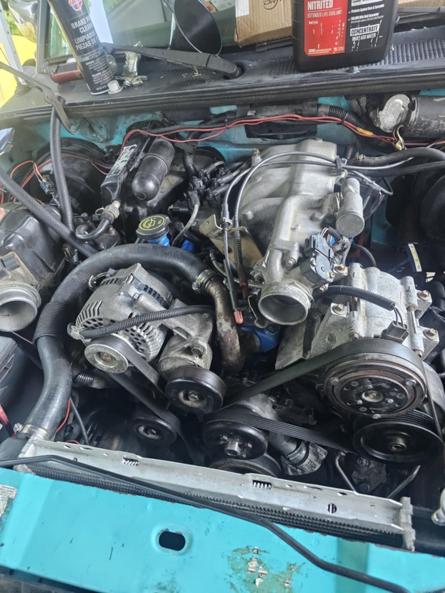

It's been a long few weeks.. Some updates. We got the majority of the engine back together and wired up, there's still a handful of things that need to be tidied up engine bay side, but when we turned the key she roared on the first try. Talk about an adrenaline rush!

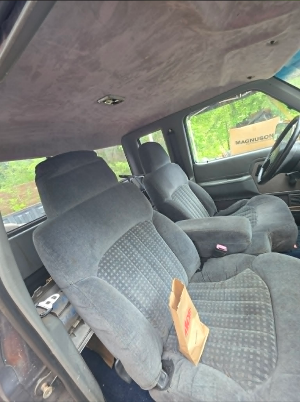

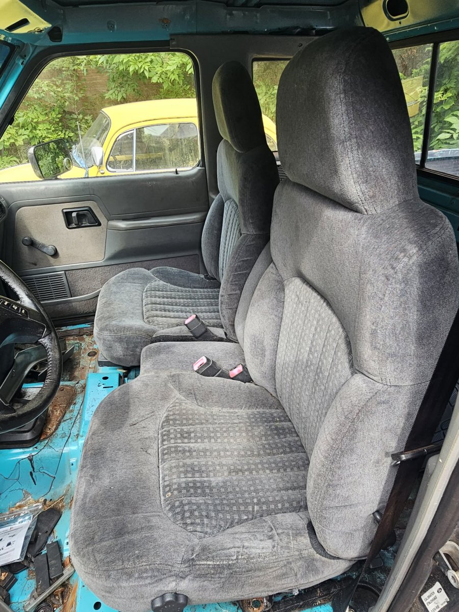

This weekend I plan on starting to tackle the inside... I made a trip to the junkyard this past weekend, and I may have found a new addiction because I've been to 3 more in the past 2 days. This one yard near me had got in an 89 and also had a 91. I pulled the vacuum hose assembly from the 91 and some odds n ends from the 89 including some nice Ranger Custom badges. Yesterday while there, I stumbled across an old old old chevy, I want to say s10 (similar size to my ranger) but this was so stripped down I couldn't really tell. But what shocked me was that it had 60/40 seats still in it, in immaculate condition. After much blood, sweat and profanity I managed to get them out of it and after I give them a good cleaning will eventually find it's new home in my ranger.

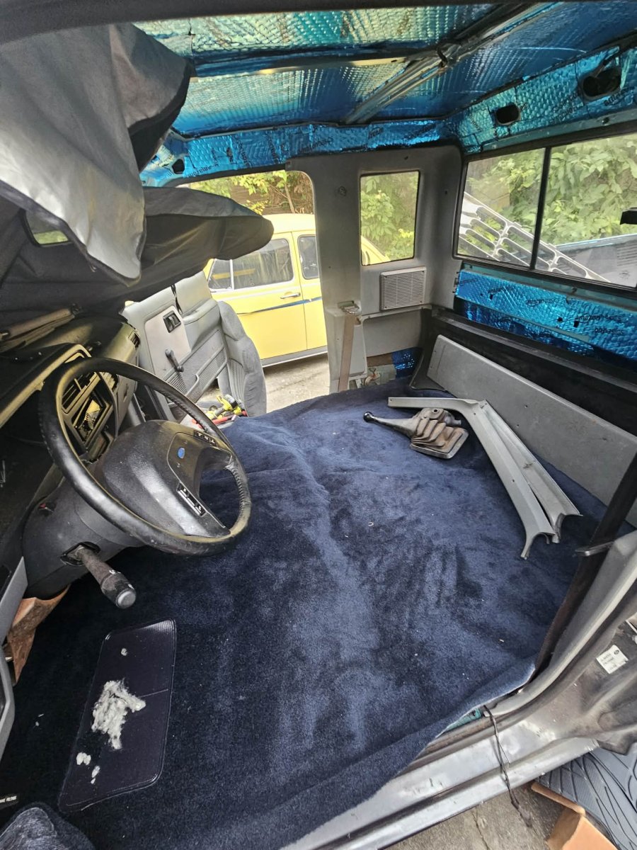

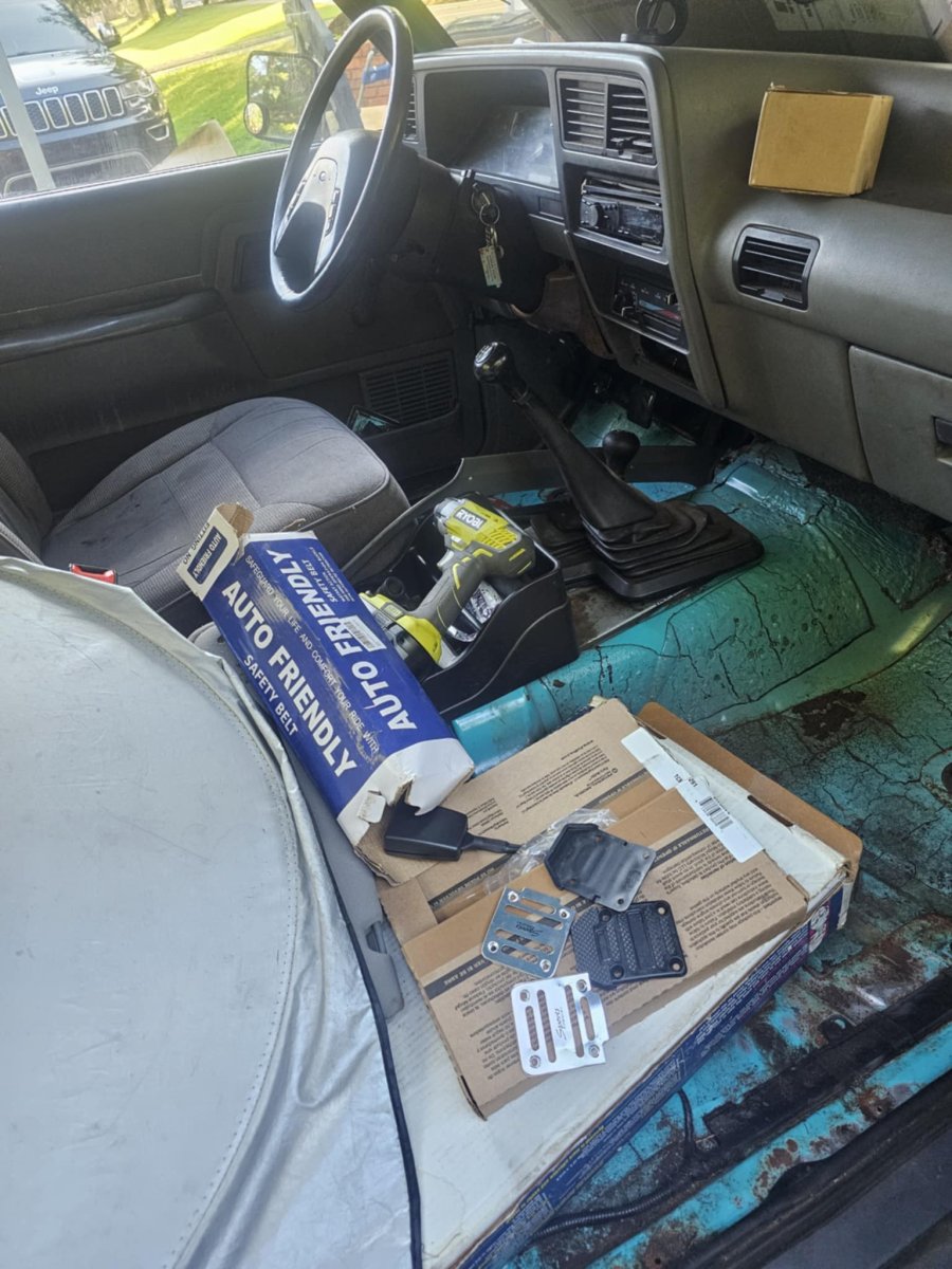

Here's a few interior pics, like I said before, it's stripped down and right now it's ugly, but I've got some wire brushes and elbow grease and I plan to get this nice and cleaned up before running all the sub/amp/speaker wires and putting down the carpet.

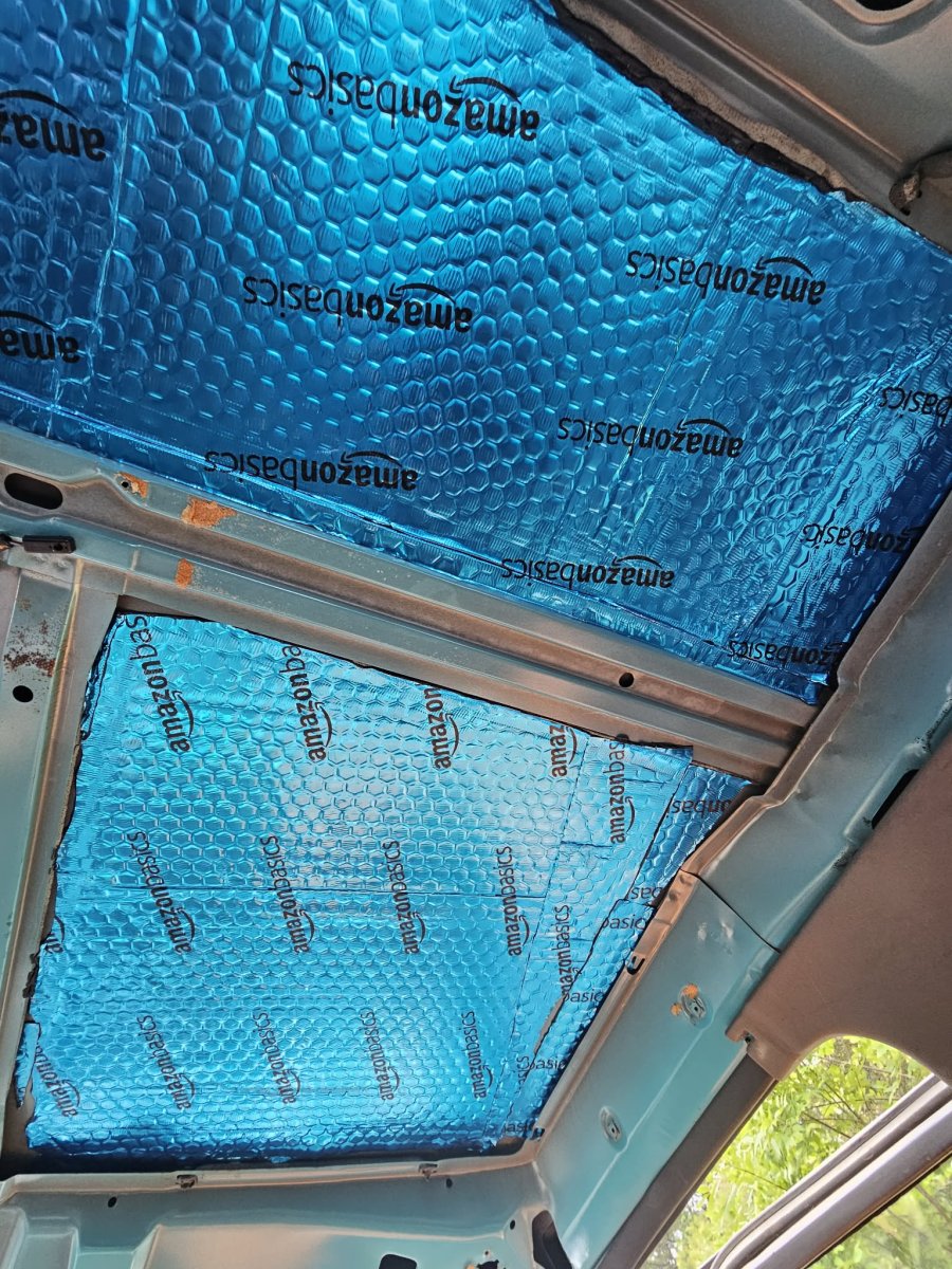

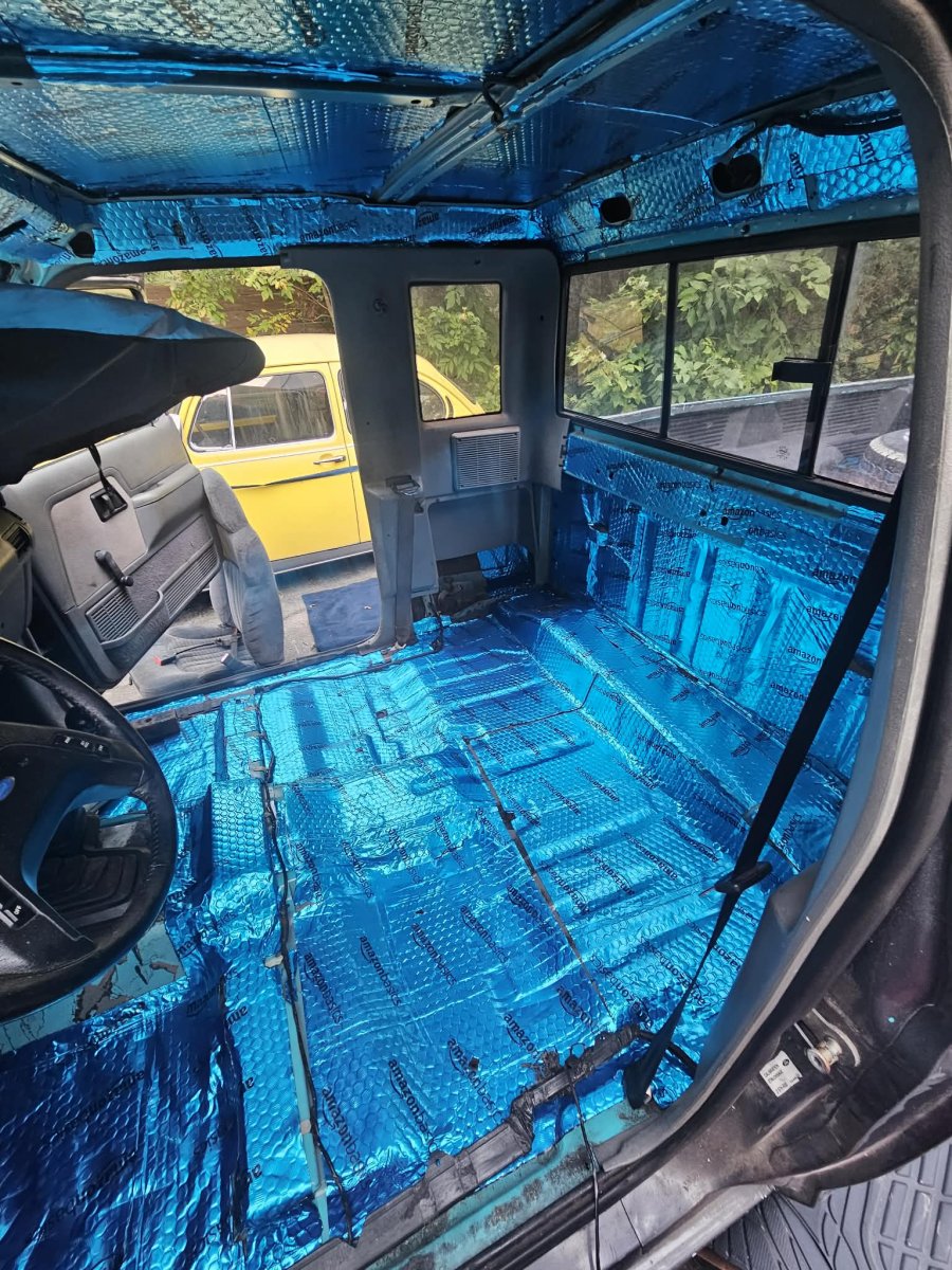

Necroposting my own post lol. It's been a long and arduous journey... and it's still not done. Need to replace the wiper motor and the evap core. Hopefully in the next week or so. Got the entire inside sound deadened. I've always been a dynamat person, but I will say for the price this stuff works great.
After that, it's wiring up the sound system and properly securing the carpet and trim.

Fought with getting the seat tracks onto these seats... Pulled the seats out of an old s10 I found at the junkyard, but I think they came from yet another different truck. So getting them to line up was quite a challenge.

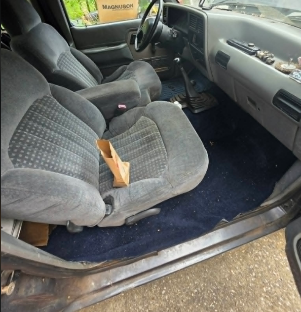

Weather has been horrible here this past week, if the rain holds off tomorrow I'll be taking apart the dash to replace the slosh gauge, the evap core and running the power cables for the sound system.
This has been quite the mission, but it is hopefully nearing it's completion lol.

Once all the wiring is in I'll be able to trim up the carpet and properly secure and set the trim.
