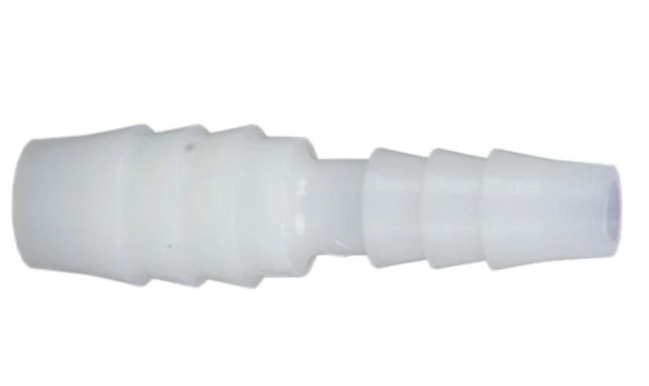

Update. I just needed to reconnect everything and got some fresh hoses. For anyone in the future this is a funky hose setup. The canister is 3/8"ID and the purge valve is 1/4" ID. My old bad hose actually tapered but I just got 1' of 3/8" ID fuel line and a 3/8 to 1/4 nylon reducer from Marine supply. https://www.westmarine.com/seafit-nylon-barbed-hose-reducers-P01856459.html. Even better would be a 90 degree elbow that tapered from 3/8 to 1/4 but I couldn't find one.
