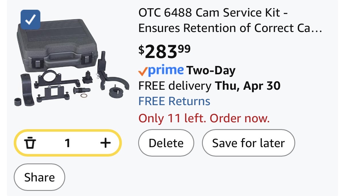

Make sure you have the good quality tools for timing the cams. I feel that is the most critical part of the cam timing chain system rebuild.
10-4
This is the timing tool kit I’m going to get. The dude on the YouTube channel FordTechMaculoco says to get this one and I’ve seen this OTC brand around so I’m going to run with this unless anyone else has a better suggesting
