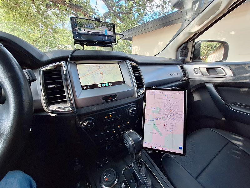

I have a 10-inch Samsung tablet that I use in an Arkon TAB086-12 Heavy Duty Tablet Clamp Mount with 12-inch Flexible Neck along with the Gaia GPS app. In the photo above the tablet is vertical, but I have since turned it horizontal and use it in that position. Android Auto allows me to use either Google Maps or Gaia GPS on the Rangers screen and then I display the other map (Gaia GPS or Google Maps) on the tablet. The display on top of the dash is an old Motorola cell phone that is connected through Bluetooth to an action camera mounted on the outside of the truck. I can use the phone to stop and start the camera and see what it’s recording.

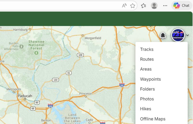

Anytime I add tracks to Gaia GPS I do it on my laptop, and then when I log in on my mobile device (tablet), it syncs the new route to my device. In the top right of the screen click the drop-down menu by your username and then click ‘Tracks’.
Use drop-down menu and click on tracks

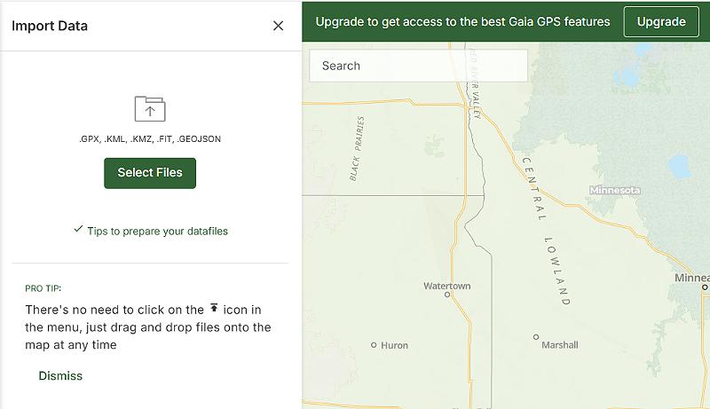

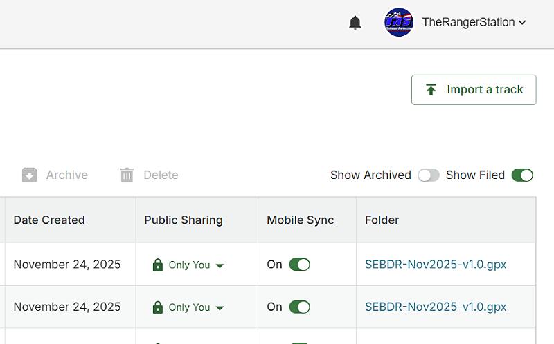

From the Tracks page, click the link for ‘Import Track’.
Import track
And then select the track file.
Select map file to import
Gaia GP will load the track, and it will now display on your map. When you log into Gaia GPS with your mobile device it will sync and show up there as well. If the map isn’t showing on your mobile device, click ‘Saved’ and then once the page opens, swipe down on the page to refresh it.

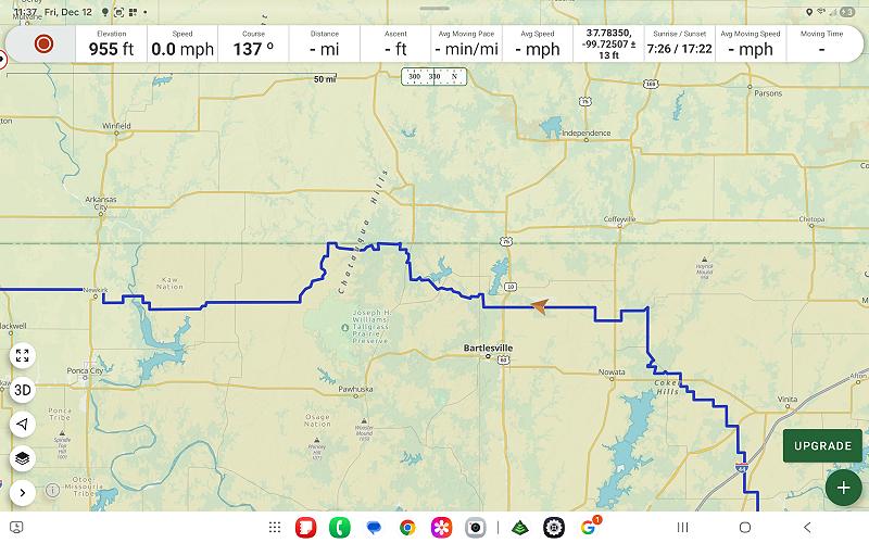

If you look closely (center of image), you can see the orange arrow on the blue line (track) indicating your location. Gaia GPS is not going to tell you when to make your turn like Google Maps will, so you need to pay attention. If you’re enjoying the trip, I’m willing to bet you’ll miss an upcoming turn and have to turn around. Don’t feel bad, it happens to everyone (me) at some point. The top of the GPS will show your elevation, speed, course, average speed, Latitude and Longitude and the time of sunrise and sunset. I find the elevation interesting when we’re up in the mountains, and the time of sunset is helpful when I’m trying to figure out how much further I can go before I need to make camp.
Displaying your location on Gaia GPS

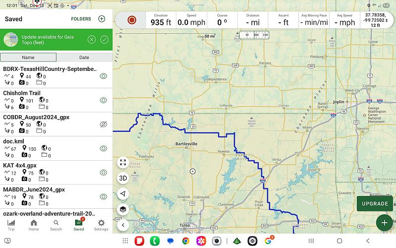

On the left side of the screen, the arrow button (under 3D) will center you on the map, and if you click it again, the map will rotate so that you’re always pointing up. I like for the map to stay fixed and for the orange arrow (me) to rotate showing my direction. The next icon below that is the different map layers, and then the right arrow will open up the menu to get to your saved tracks and settings.
viewing saved tracks
When you look at your saved tracks you’ll see an eyeball image next to them. If you click the eyeball, it will put a line through it (see the 3rd one down) and that track will no longer be displayed on your map. I have a lot of tracks saved to my Gaia GPS and I normally leave them all visible, but if you’re going to be an in area with multiple tracks from other routes, you may want to turn off the ones you don’t want to use.

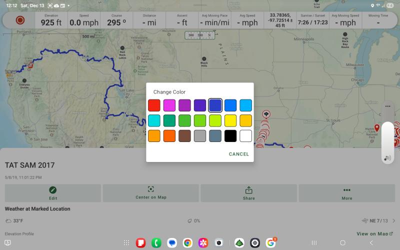

Another option is to click on the track (line) on your map, click ‘More’, and then click ‘Change Color’. This will allow you to change the color of your track so you can tell them apart. Speaking of color, sometimes a GPS route might have an optional track along the route that’s a different color. It may be a harder section or an easy bypass. Clicking on it will give you the details on it.
Change Gaia GPS track color
