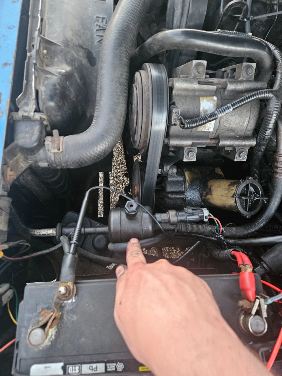

I recently bought a 1995 2.3l and I have no idea what this cylinder by the battery is, it appears to run into the AC compressor, the plug for it has 0v and I don't think it's working.

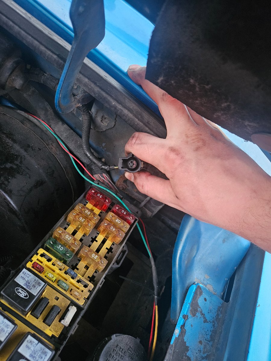

Secondly, I have this plug behind my fuse box that I can't seem to find where it goes.

thats just a 'muffler' for the A/c system and the switch on it is a pressure switch you will want to test for power with the a/c commanded on. as far as the other plug, its probably for a feature that your truck doesn't have. A lot of rangers came from the factory 'pre-wired' for a lot of stuff. A lot cheaper to make one wire harness vs several different ones

That connector may be for the hood lamp. Should have a light green/orange wire.
@djfllmn got it. Like a little expansion tank on the AC line and that is the high pressure switch for the AC. If I remember correctly it will cause the AC pump to cut out if the system pressure gets too high. The low pressure switch is over on the accumulator tank over by the heater box and keeps the pump from kicking on if the pressure is too low.
The other plug is likely for the tiny under hood glow worm that Ford used.
