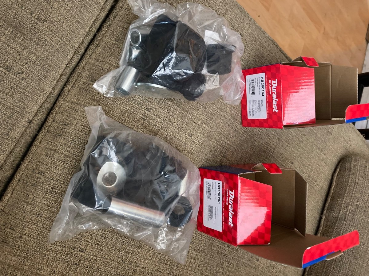

what is the difference between the $16 rack and pinion mount bushings and the $26 bushings from autozone?
internet says not to reuse old bushings but mine look perfect.
internet also says buy polyurethane bushings but none are available at the various local auto parts stores.

I don’t have a good answer for that. I had thought about it when I had my green Ranger apart and ended up not doing anything with it because I was trying to hurry up and get it together and was fighting problems the whole way. Meant to look into it more and never did. Truck is broke again too along with me. Is what it is I guess.

When I owned and managed the fleet of Rangers and S-10‘s, on the few that we would keep (cause the guys would trash them.), we would upgrade to urethane on anything we could. It lasted forever.
The’78 Marc V was also upgraded to urethane, just before I bought it, by the previous owner. That thing is massive and heavy, but it’s one thing I don’t worry about.
For what its worth, just a thought
