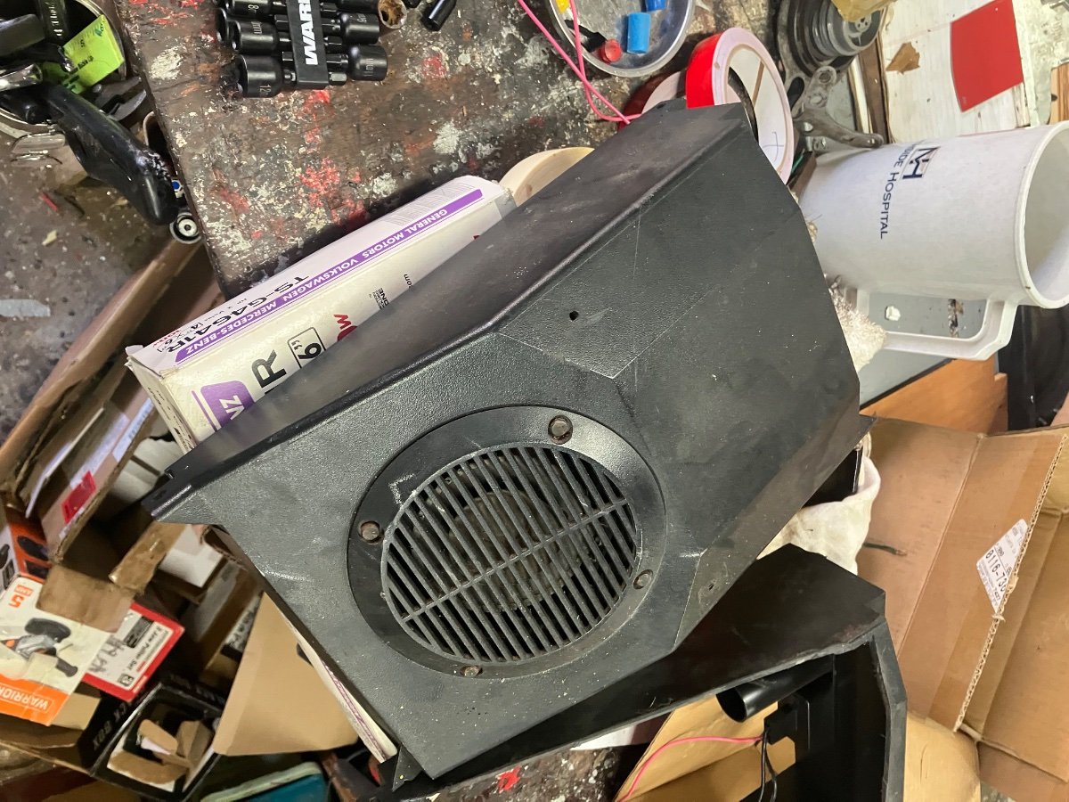

I had extra speaker boxes for the rear, so I figured I’d put new speakers in them before I deal with the rest of it in the cold. Weather was a mild 47° today, so I figured it was an excellent day to take it all apart and put it all back together. Well, at least that was the plan.
So I started this morning with the speakers in the garage with the heat going. I pulled out two spares I had.
First thing was to take out the round speaker covers and speaker. Five minutes, right? Wrong. It’s a sheet metal screw, but the head that shows on the outside does not have a slot, it’s not a Phillips, and it doesn’t have a hex head. It is literally round. How in the hell did they install that? I used long-nose needle nose vice grips to start to unscrew the screws from the back, from the threads, but I couldn’t get them out far enough to to grab on the round head on the outside. Btw, I wanted to save those 4 inch round covers for another project. So I took out the Dremel Moto tool, and I cut slots in the heads with a tiny abrasive wheel. That was a trial and error with 4 or 5 different cutting things, that only took me an hour. But I eventually got them out by using a tiny composite blade.

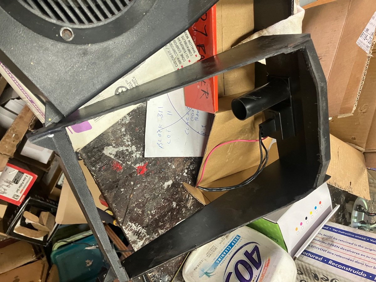

I used the same composite blade to cut slots in the faces of the boxes. That was after I had to split the back off the boxes, they were glued on solid.
I marked the sides, and then used the same composite wheel to cut across the face and down the sides.

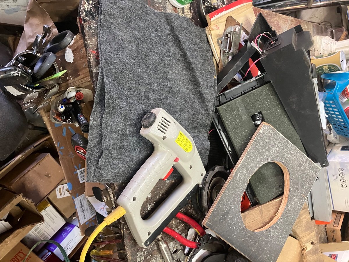

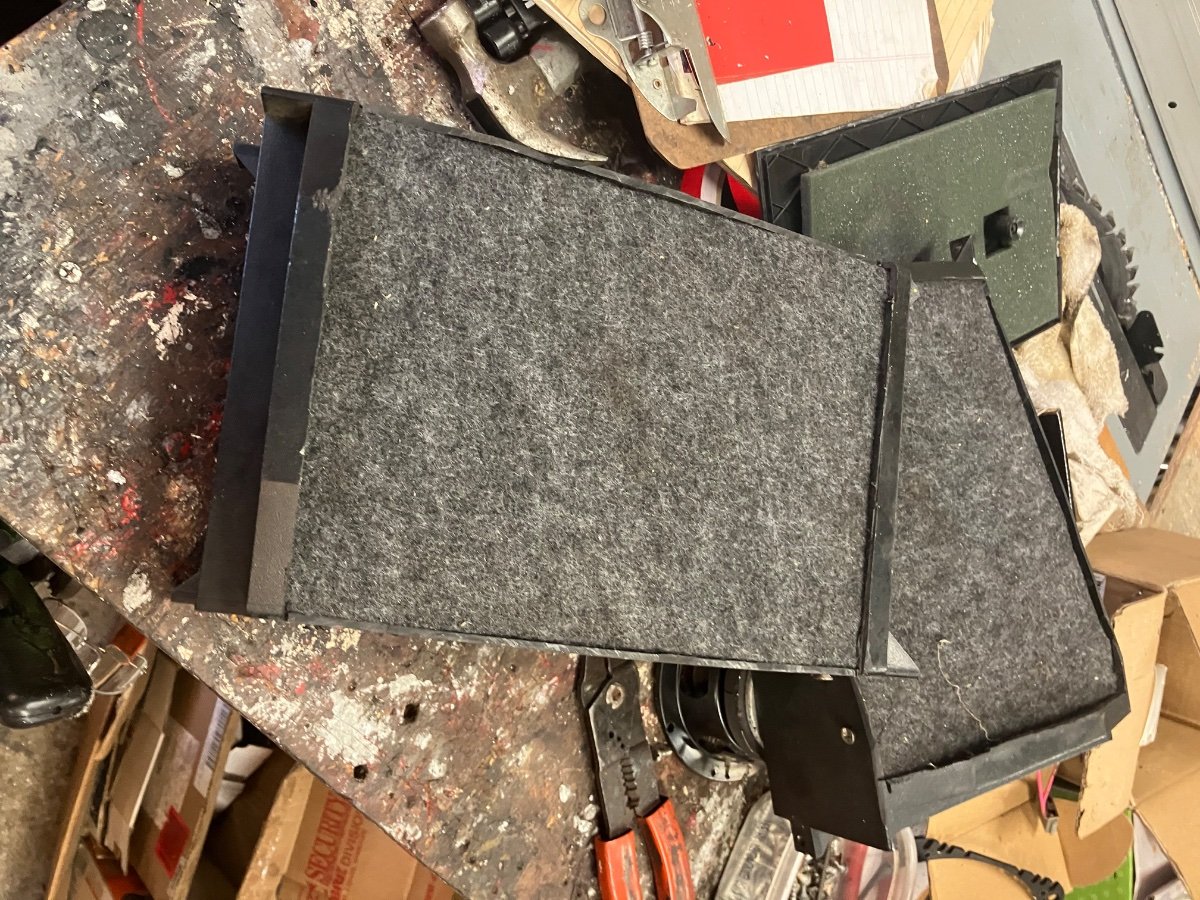

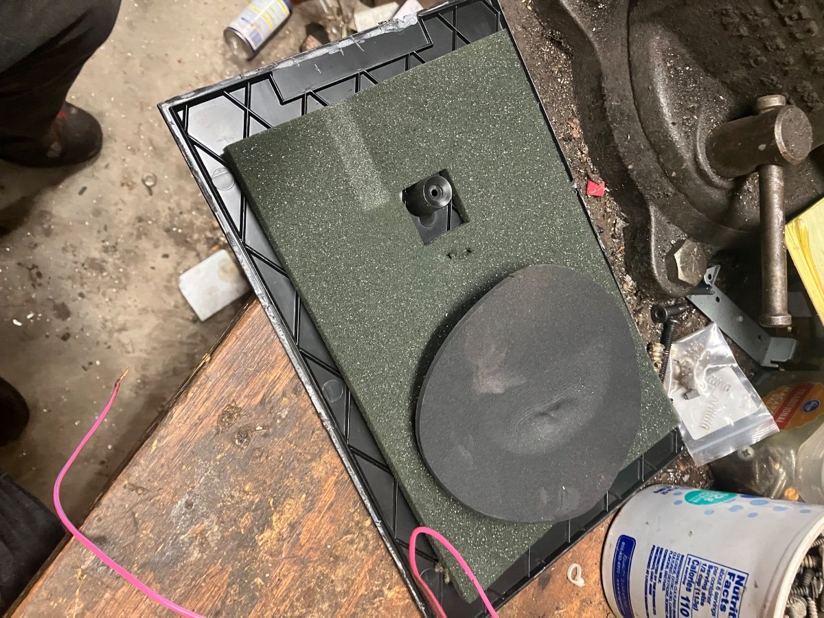

Then I cut 7“ x 10“ plywood pieces to fit inside the boxes to hold the speakers. I had to clear the workbench for 25 minutes to be able to cut a 7 inch width on the table saw.
Then I had to extract the end of the last blade that broke off in my saber saw to install a new blade and saw the oval holes in those plywood pieces.
Then I spent 15 minutes looking for my electric stapler, and (I hate to admit this), I spent 10 minutes figuring out why the bottom of the stapler wouldn’t close over the Staples before I figured out I was putting them in upside down. But I finally got some felt stapled across the faces of the plywood.

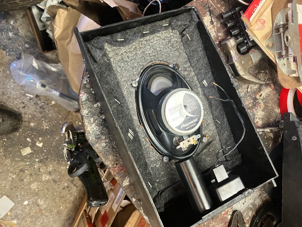

I’ve had the speakers for probably 30 years, a 4 x 6 set.
I didn’t correct the upside down picture because that’s pretty much how the whole day went. When I cut the oval holes, in four places, I swerved in a little bit to create four bumps so that when I put the speakers in and screwed them down, they were actually pressed into place to avoid vibration.
With the felt, I had to push in the 7 x 10 panels so they were snug with the outside frame, again, no vibration. I used wall board screws to hold them in place. I will replace them with some nice looking black pan head screws before I install them.
When I replace the screws, I will sand down the two sides, so they’re flush, on the table sander.
Instead of using the existing back panels, I will use a piece of the 1-1/2” dimple foam used for soundproofing and packaging. But I don’t want you to think I’m doing that simply because I didn’t realize the 4 x 6 speakers were deeper than the original speakers and I can’t get the original back on the boxes.

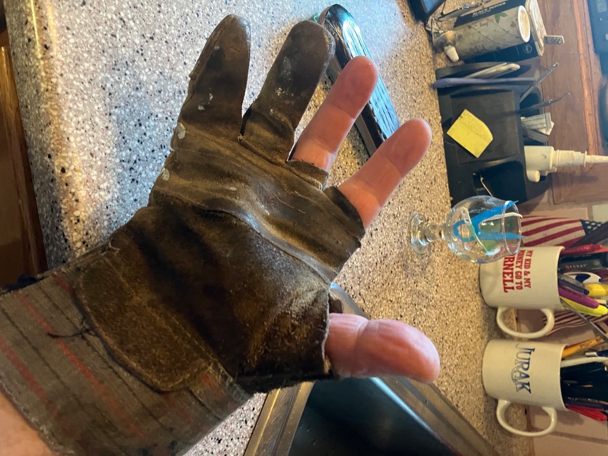

Yesterday it finally warmed up to the upper 40s. I put on my latest physical therapy aid, and got to work.
The nerve damage they went in and repaired was in my elbow, but it affected my pinky and my ring finger. If I walk out in the cold for 10 minutes, it’s stiffens up for a couple of hours. This sexy apparatus did a pretty good job.

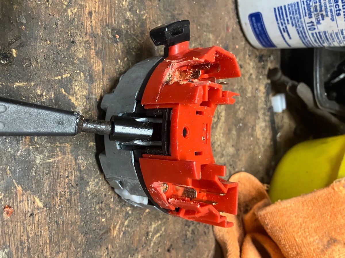

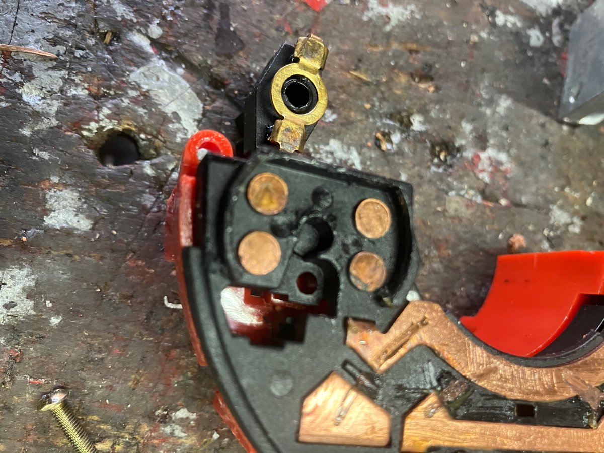

I took the steering column apart and pulled the multifunction switch to see why my low beams were intermittent.
I had to cut slots in the case to get my torque bit in the holder to grab the torque screws.
If you look at the bottom-right & top left contacts, it has a burnt spot on the bottom. The rotator just above that also looked like it might’ve gotten hot. I used a teeny wire brush on my Dremel Moto tool to clean up the rotator. I wrapped a piece of sandpaper around a pencil eraser and actually tried to sand down that lower right hotspot, so I’d get a better contact, and then I wire brushed them too. I put a dab grease on them.
When I got it back together, everything seemed to be working correctly. The whole job took 20 minutes.

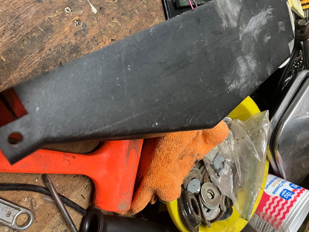

I put ‘93 seats in the Missing Linc from a donor truck about three years ago. I had to use a 24-inch breaker bar to start three of the four bolts out of the floor, then spun them out with the impact wrench. I have no idea why they were stuck so hard. Took about 10 minutes.
Then I spent the better part of three hours trying to get the fourth one out, outside rear. I couldn’t get to it with the breaker bar, no swing room even after I removed the speaker box. I modified a socket to get the best grip possible, and when I wiggled it back-and-forth and used the impact, the whole thing just started to spin in the hole.
Gave up and drilled down through the top to break the head off. I used four different diameter drill bits, and I had to sharpen them every 16th of an inch or so.
But I got it out. If any of you guys need extra leaves, I found a hidden stock pile under the seat.
I still have to figure out how to get that bolt out of the floor before I put it back together. I’m hoping with the head off that I can just drive it through.
With the head off, you might be able to take it out from the bottom with an extractor socket. They stick thru. Probably why it wouldn't come out. Rusted underneath.
The nut on the bottom side of the body probably broke free. You might have to weld it back or hold it with vice grips to be able to turn the bolt out. As mentioned, it's probably rusted. Not goung to be fun.
I had forgotten that the factory built in nut was broken off or whatever when I put the ‘93 seats in. I ran a regular bolt from the top, used a larger nut as a spacer for some reason, and then put the nut for the bolt under that. When I first looked at it this weekend, it just looked like a nut from underneath. So once I started breaking it free, the whole thing was just spinning, and I thought it was the factory nut coming loose.
I think I said it, but I used sequential in size drill bits to drill right down the center of the head to the point where I could pop the head off. After the seat was out, I tapped the stem with a wrench and it fell out on the ground. One of the reasons it was so hard to grab was because my fat ass bent the seat over towards the door, and the steel around that bolt head rolled up, keeping the socket from going all the way down. I used a metal dowel to bang it down around the nut and was able to get a little grip, and that’s when it started spinning, so I just drilled it.
