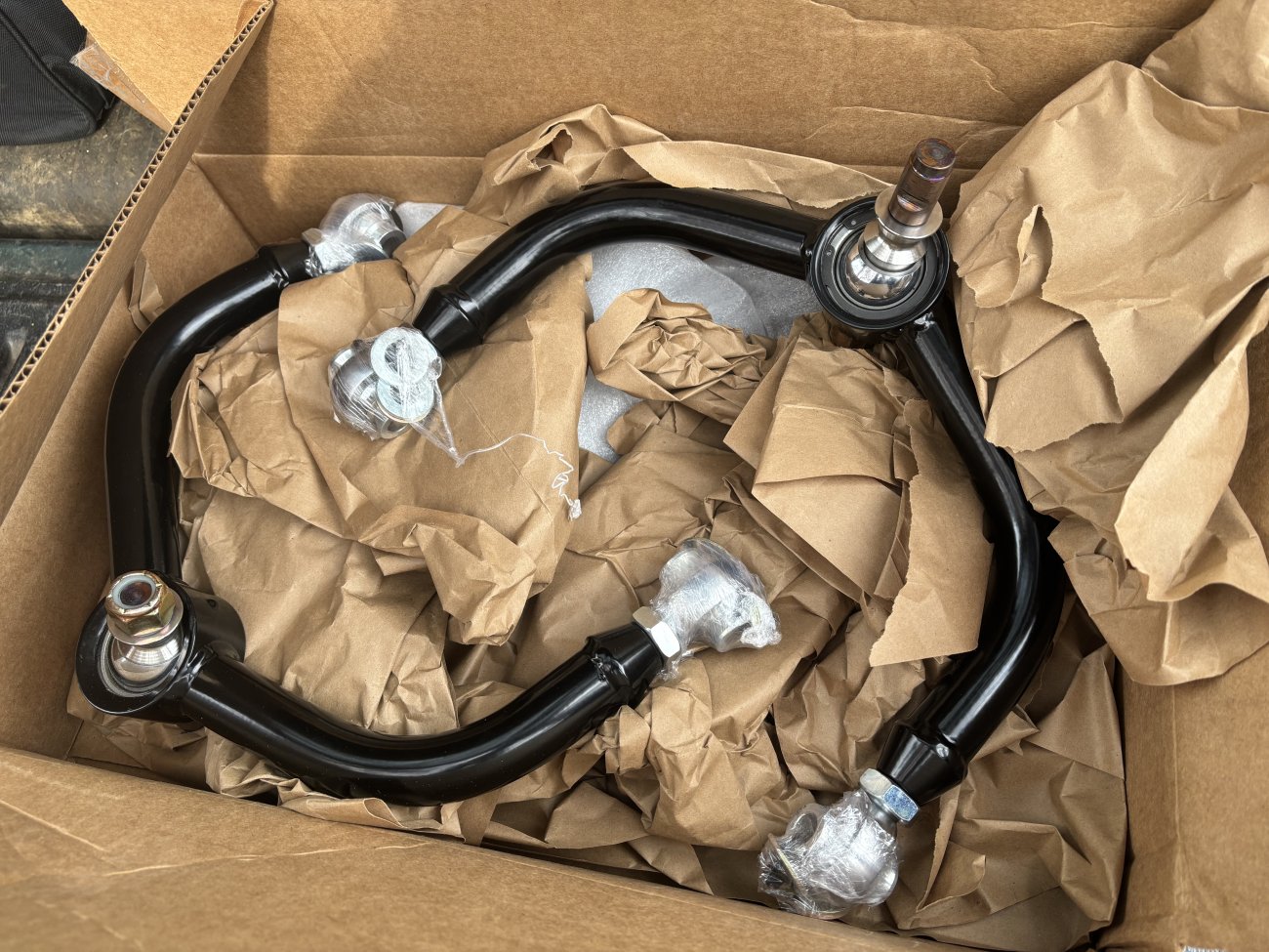

These are first production (test stage) upper control arms for lowering a torsion bar Ranger. Wish I was ready to install and test them on the green Ranger but that’s going to be a bit yet. Decided to give y’all a sneak peek though
