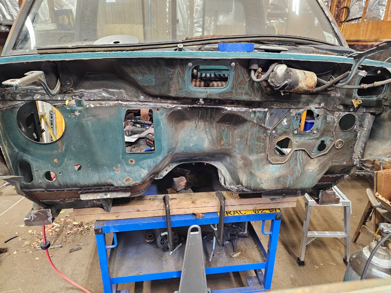

Over here it was finish up the firewall and a couple small rust holes on the replacement cab. All I've got left is a little bit of work on one rear cab mount and I think I'm going to address some rust jacking between the seat support and floor pan and call it done. I'm working on a labor trade to get the cab painted in exchange for rewiring a fox body mustang from end to end. Guy has a new wiring harness for the car but it requires effectively making the engine wiring harness standalone. It's something I can do but he cannot. I can't paint to save my life, he owns a body shop, hopefully it's a win for everyone.
Here's a Pic of my pretty much finished firewall for reading all of this, haha.

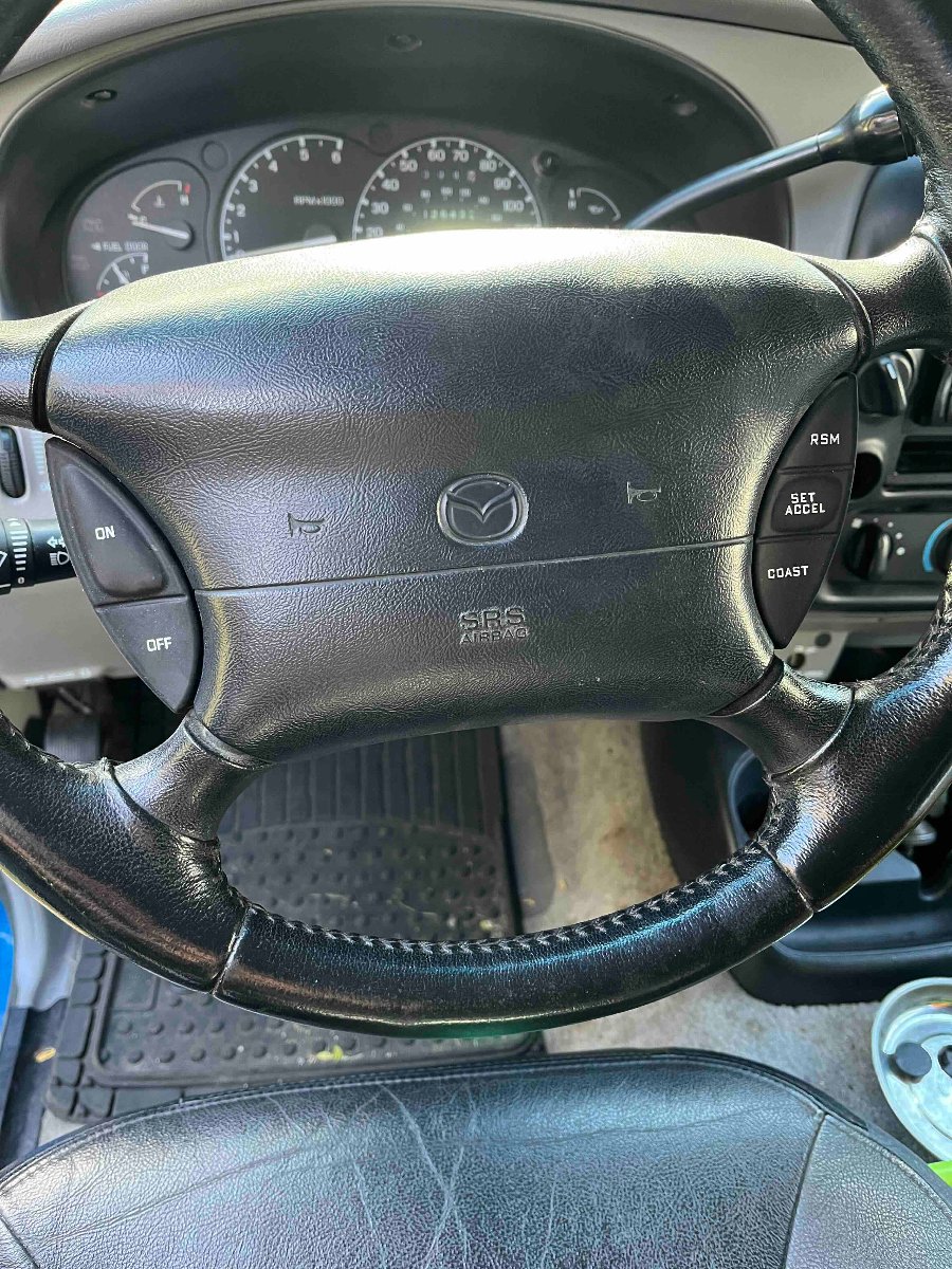

Now to attempt to figure out why the cruise control and horn don't work and blow fuse 10 under the hood... my guess is the clock spring or something is broken but we'll see...
What did you figure out with your horn and cruise control?
The horn and cruise control in my 98 Mazda are not working. I recently changed the heater core and blend door (dismantling the entire dash) so I wasn't sure if I missed a connection during reassembly, but I can't remember if I ever used the horn or cruise in this truck. When I checked under the hood the horn/cruise relay was missing, but replacing it did not cause them to work.
The steering wheel controls for the Cruise were replaced at some point so one would think it was working. But the missing relay makes me think maybe it wasn't and the relay was removed for whatever reason. Idk though. I hate to start taking all the dash panels off looking for a missed connection if there's any common issue I'm missing.

They still aren't working, I haven't spent much time on it as at the moment that vehicle is just used for hunting and when I have time to do it towing my boat... it's on the list but have things higher...

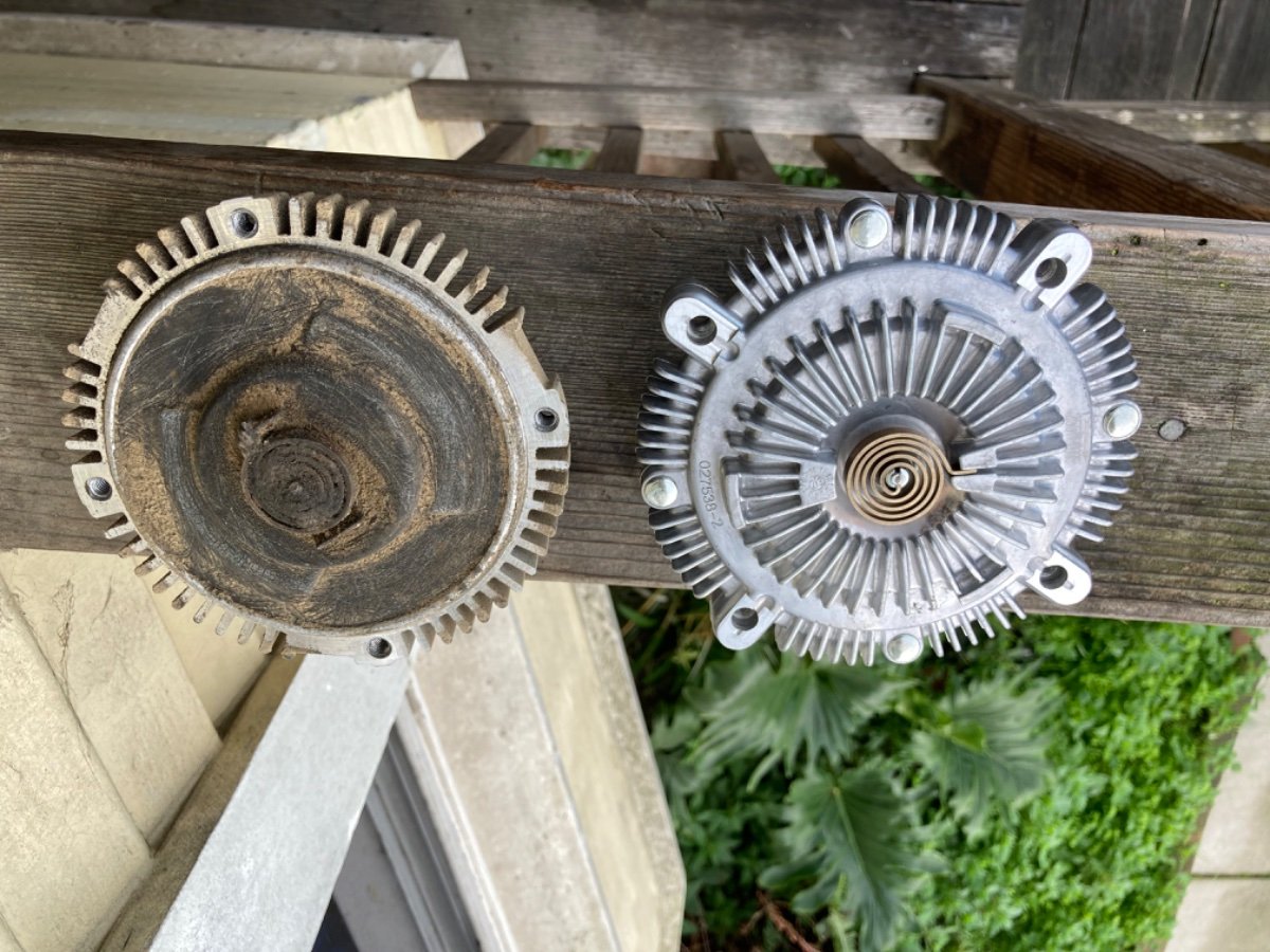

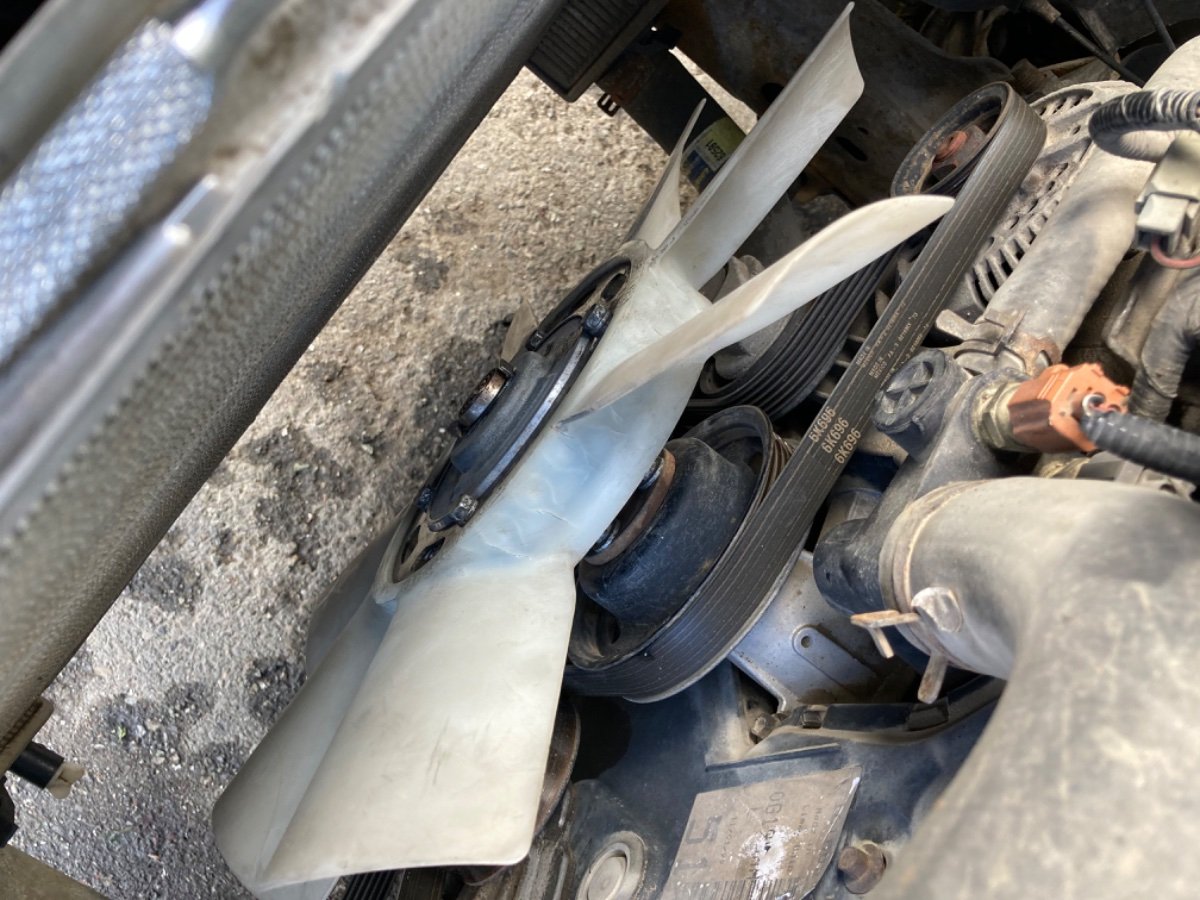

i took my fan off my fan clutch and now im not sure what direction to put it back on. i have been searching radiator replacement videos every photo and video online, the fan is covered by the fan shroud, help!
also the spindle that the fan is on has a lot of resistance. i was told this was due to bad fan clutch but it seems
like the entire spindle it is on is having trouble spinning.
The clutch is normally stiff when cold an hasn't been run. After about a minute or two of running, the clut h should pretty much free wheel. Then, when the engine is at operating temperature, the clutch should be stiff again.
As far as theading it back on, look at the threads on the spindle, and turn the nut in the direction they spiral rearward. That should be clockwise since most engines turn in that direction.
