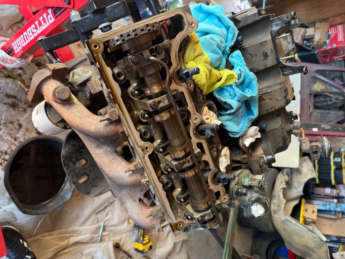

Got my 4.0 opened up for replacing. Only have videos of the debris, but the front guide is completely destroyed. Haven’t looked at the back too close yet, but it looks to be intact.
