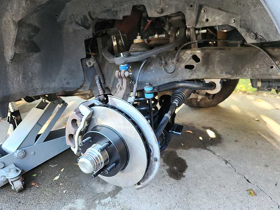

I installed new pads and rotors. That completes the front suspension project. New upper and lower control arms, inner and outer tie rods. Both lower ball joints and one outer tie rod end was toast after 17 years and 206,000 miles. I think they may have lasted longer if the dust boots didn't disintegrate. Now it's nice and shiny!
I need to get it aligned and acquire a new set of those flexible splash shields so the alternator and the sides of the engine doesn't get drowned when it rains.
I got rid of my rubber splash shields over a year ago since they had torn, and I’ve had no issues. That said I had trouble finding a new set for a decent price which was a decent amount of my reasoning to leave them off.
