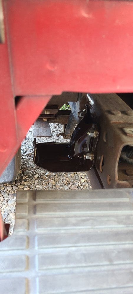

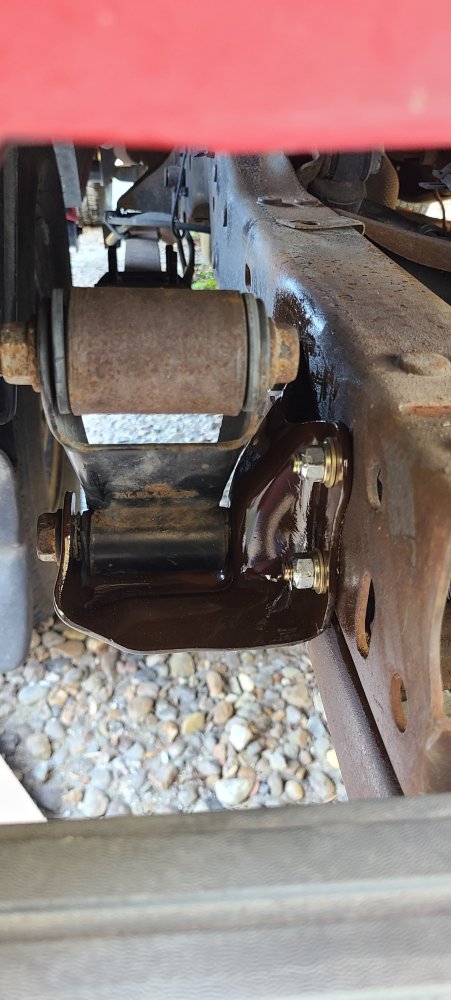

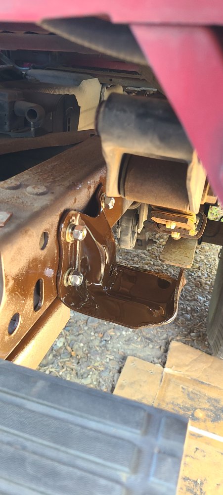

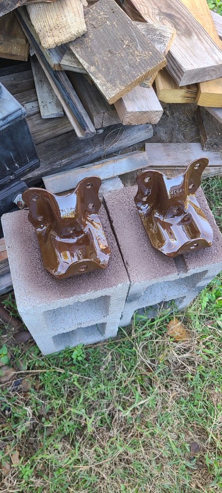

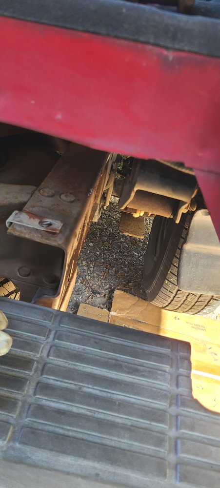

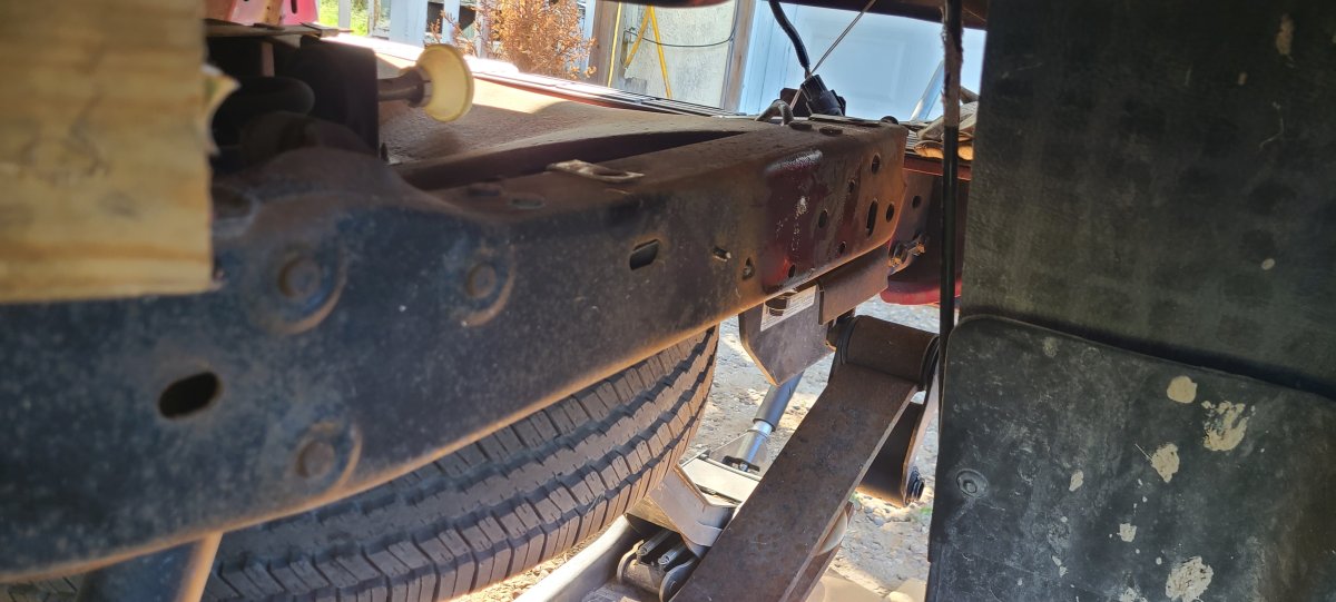

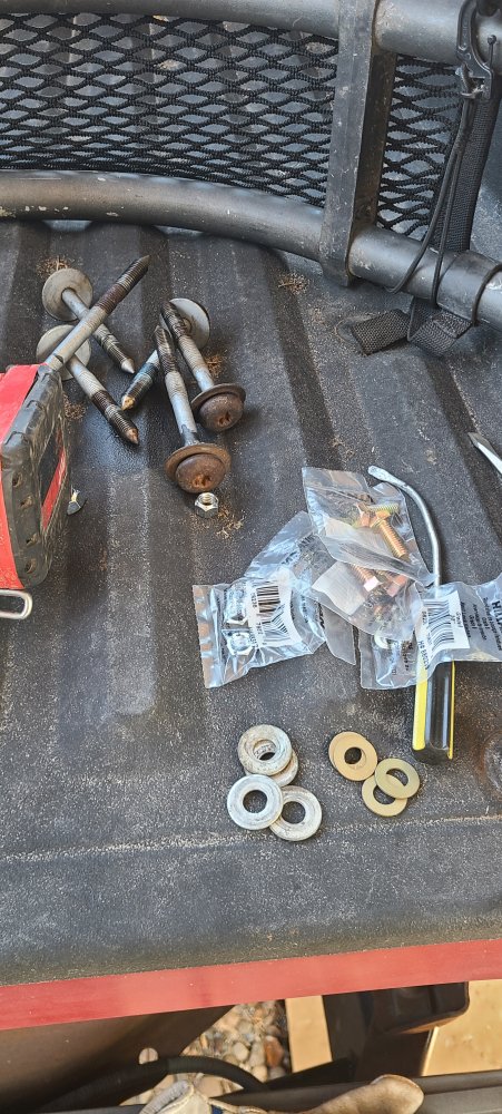

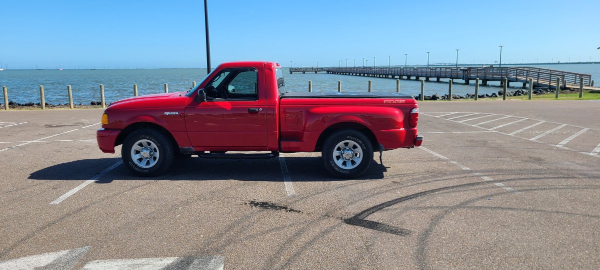

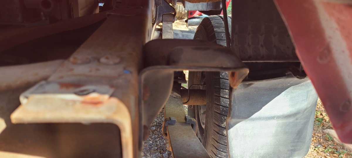

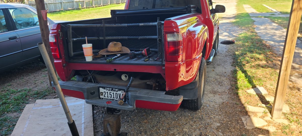

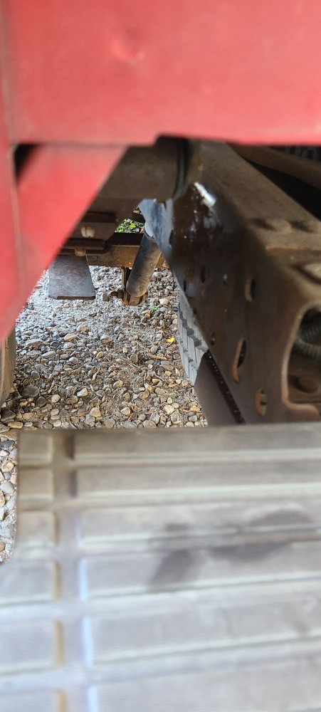

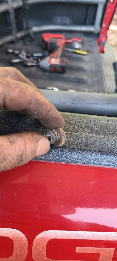

I did the rear hanger flip on my truck. I couldnt find black paint though so i had to touch up the frame and hangers with brown for now.
Use 4x6s when you lift the bed so you can drill the rivets, then everything fits perfectly. A 4x4 isnt high enough.
I need to lower the front some more now.
So far, i have taken the stock 2" spacers off the back and flipped the hangers sk its about 4 inches lower. There is still about 6 inches between the stops and the axle though.
Its so much easier to get in and out of the bed and cab now but i think i meed a couplw more inches to meet tech inspection for autocross since the vehicle cannot be higher then the back wheel track, center ro center. My truck is 57 across so i need to get some different offset wheels to help there

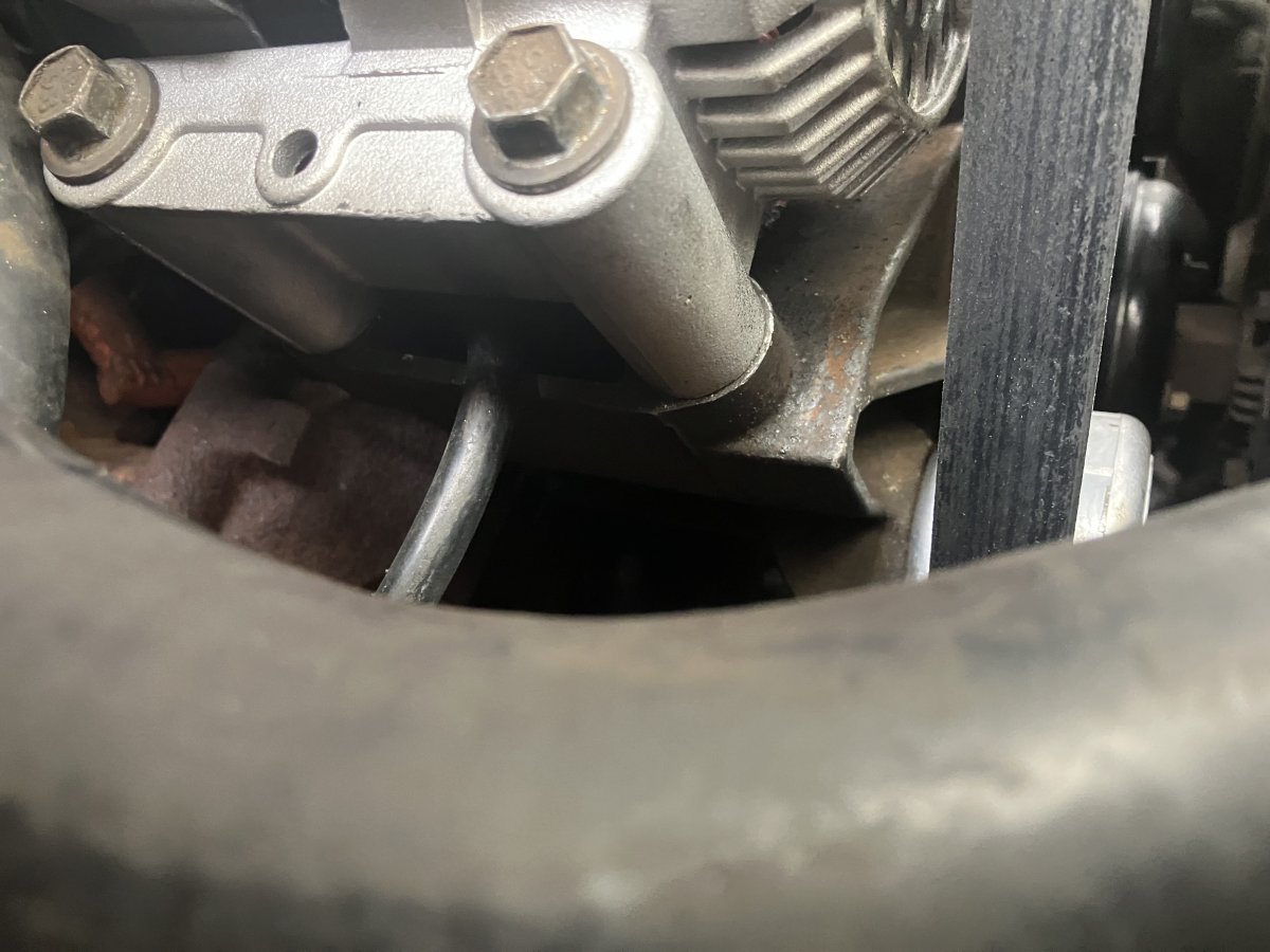

After fiddling half the summer, I got the air conditioner working right on the Road Ranger. Like everyone said, it wasn’t that big a deal. But when I changed the alternator, it once again went to blowing only on the windshield. I figured I snapped one of those 30 year-old tiny plastic vacuum lines when I was fooling around in there.
Well, I hunted high and low, it had to be right there somewhere, and then I found this.
Turns out that the vacuum system works much better when you don’t take one of the rubber lines and clamp it down between the alternator and the alternator mount.
It’s a vacuum line, so there’s not supposed to be any air in it, so I didn’t see what this would hurt initially.
Plenty of cold air now, but it’s kind of getting into Winter, so I could’ve just opened the window, I guess…
