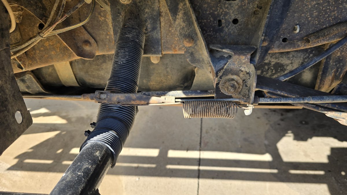

You could likely adjust the cables enough to overcome the deflection of the cable.
A slight reroute of the cable would be better... but you're still likely to have to adjust the cables when done.
Not sure where I would adjust the cables. The star wheels are in their shortest position now. The driver side parking brake lever was not fully retracted in the rest position. The only way I see to get more cable is by getting rid of that deflection by making a new bracket.
Typically... the individual rear cables are non adjustable. Adjustment is usually where the main cable connects to the equalizer. Loosen that connection and it will relieve the pull on the driver side cable.
Nuttin there to adjust.
Thinking about it, I don't recall seeing a cable adjustment on any of my Rangers. Unless it is up in/near the pedal assembly, I'm not sure that there is one.
