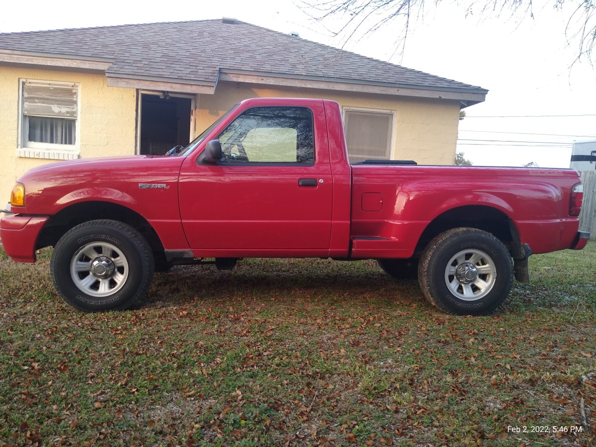

Lowered the front. Everything is now as low as i can go without researing the keys on the torsion bars and doing an over soring axle out back.
I can get out with putring my foot flat on the ground and not have to slide anymore. I lift up and get out.
I want to go lower but i dont know when it would happen. My last car was lowered to much and i dont want to do that again so i will drive it like this for a while well i find some rims and tires.
i also have to convert the bmw to a carb and out the sport springs on that. The thermo time switch is about 250 bucks and i need that to test if the cold start valve is good. If the cold start is no good, all manufacturers stopped making it about 8 years ago so i would be out of luck. I already have a factory bmw two barrel intake from a 1976 bmw 2002 and a weber 32/36 set up to go on. I just need a fuel pressure regulator and an air filter in order to run the car on a carb. And i have done this conversion already snd know how much more fun that little 1.8 is with a carb.
Pic of when we got the truck
And its current settings

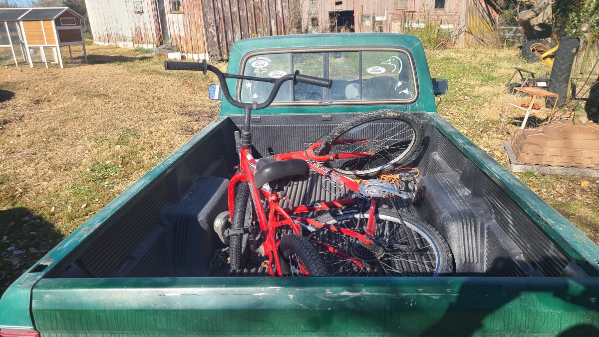

And went to town and rode bikes on the trail.
