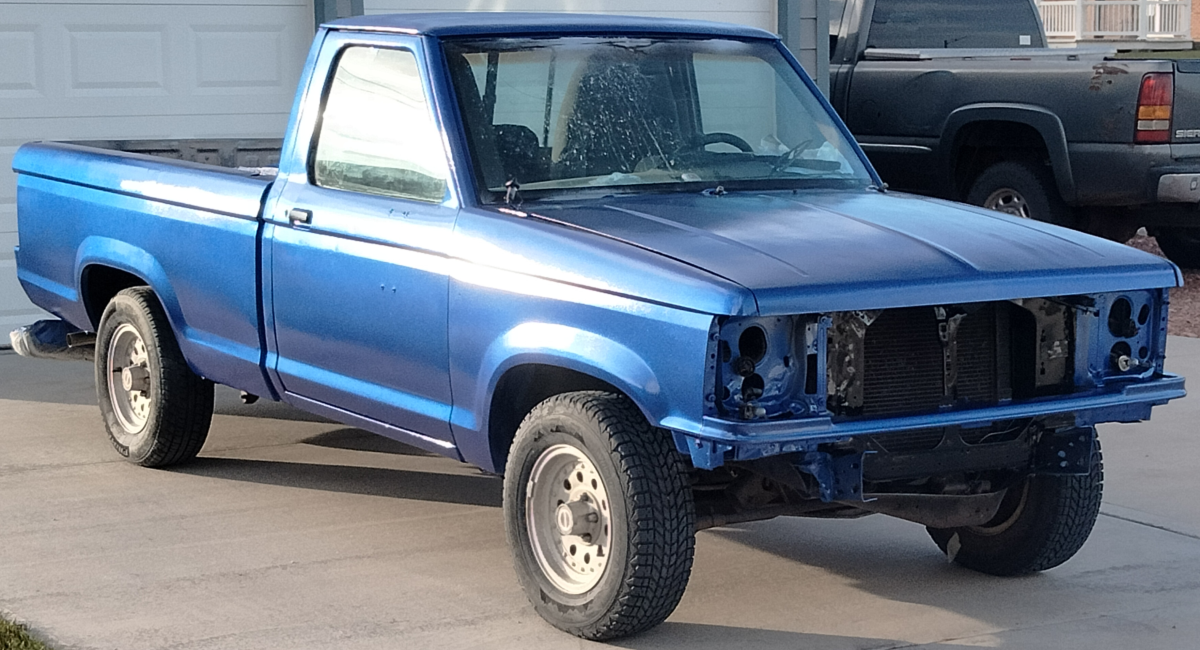

Only did 2 things today, took all the paper/tape off the windows and rolled it out of the "paint booth" (shop), by that point the wind started to howl and I said no way and went in for a cup of hot chocolate rather than start in on the cleanup in the (unheated, uninsulated) shop.
I intentionally painted the center support area black because I always felt like it looked dorky to look through the chrome grill and see dirty body color metal back there, so rather black it all out. And yeah I didn't spend much time repairing the collision damage and making the inner panel look pretty since it will all be hidden behind the headlights - as long as all the landmarks are right, meh who cares. Eagle eyed among you will still spot a few hail dents in the hood and such... at some point I just had to give up and say "I'll be chasing hail dents all winter if I try to get every last one, it's a truck, not a trailer princess".
And for those looking at the front windshield, yes I was careless and got primer and left gunk on it.. it is a throw away, 2' long crack running to the edge. I have a glass guy who has one on stock I just got to make an appointment after I give the paint a few more days to toughen up.

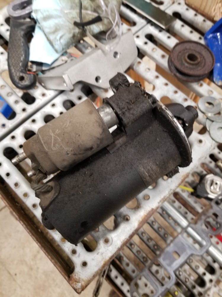

Here's the starter off my '97 "as found" on Friday, never seen that before...
When I had Beer Fetcher in the shop for timing chain/water pump/oil pan/starter one of the screws had backed out on my old starter causing the starter to grind on the flywheel. So I too have seen this.
Yeah. But the solenoid fell apart in his. That, I haven’t seen until now.
That is because both screws backed out on his and not just one. If Scott put the screws back in with some blue thread lock I bet that starter would be fine. The Solenoid did not come apart, the screws that hold it to the starter housing came out, the same issue I had, albeit only one screw in my case, with my old starter in Beer Fetcher.
