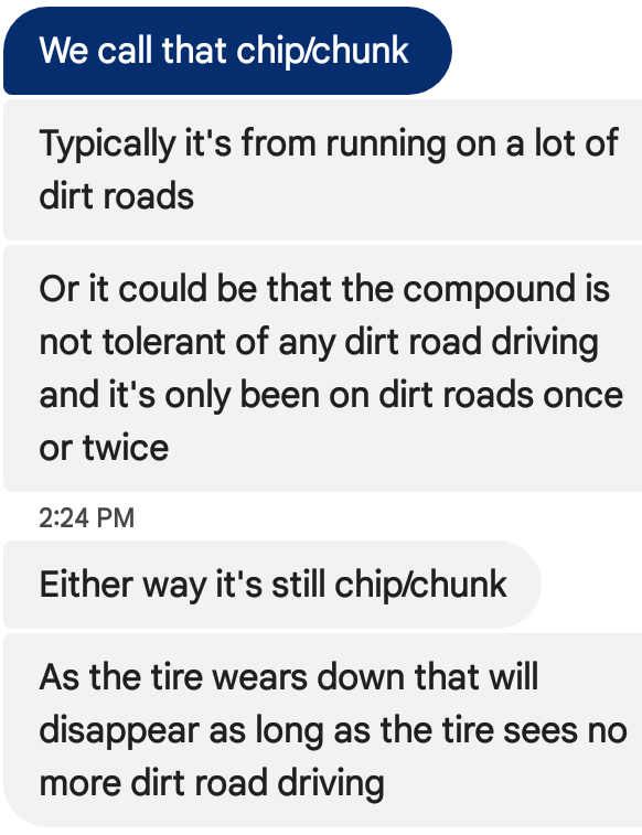

That's really interesting. I can't remember driving on the dirt. Maybe when I first bought the truck. But not often and not fast.I sent the pics to a friend who's been in the tire industry for 35 yrs, this was his reply.View attachment 119943
The old method for establishing proper contact patch and tire pressure is to draw a chalk line across your tread and drive on it. See where it wears and where it doesn’t. You want a minimum of 80% of the tread contacting the road. Reduce tire pressure until you achieve it. Really you should do this with any new set of tires.
I run 10 psi in my Choptop tires on the road because that’s what it takes to get 80% across the tread.
That's an interesting "casting blame".... not being hostile, but it doesn't sound like the right answer to me. I've read the professional tire sites claim that as well, but I still don't buy it.
I grew up on a farm, and every vehicle we had drove dirt roads almost exclusively until I turned 14... I could name 6 fullsize ford trucks, 2 buicks, 1 jeep (wagoneer), 2 or 3 ford cars, and so many tractors I can't even name em all (almost all John Deere, but a few Newholland)... never have I seen anything even remotely like that from dirt roads, even during the winter when you are driving on frozen razor blades. When I turned 14, we switched schools to a place 30 miles away and the cars got 30% pave, 70% dirt - still none of that.

Could it be overinflation + worn/bad front bearings? Worn bearings can give some crazy wear, even if the truck isn't driven at highway speeds to make vibration noticeable. If not the bearings, check suspension bushings carefully too. Also, that frame is pretty rusty. Wouldn't hurt to check it while you're looking at the suspension.
