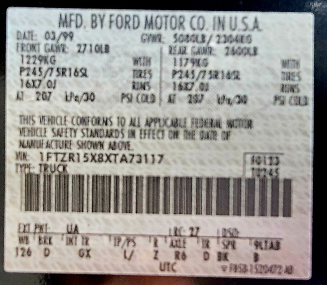

On your first picture I see very little squish out, and you said that is only 30... not even the door sticker 32 (every vehicle I have is 32, so I kinda assume yours is too).... How confident are you in your tire gauge? and just one gauge? I think we all know that excessive wear in the center is overinflated... but that doesn't explain weird wear pattern. If you have a couple different gauges check em against each other. My first guess would be sun rot + overinflated. Kinda a stretch to just say that though, do you always park so the front are exposed to morning or evening sun and the rear are shaded?

Here's the door sticker showing 30 psi. Sorry it's a tad blurry.
