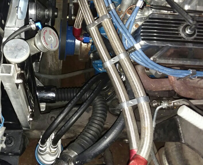

I have a Trans-dapt relocation kit & it works great. I mounted it forward of the steering box on the outside of the frame, but you can mount the filter bracket anywhere you want as long as you use hoses that will reach.

The problem with the TransDapt is that you're stuck with wherever it decides to tighten up, unless you can find different thickness oil filter "o-rings" to try out. Again, the L&L oil filter relocation adapter is far superior to nearly all other brands. It allows you to clock it in any direction you wish, and it made from far superior materials.
I'm running the TransDapt myself and it works, but I trashed the junk fittings and rubber hoses and swapped all of the fittings over to AN stuff and Russell braided stainless hose.
L&L sounds like it is similar to the canton unit i'm using. I can also orient the lines in any direction. The thing is that I can run them straight forward without an issue but I don't like the loop the line creates in front of the motor in order to get to the location I want the oil filter mount.
I tried the Canton and it was too tall. I could make it fit but it would have still hit the steering box occasionally, and tightening the bolt to hold it down was a nightmare with the steering box in the truck. The L&L is shorter and more compact. I may switch over to the L&L one of these days..
Someone needs to make one as low profile as the TransDapt model that has a center bolt through it that allows clocking the unit. That would be the best of both worlds.
