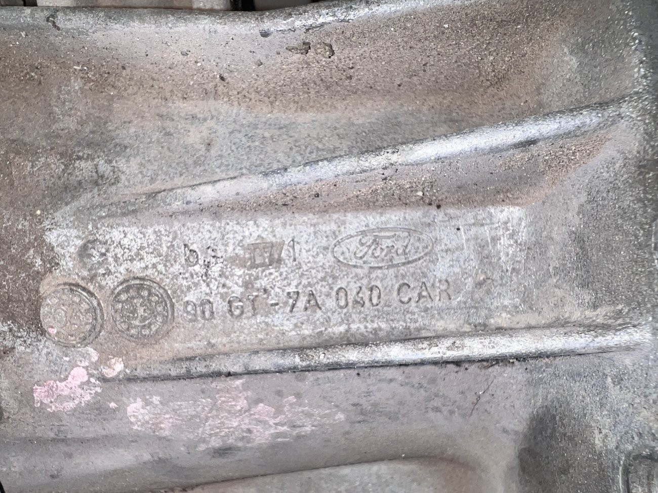

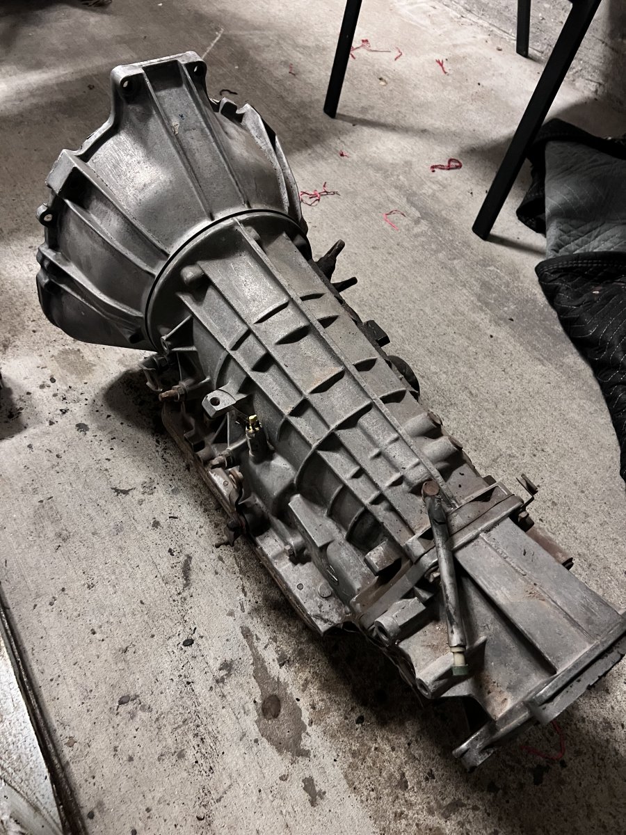

I need help identifying this transmission.
It was given to me and I was under the impression it was out of a 80s Bronco II (A4LD)
Looking at it now, it looks more like a AODE or 4R70W.
I can’t find any casting number other than on the t case adapter (pictured)
Anyone familiar with these transmissions that can identify?

I don't know, but it looks to have a removable bellhousing, and afaik all the ones you named are integral.
Could be a C5 out of an '80's BII (assuming 2.8L), I don't know what they look like though...
Basically like a C4 so not like this
I think it looks exactly like an A4LD?
That is my vote, looks like it has the 2.8/2.9/4.0 bellhousing
Isnt the 90 in the part number the year it was built?

I think it's a later C3 derivative like a A4LD 4R44 or 5R55. Are there any other numbers on it?
It has the old park/neutral switch and no big plug down by the shifter arm.
Rusty is right that it seems to have a '90+ tailhousing on it, so it doesn't make sense for it to be all-original to an '80s truck, but I don't see anything else weird going on.
It's an A4LD with a 4x4 tailhousing and a 2.8/2.9/4.0 bellhousing. Hard to say what year it was intended for, mismatched parts could just indicate that it was gone through and the rebuilder picked parts out of a big box and stuck them together, or something was damaged and replaced.
