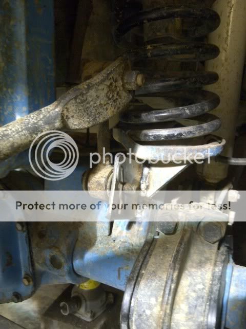

I now have an operational sway bar with home made disconnects.

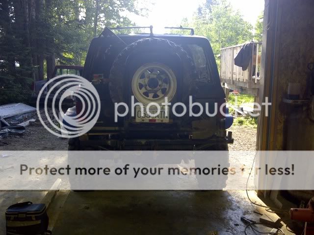

Repaired my Tire carrier and added a couple touches to it while I was at it. Added a Jack-all mount and an axe mount so now my carrier carries a tire an axe a shovel and my jack.

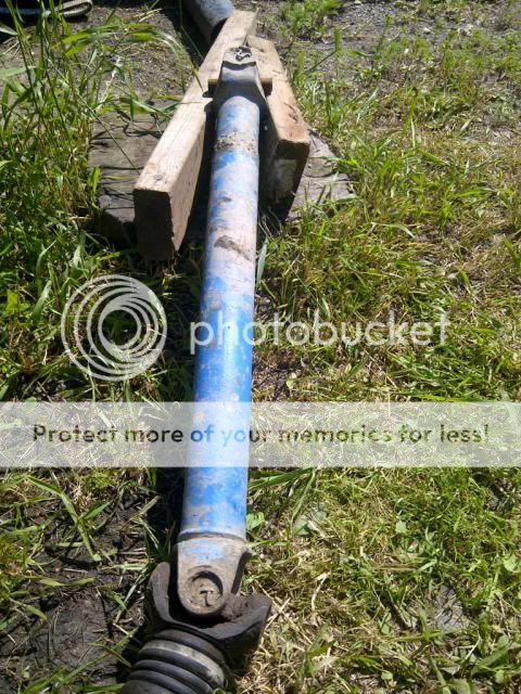

Also time for a u joint change as the front drive shaft was making some noise.
Turns out I now have all 1310 joints in both my drive shafts!! This is a good thing.

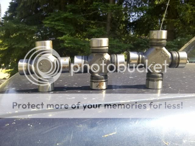

Was changing ujoints and thought I would snap a couple comparison shots. Left to right: 1310 diff yoke d44, 297 d44 axle joint and a 1350 GMC double cardan joint.

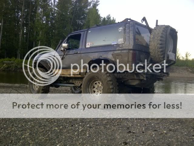

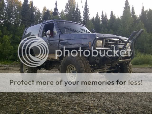

Went wheeling last night, Doc said to take it easy so I took it easy, lol.
man she was really in there. with all the rigging's on the rear look's like it took some force to free it up.
How did I miss this thread?? Damn that was deeper then you thought, I like those kind of mud holes.
Yeah man it was way softer and deeper than it looked haha, I knew it was soft but once I got in it I knew I was done, lol. :headbang:

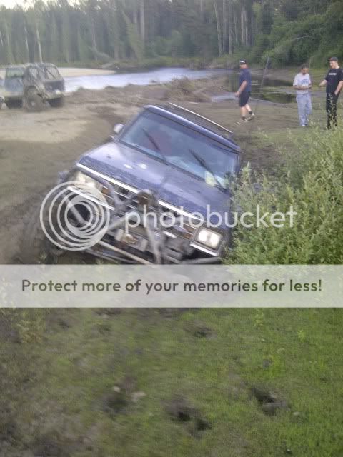

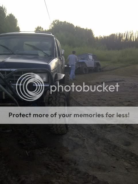

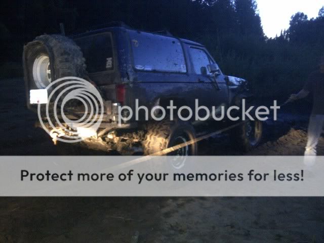

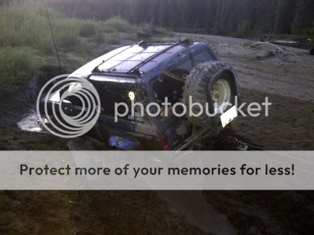

It kept stalling out the 8274 on buddies rig pulling me, first we had to tie his rig to another to keep it still and that was after he dug his 42's deep in the dirt to try and hold, then it stalled out the winch so we added a snatch block and it pulled me back a few feet before it stalled out again. Buddy pulling me wanted me to spin the tires to help free it but all that did was sink me further down and make the pull that much harder. So at that point we added a second snatch block for a triple line pull! It was in there so tight that it almost stalled out the winch again. This time tho I suggested I leave the Bronco in neutral so the tires can try and roll up onto the ground, it worked!
Yeah man there was huge pressure on parts, I could hear it going PING! SNAP! CRACKLE! TWANG! Made all kinds of nerve racking noises and all the while I'm praying my rear receiver I welded between the frame rails stayed in place and didn't become a projectile. It survived without a mark tho, all welds look good still. :D That was a serious test on my welding ability and I'm happy to say YAY! LOL. :icon_welder:
While extracting the Bronco we created a brake system leak somewhere. I washed it off but haven't looked under it yet. I believe it's the rear brakes as I still have brakes but the pedal goes almost all the way to the floor before stopping power happens, lol.
Took us just over 2 hours to free it up and several winch cool downs and shoveling and messing around, lol. WICKED trip tho, man I love wheeling!!

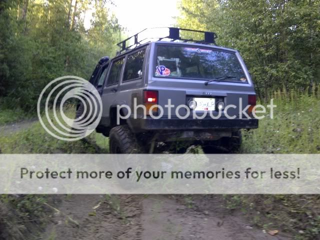

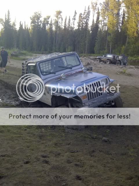

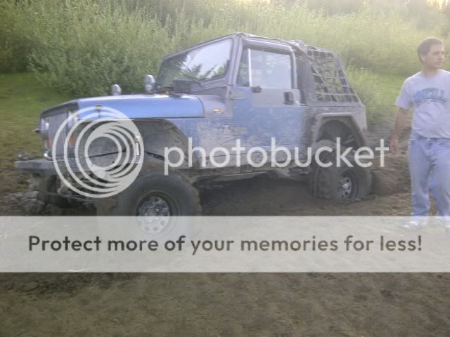

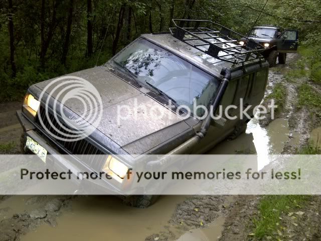

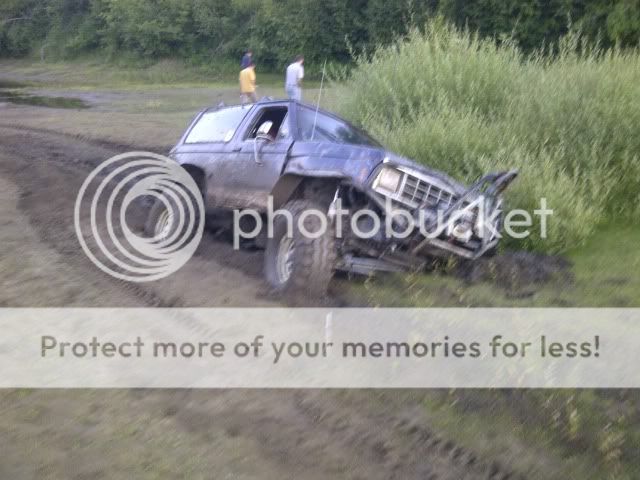

Here's a couple shots of buddies YJ on 33's that went thru before me. We knew it was soft once he tried it but man was it deep too. lol

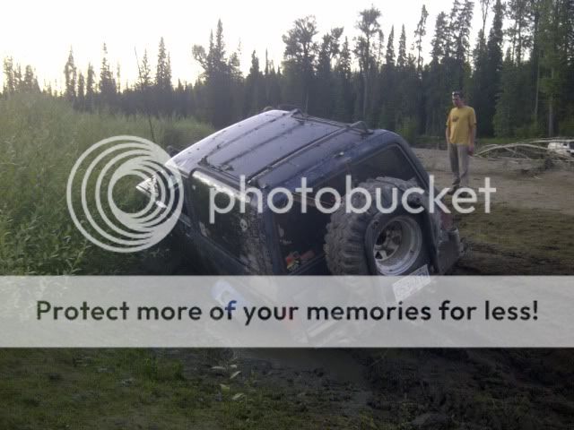

Here's a good comparo shot between him and mine stuck, lol.

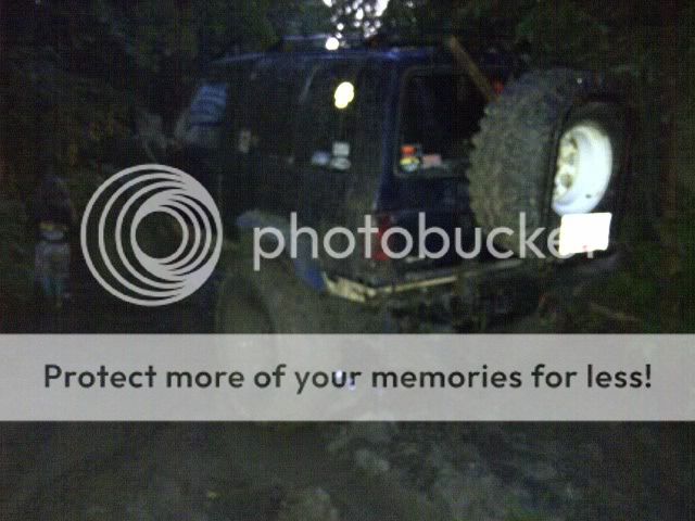

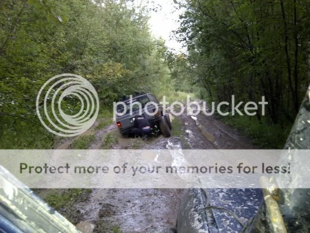

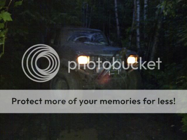

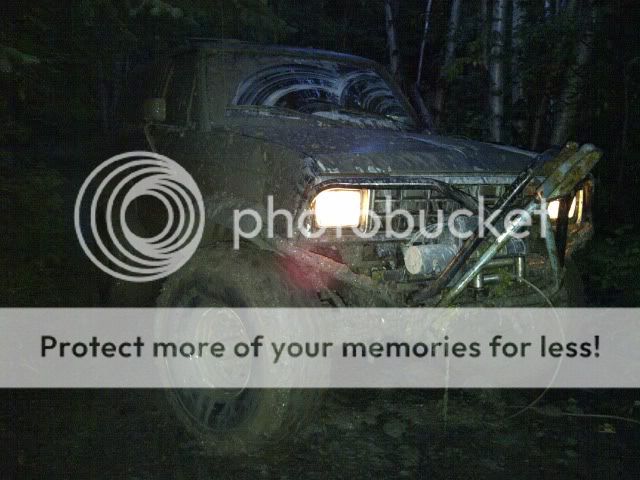

Then it got dark and deep and the winch came out to play, buddy has vid of the first deep hole and possibly the second deep hole, I'll try and link it on here once he uploads it to youtube. These pics are of me in hole 3 of the Poo Trail and there were several more holes in sight after this one too.
And after some rev limiter action and winching I made it out of hole 3 down the Poo Trail.
Then instead of carrying on down the trail, we decided to head back the way we came as buddy with me had 35's on his Cherokee and had parked his rig and walked along as I winched and ripped through the first 3 holes. Figuring winching back through 3 very deep holes would suck ass I resorted to take the bypass's back to the start.
