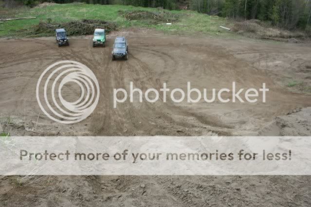

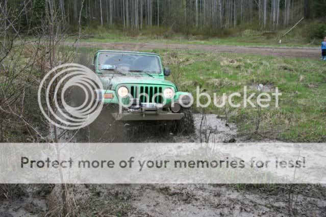

For sum reason my photobucket account isn't finishing up loading all my pics, it's just sitting there saying upload in progress, for the last 15 minutes, weird cause normally its quick. Might have to log out and try again. No worries people, pics are on the way today.
Let me know if this link works on here please, it's a short vid from the test run..
http://www.facebook.com/video/video.php?v=173923379333170#

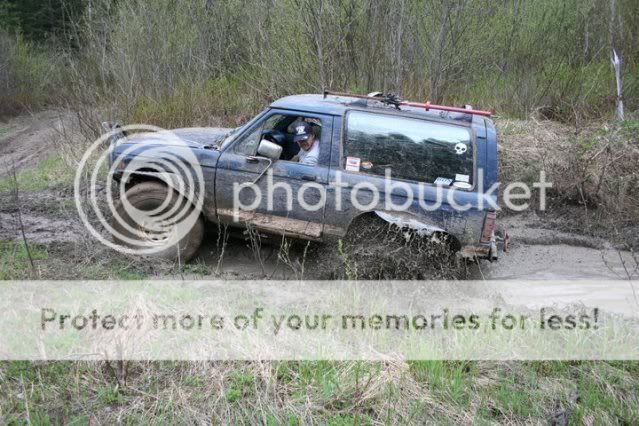

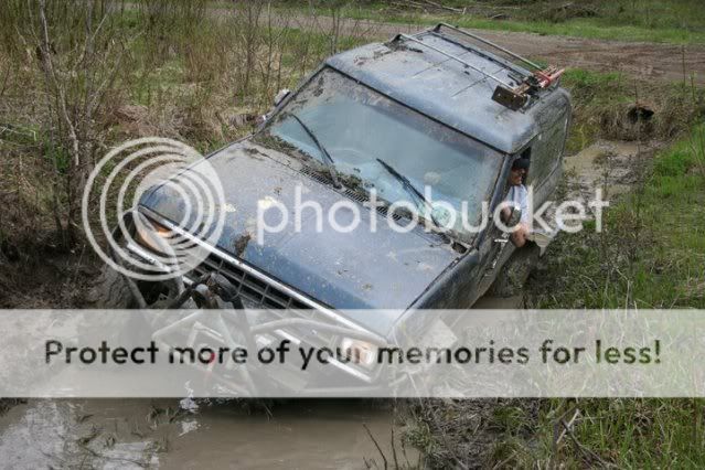

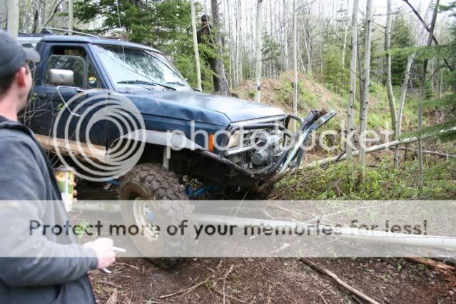

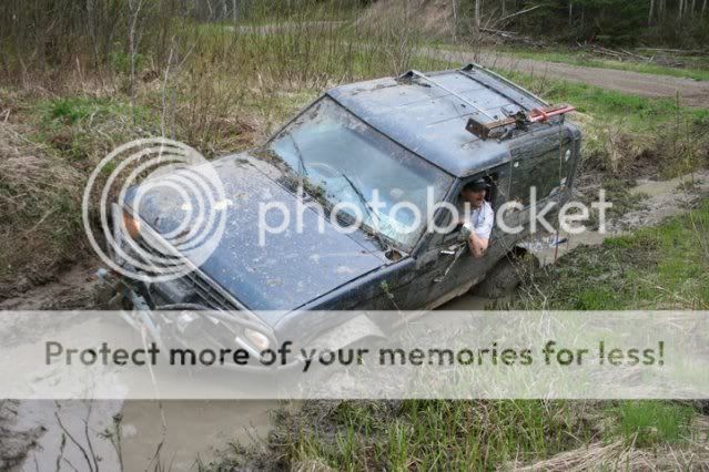

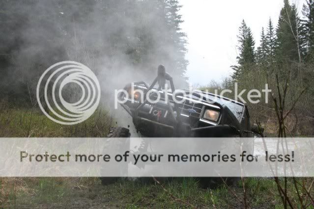

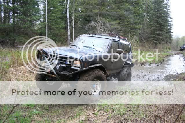

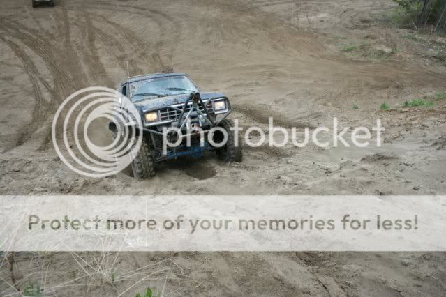

Was the test run after engine swap and some frame and suspension work. Didn't realize at the time that I held it to the rev limiter for so long, haha.

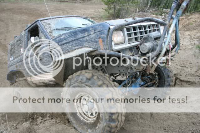

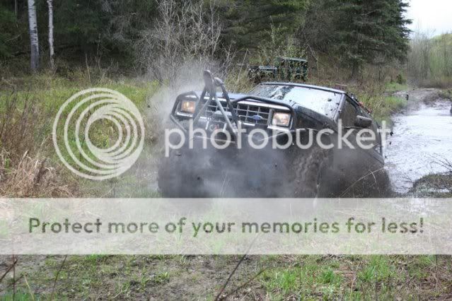

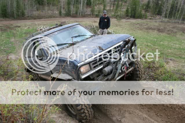

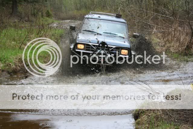

After looking at the pics on PB, I think I just put them on here in reverse order, lol, oh well, I tried, haha.
ENJOY!!

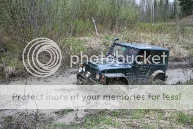

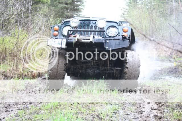

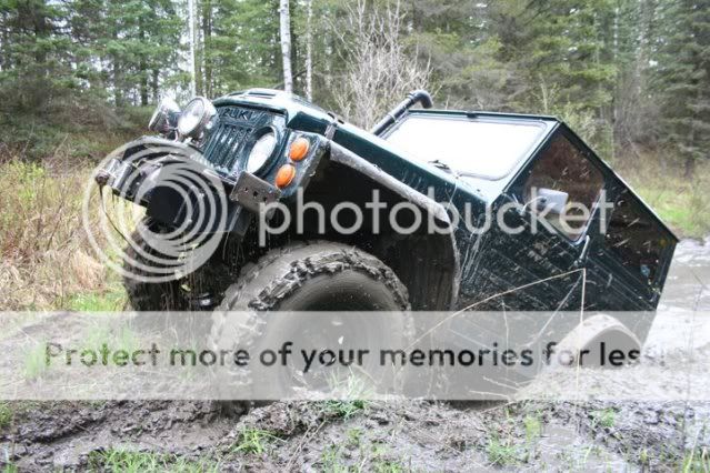

That lj on the boggers is sick! Dad still wants one like tyat bu he wants the two stroke version..
Yeah my buddy Gord owns the LJ on boggers, has the 700ish cc 4 cyl, I think ??, it's the smallest 4cyl they used anyways, his tach goes to 7500rpm and he burries the tach needle for extended periods when attacking mud holes or hill climbs, he figures it's reving 8000-9000rpms, sounds like a 4 stroke motorcycle tached out, lol..... no rev limiter either, lol. It's a neat rig but gutless as hell, he has dual cases and uses only double low on the trail. Those 33 boggers are way too much tire for it. He's ramping up for the VW diesel swap. He's welded rear and open front and manual steering that takes all his might to steer unless he's moving along, then it's just tough. haha. After watching him wheel it I have decided it's waaaay to much work to wheel that thing. lol.
