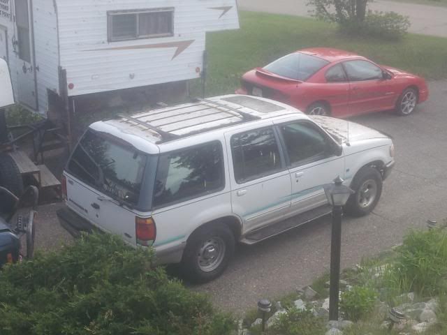

Well I've been a busy bee lately. Bought a rusty 96 v8 exploder to pull the gt40 5L and 4r70w from. Here's a taste of what I'm up to.

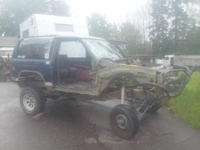

Stripped the BII down in prep for the conversion.

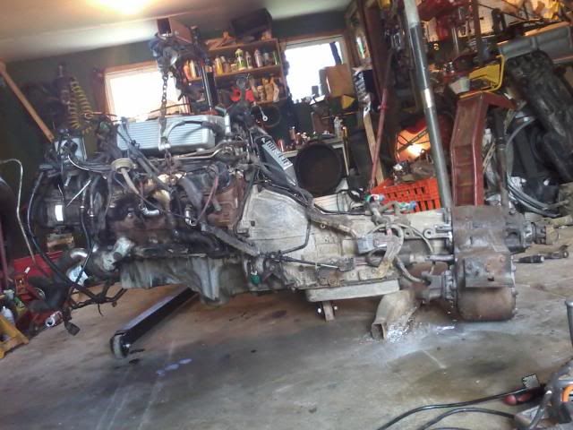

Here's what I got.
