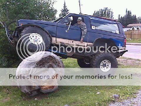

This next weekend every year is always the cleanest the Bronco ever gets all year, haha. Wish I had an RTI ramp to bring to the show and shine so I could show off the flex this thing has!!!
