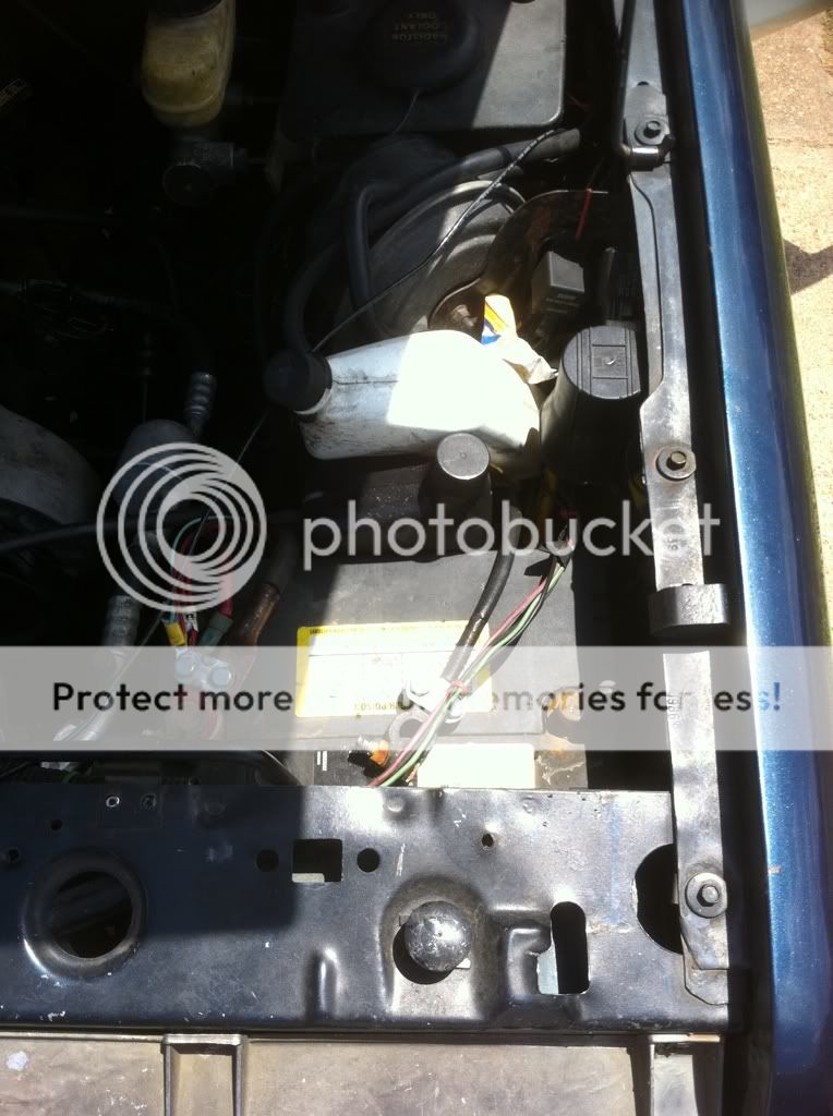

I think I have some pics on my dual battery setup. And at one time I was running a semi battery the the stock spot and a international box truck battery in my second spot. I'm on my phone so give me a second to try to find my photobucket pic of my second battery.
Only pic I have at the moment. Where my battery was bad to! Lol
What I did was relocated my overflow tank to the rear by the firewall. Behind the cruise stuff and made a battery tray to go there. First battery is in stock location.

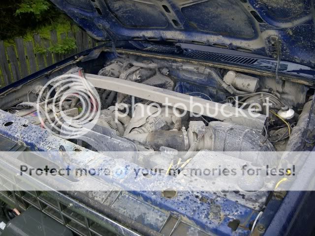

Here's my engine compartment.

As you can see I have relocated my air box and made it into a snorkel that exits the engine bay above the clutch reservoir, right where you put your over flow tank, air box/snorkel, battery, engine cage and washer/coolant over flow take up lots of space.

I really have no room under the hood for another battery without some drastic rearranging.
Say good bye to the washer fluid tank and make a coke bottle as your over flow? Or just make those tanks smaller (re-design) and put the battery where they are now.
Looks like dirt is the only thing holding it all together :D
