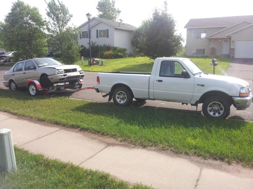

I forget, is this a manual or automatic? 4wd or 2wd?
Also, how well does it tow with the new diesel?
Wow, almost 40mpg, not bad.
2wd, 5spd.

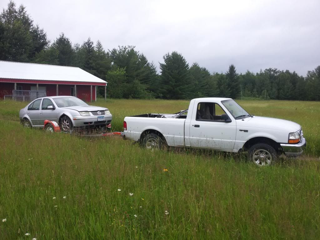

I was surprised how well it towed both Jettas. Didn't push it at all, cornered really well and had sufficient power to keep up with traffic. What I am a little concerned about is if I swap out the 3.73 rearend for the 3.08 that will make taking off a little more difficult. That was my only gripe: 1st was almost a little too tall, especially when starting on a hill. All in all I was very pleased with how well it pulled them and even more impressed with my mileage while doing it! I imagine when I do the 3.08 rearend my highway might go up a little with my towing going down a hair as well. That's not the end of the world though since I'm not planning on towing too often.
