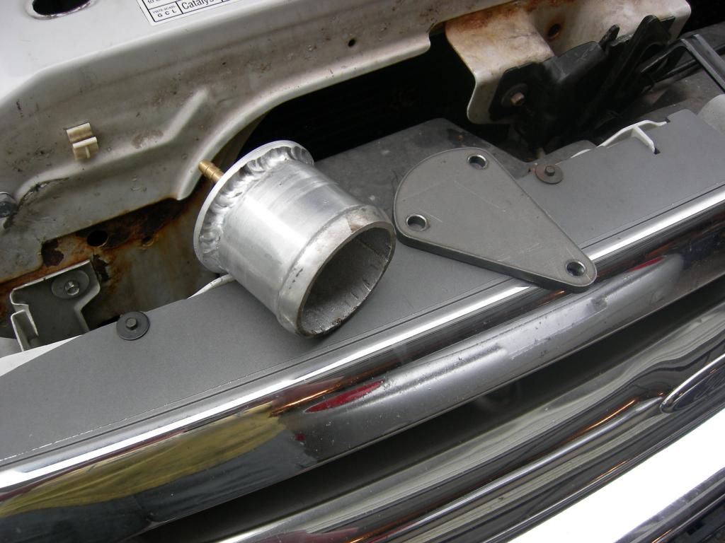

From time to time I was noticing that my boost wasn't behaving nicely. Since I hadn't yet checked for boost leaks I made up a couple adapters to get that done.
TDI Ranger Build
And here they are with my regulator
TDI Ranger Build
In action
TDI Ranger Build

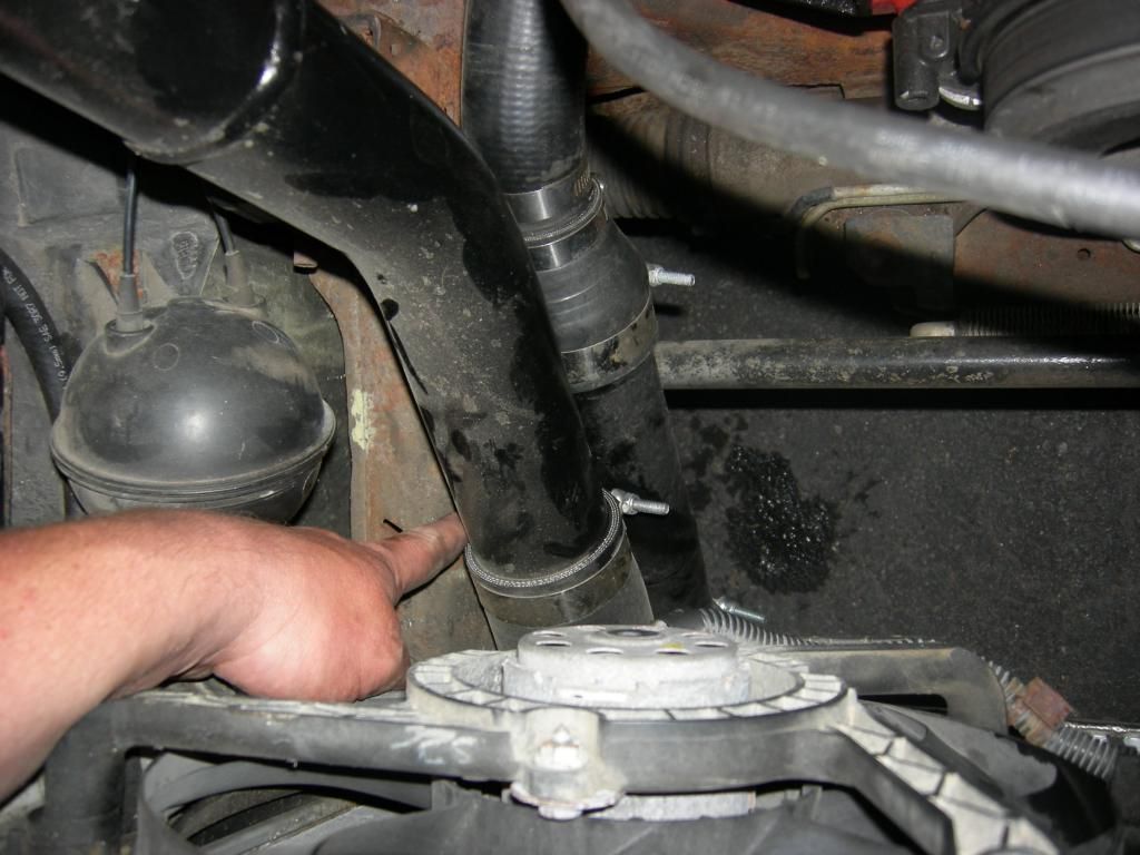

I also hooked up the steel blockoff plate to the turbo outlet to see if I was leaking anywhere on the exhaust side. I wasn't expecting to find anything since I had zero soot traces but I figured it couldn't hurt....well it almost did. When I pumped up the pressure to around 40psi it actually started rolling the engine over and driving the truck UP my driveway. Anyway, no leaks on the exhaust side but I did have a leak on the cold side right here at around 30psi. No I'm not hitting that level of boost now...but hopefully will be sooner rather than later.

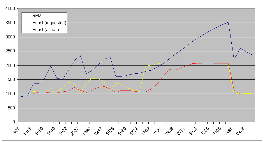

I did also did a couple logs to see what was up.
In my first log you can see two separate 4th gear logs. The first was taken after a long run without using the brakes and shows good boost response. The 2nd was done after sitting at a stop sign (purposely depleating vacuum) and shows slow or laggy response which of course indicates that my actuator isn't seeing full vacuum at low rpms.
