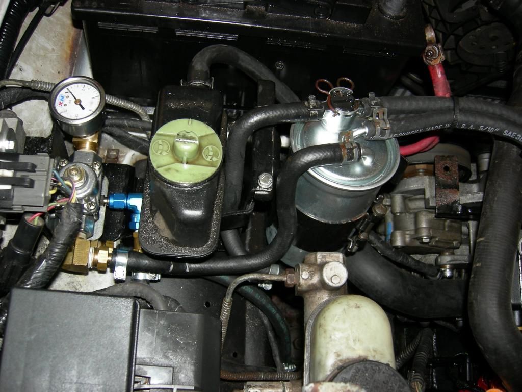

To recap: there are three outlets of my particular fuel pressure regulator as well as a pressure gauge (listed in order from top to bottom as viewed in the next picture)
1) Outlet (to fuel filter)
2) Pressure bleed (back to tank)
3) Inlet (from tank fuel pump)
Here it is all hooked up to the filter and injection pump. Once everything was connected I set the pressure to ~4psi with the engine at idle.
A note on this regulator. If I were to do it again I would buy the Holly 12-803BP and add in the gauge separately. The fitting that Nitrous Express added had a severe leak the second I put fuel pressure to it. It took four different tries but I finally got it to stop. :annoyed:

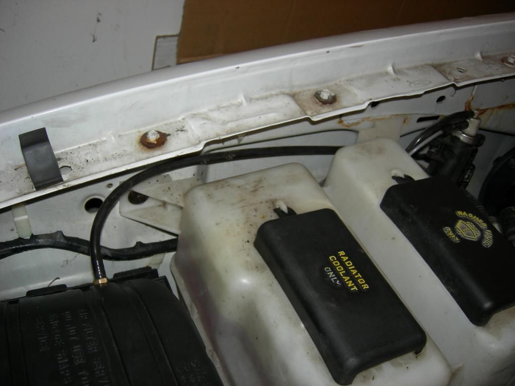

The vacuum pump on the TDI is driven by the cam on the backside of the head. I reused the short hose section as well as the check valve to connect to the vacuum pump. From here I looped a length of high-pressure fuel line to a brake line which runs over to my brake booster.
My supply line (green) runs down to a T where it splits off to the N75 and then continues on down to the Ranger's factory vacuum canister. The second line coming off the canister of course goes to the dash for HVAC, etc.

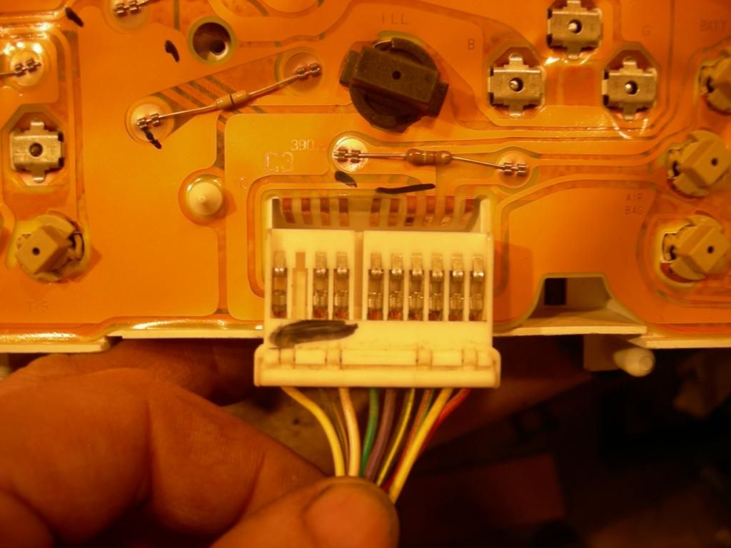

This is a very simple circuit. The ECU sends a ground signal to illuminate the bulb via T80/41 (blue/green) and the bulb has constant 12v provided to it. Luckily the Ranger's cluster is set up with the same functionality so all I had to do was figure out on the back of the cluster cicuitry which pin needed to be added to which connector.
As you can see there are 3 connectors on the back of the cluster: C1, C2, C3. With my multimeter set to continuity check I probed every pin with both sides of the "Check Susp" light to find the missing pin. Voila. Found it: 2nd pin from the left of C3 (bottom middle connector).
Now all I need to do is go to the junkyard to snag a cluster plug and steal a pin from it to insert into my C3 plug.

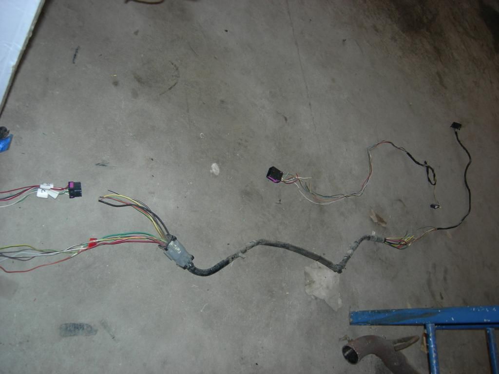

Herr VW harness, I introduce you to Mr Ranger harness. I clipped this portion off of the original 2.5L engine harness so I can have only weather tight connectors in the engine bay - the colored connectors will be clipped and all the wires mated to the matching Ford wires with adhesive-lined butt connectors.
Well I'm a little behind on posts. Here is the detail about my main harness wiring where I tied the Ranger engine connector to the VW ECU harness.

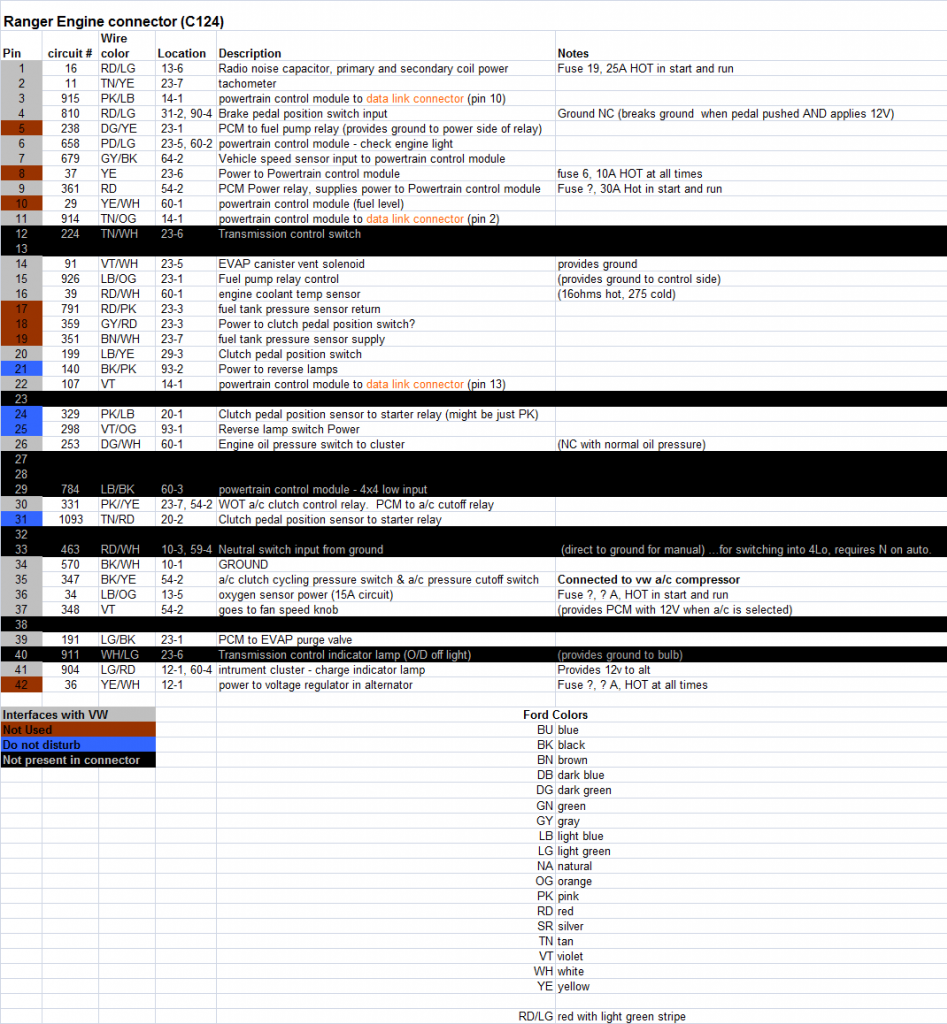

The first order of business is to go through the wiring harness diagrams for both vehicles to know all pin assignments but also what each wire does. The latter task of course is the harder one but ensures you don't create any magic smoke the first time to turn the key. Figuring out what each circuit does is a whole lot easier when you have a complete harness or your swap recepient vehicle still together.
Anyway, here are my notes for the Ranger engine harness connector (C124) which I pulled from the 2000 Ranger wiring diagram - it doesn't show different pinouts for the various engines so I assume all engines have the same C124 pin assignments.
And here are the pins for the 2000 Beetle colored connectors as well as the 14 pin connector (right next to the ecu). The right-most column shows the Ford C124 pin to which I connect the vw wires. In this same column I also make note where I have connected wires directly to the engine hardness (EH) or the Ranger transmission connector (TC). Two wires that should make note of: 1) the a/c compressor 12v signal wire going from the fan control module runs through the C124 (pin 35) 2) the cruise control stalk requires 12v that didn't go through the colored connectors so it isn't in my list of pins. I ran this extra wire through the transmission connector and tied it into the main power circuit (ro/li).
