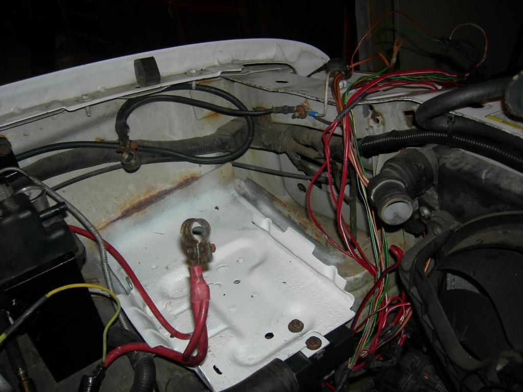

I really had trouble figuring out a good spot for my glow plug relay. I had considered installing the engine glow plug relay into the coolant glow plug relay housing but I really couldn't find a good spot for that large housing. I decided to mount it right near the battery junction box...where I'll be adding a 50A circuit to run the relay.
Here is the relay itself removed from the interior portion of the harness:
Wiring for this little guy:
BIG red wire > constant 12V 50A circuit
2 red/white > glow plugs
blue/yellow > switched 12V circuit
violet/white > ECU
green/white > ECU
Brown/red? > ground
All of these circuits are available in this trunk of the Ranger harness (just about every circuit runs through this part of the harness ) OR they need to be added...mainly the first one. More on this one.

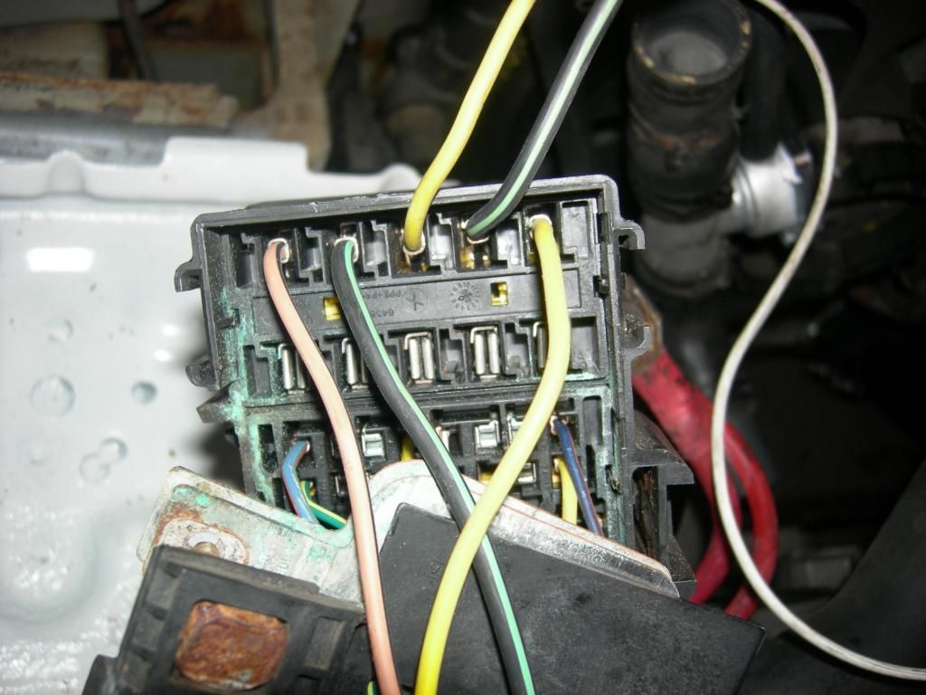

Because my Ranger doesn't have ABS (and some other circuit) I have a few empty fuse slots:
First I had to run to the bone yard to pick myself up a battery junction box so I can steal the wires/connectors and install them into my junction box:
Here is the back of the junction box after some disassembly:
And here are the two empty slots:

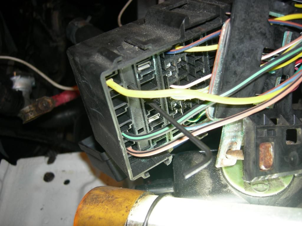

More disassembly:
And here are the two added circuits:
Back to the glow plug relay. Now that I have the 50A power circuit I can connect it to the relay paying attention to length of wires and where I want my relay to end up. I stole 2 circuits from the EVAP purge valve in the engine bay to provide the switched power as well as one of the ECU circuits. The 2nd ECU circuit I simply tapped into in the harness, same story for the ground.
