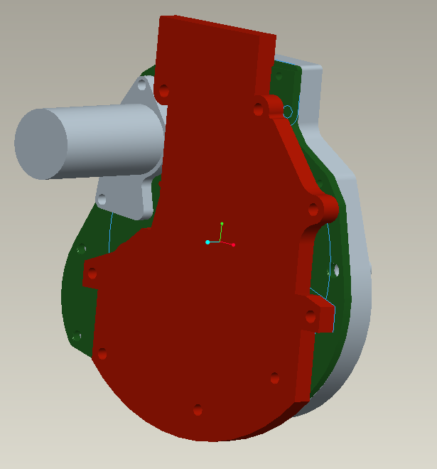

It's been a long time coming but I finally have something to show for the last year of research, design, prototyping, etc.

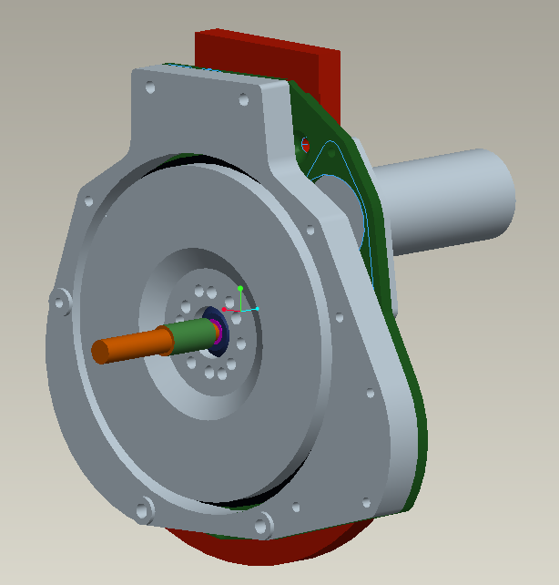

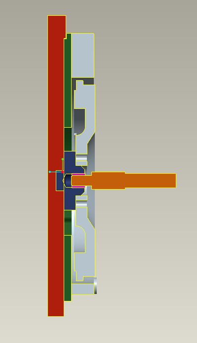

The basic process started with several gutted and cleaned transmissions which were brought in and measured with a CMM. Repeat the process with VW flywheels, Ford flywheels, starters...you name it and get to modeling:
At this point I had a prototype or two lasered out of 14gauge sheetmetal to see how things were shaping up. I'm glad I took this intermediate step as I would have wasted two plates with simple but important revisions.

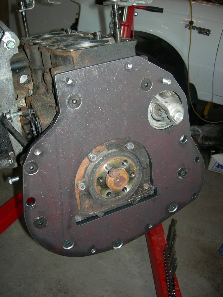

I decided I was far enough along that I wanted to cut up a plate on my third rev. I held my breath when I slipped it on the first time and she fit like a glove.

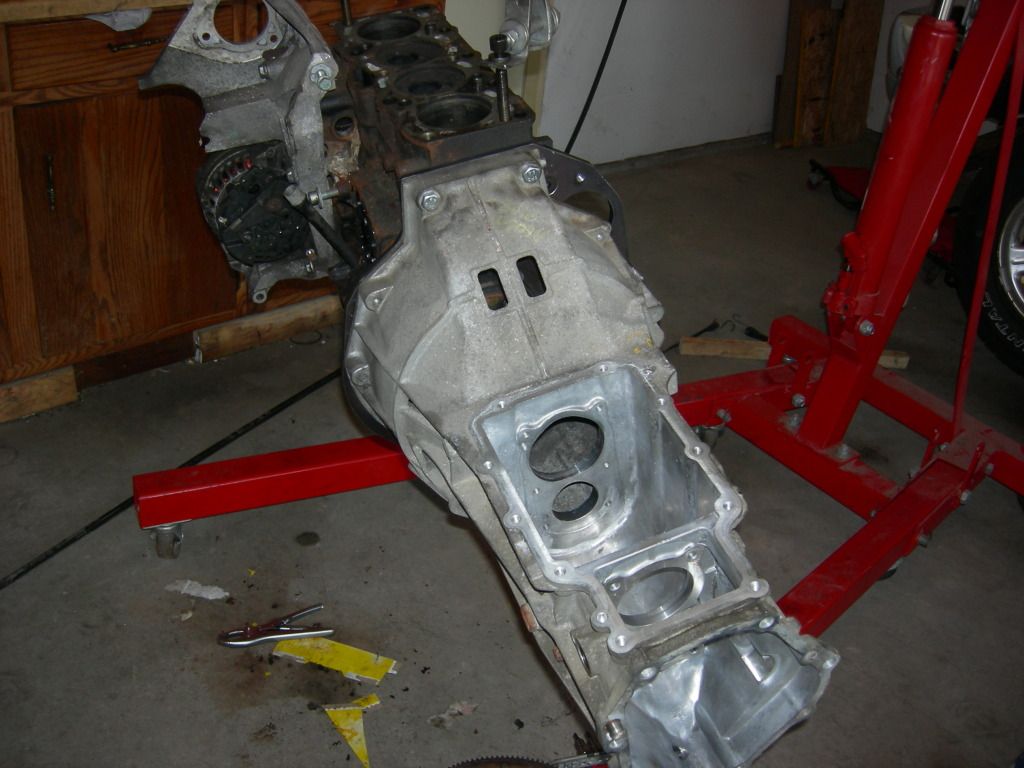

Slip on the transmission for good measure:
And away we go. The hard part is done. :icon_bounceblue:

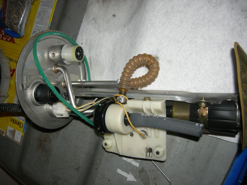

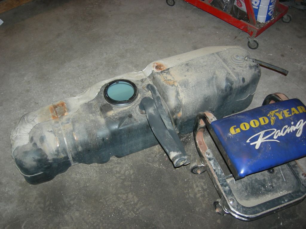

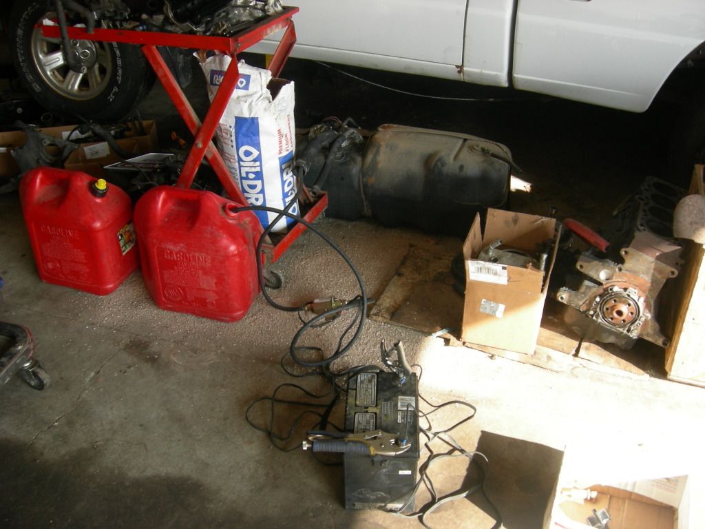

The Ranger of course was fuel injected which meant it's in-tank fuel pump was putting out around ~60psi of fuel pressure which is way more than the 4-7 psi I need for the tdi. So I need to drop the tank to get at the fuel pressure regulator which is also mounted to the sending unit which is convenient since I also need to drain 1/2 of tank of 6 yo gasoline.
Out comes the tank, my fuel pump used to de-fuel mis-fueled tdi's and my spare battery:

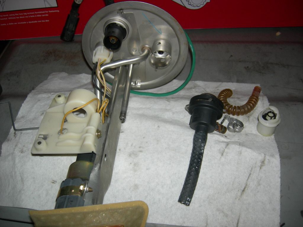

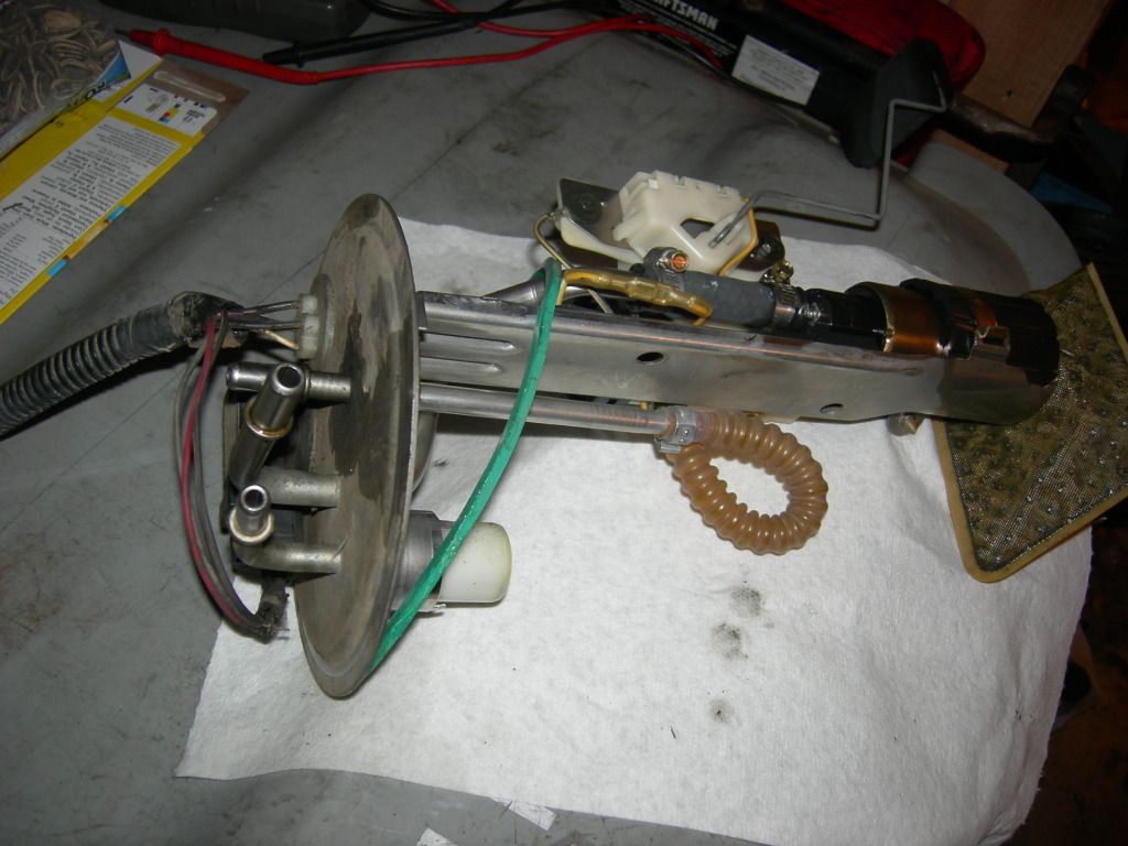

Out comes the sending unit so I can get every last bit of gas out:
And here's the sending unit:
In the above pictures you can see the fuel pump, fuel pressure regulator and some sort of EVAP check valve. I'm going to remove the last two and reuse the connectors on the sending unit for return lines (more on that in Part 2).

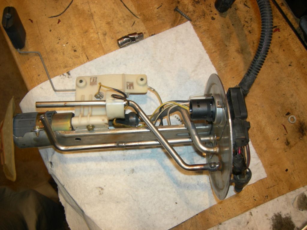

I wasn't too crazy about the return lines the way they were on the top of the sending unit - I figured they would aerate the fuel when the fuel level was below 3/4 tank. To remedy this I went to the bone yard and picked up a sending unit from a diesel superduty for the stainless lines. Don't laugh, this was my first attempt at TIG welding stainless.
It appears there is the normal stock pickup tube with the sock, but then there are two other lines in addition to it. What are they both for? One has to be a return line. But what is the other one's purpose? I'm trying to figure out for my own TDi ranger build.
Thanks
